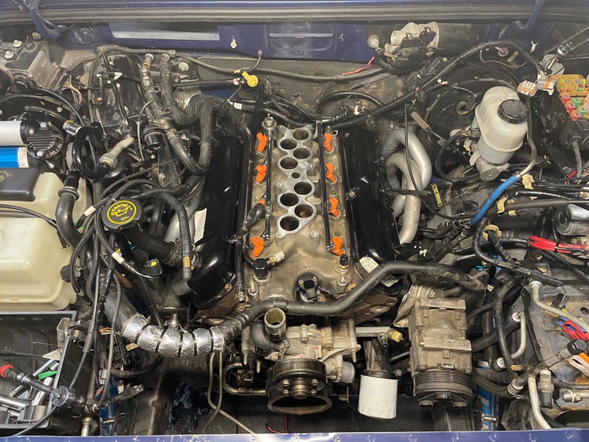

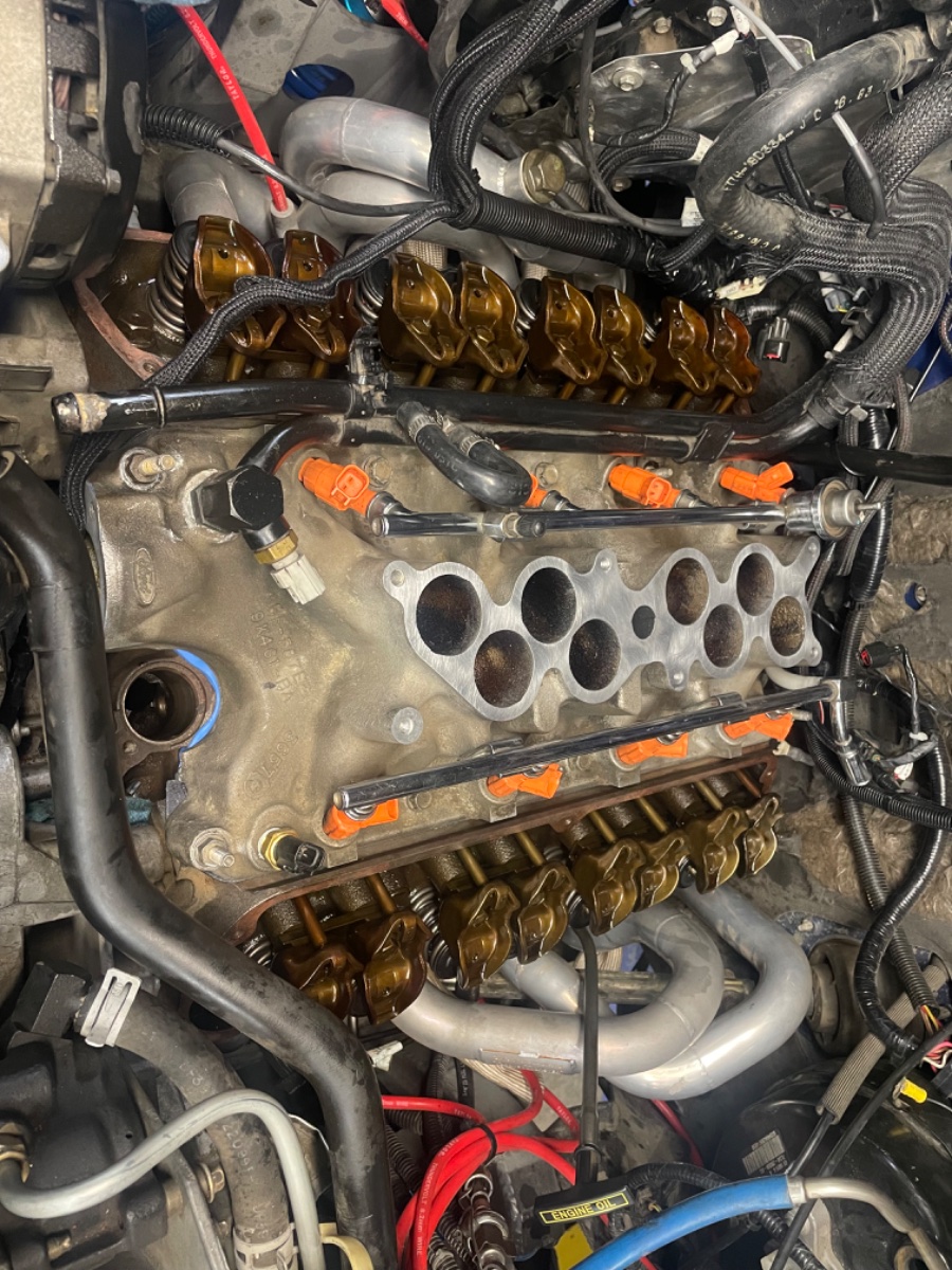

Anyways lower intake is on I’m working on the rocker covers and intake this am

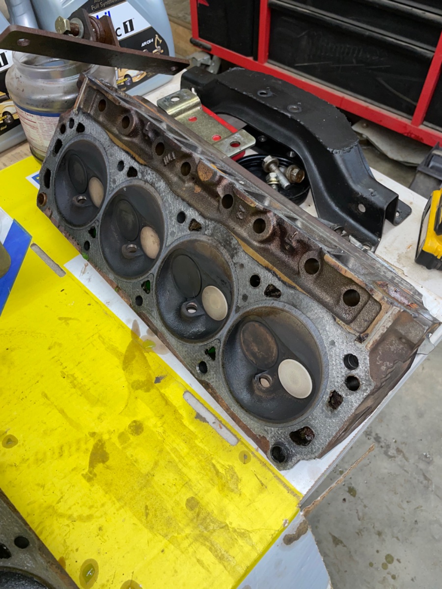

never something you want to see on a fresh build. did the motor lean out?

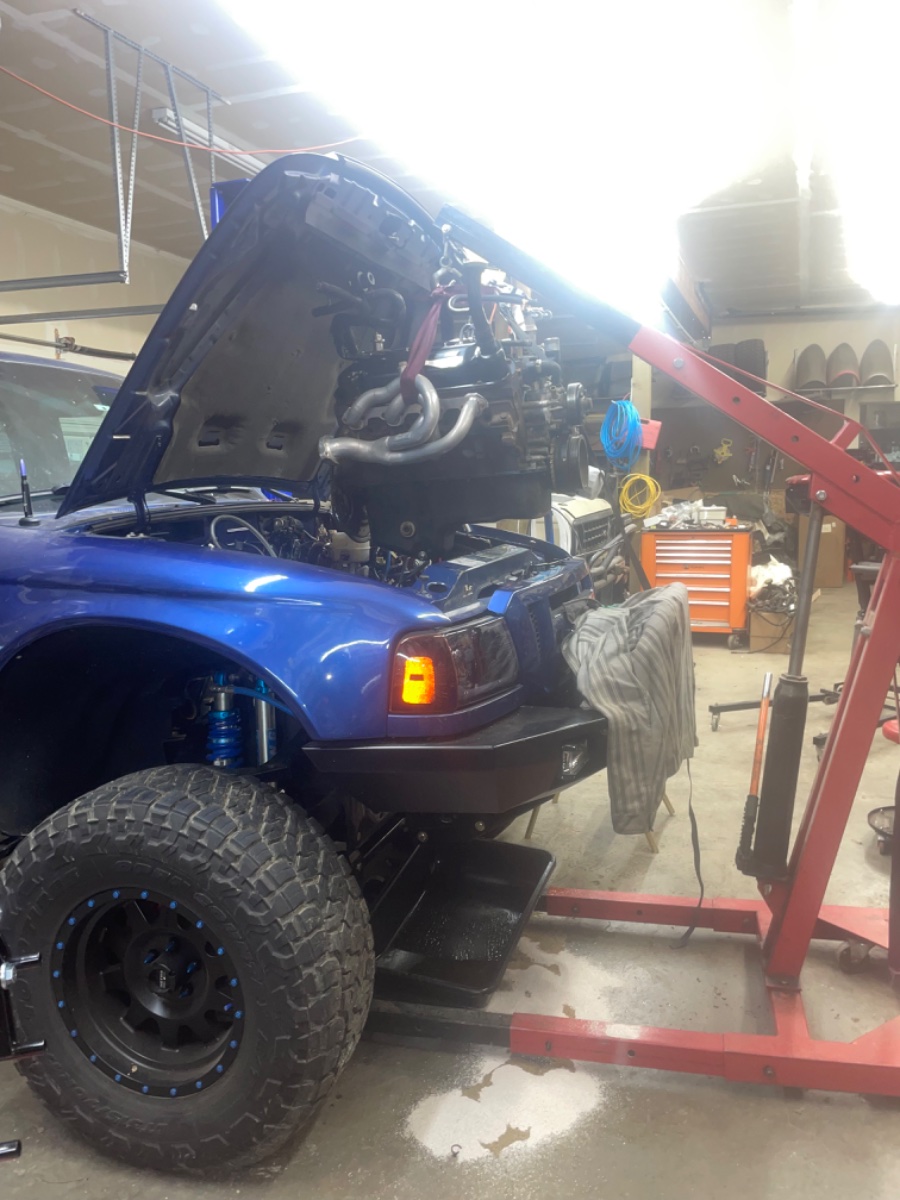

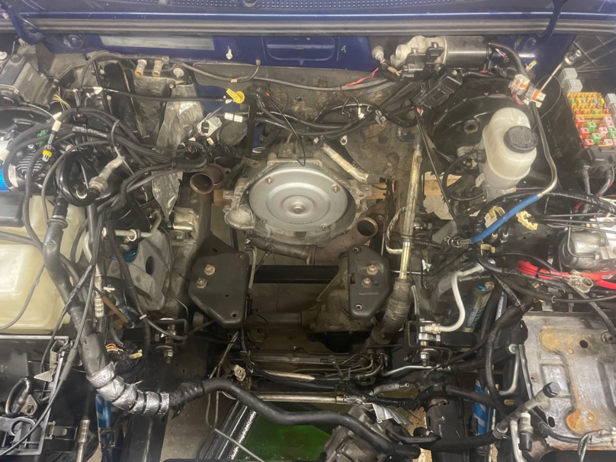

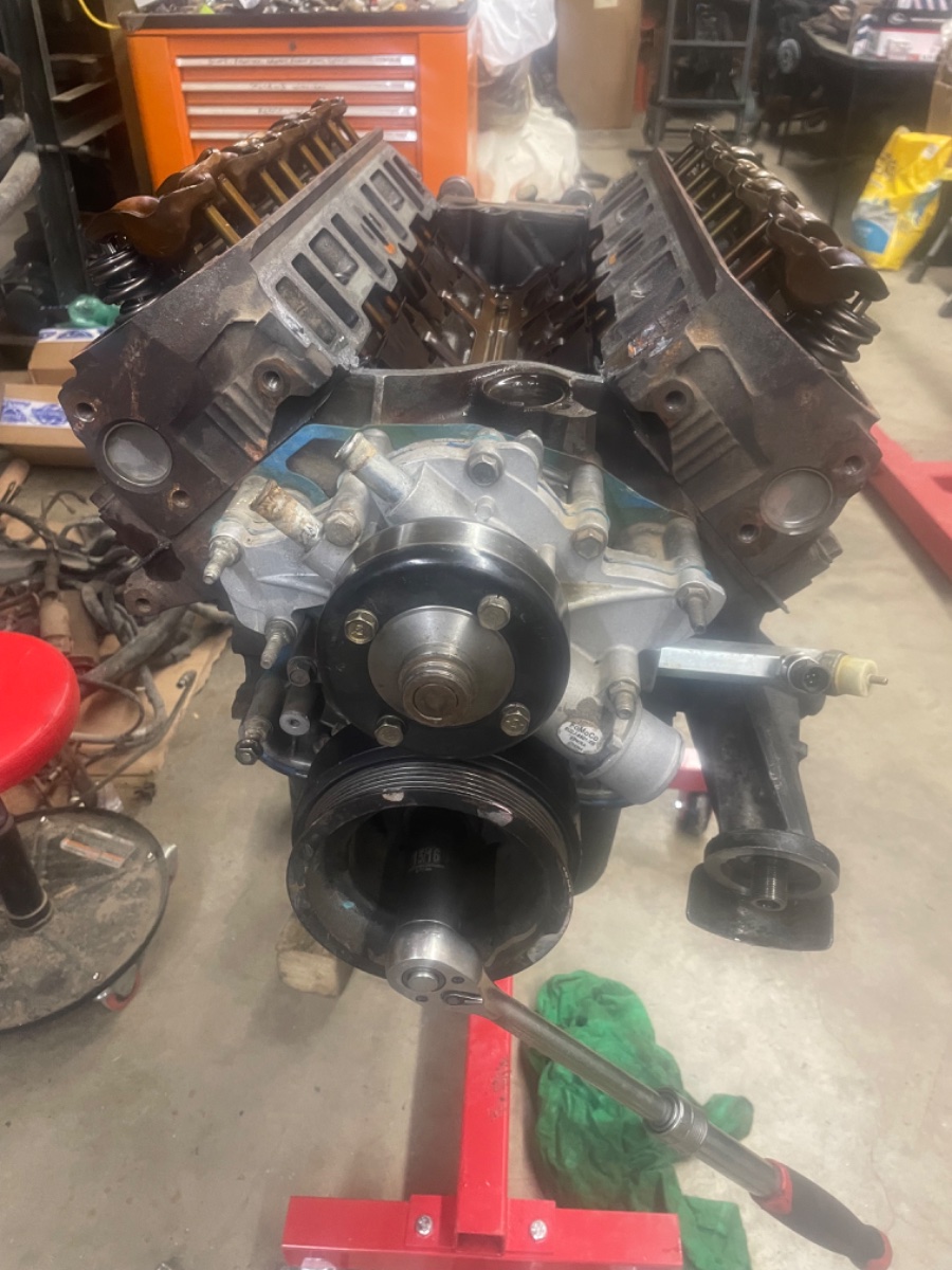

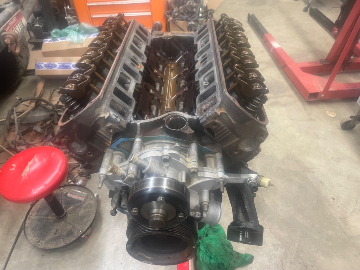

Engine is out

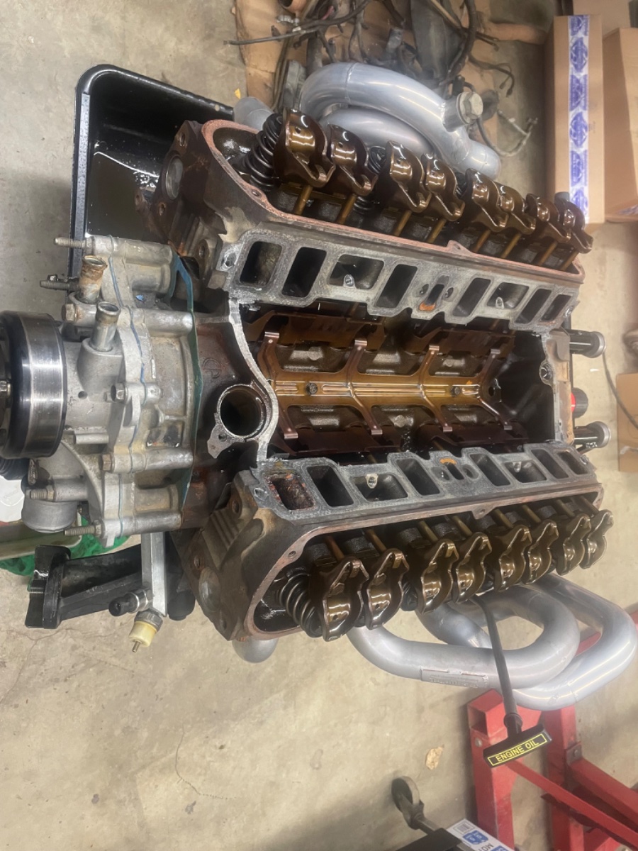

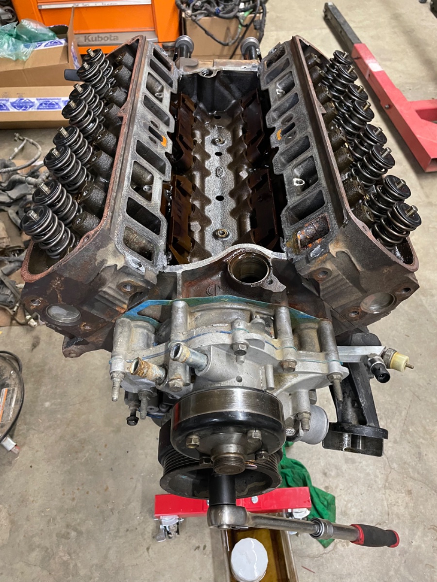

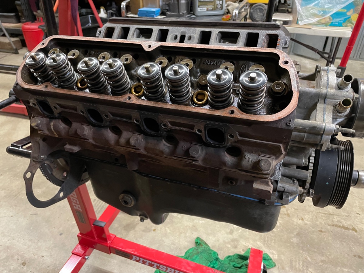

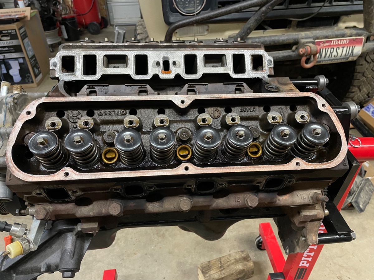

Heads are off
Not clear exactly what happened yet

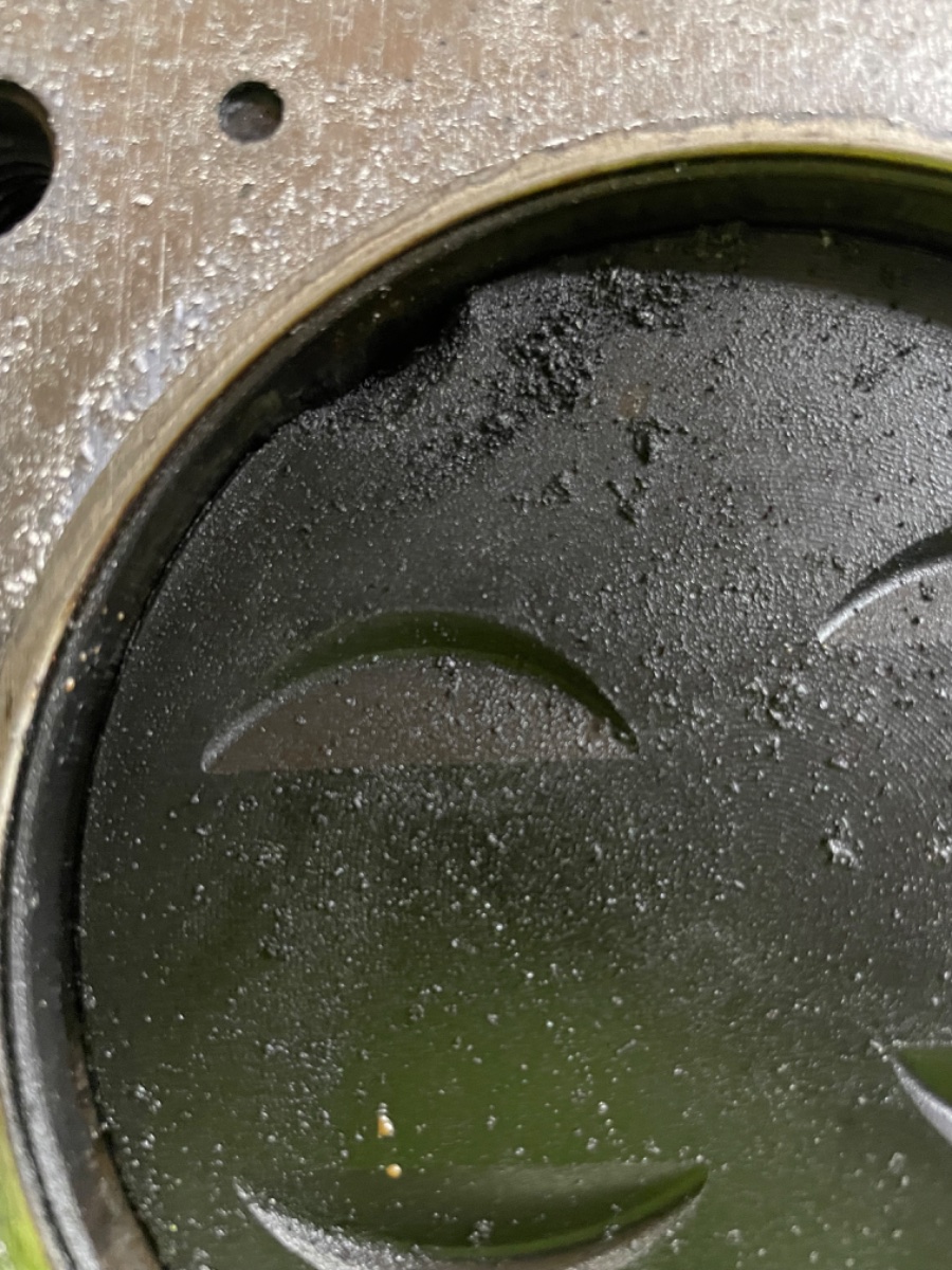

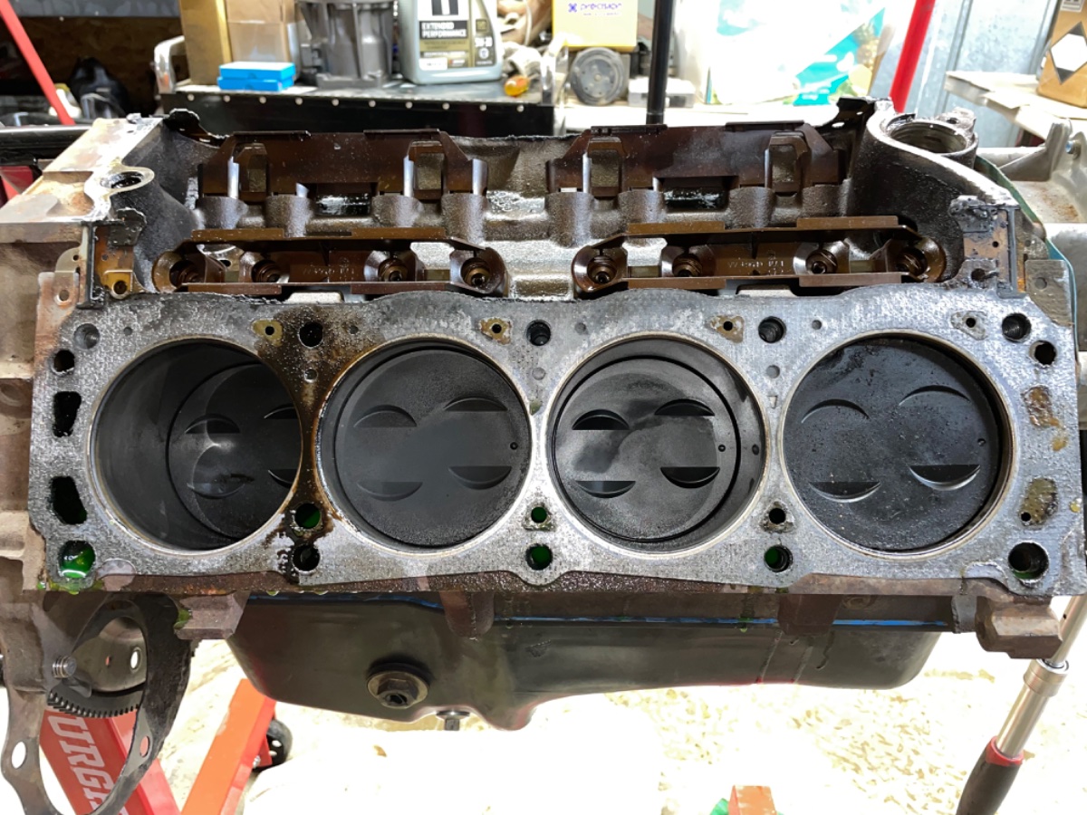

Cyl 1 major Issues
New engine will be prepped assembled and installed asap
Cyl 1 78psi

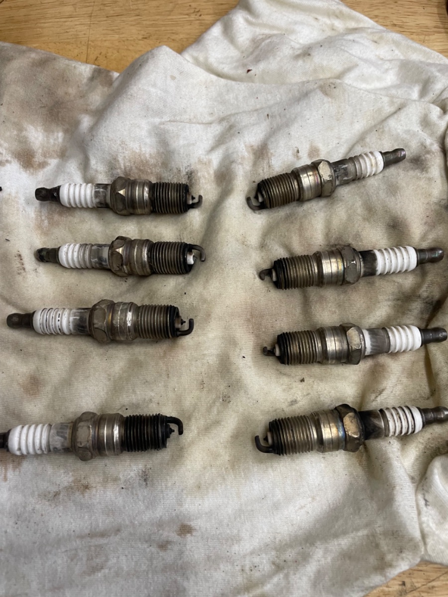

Plugs

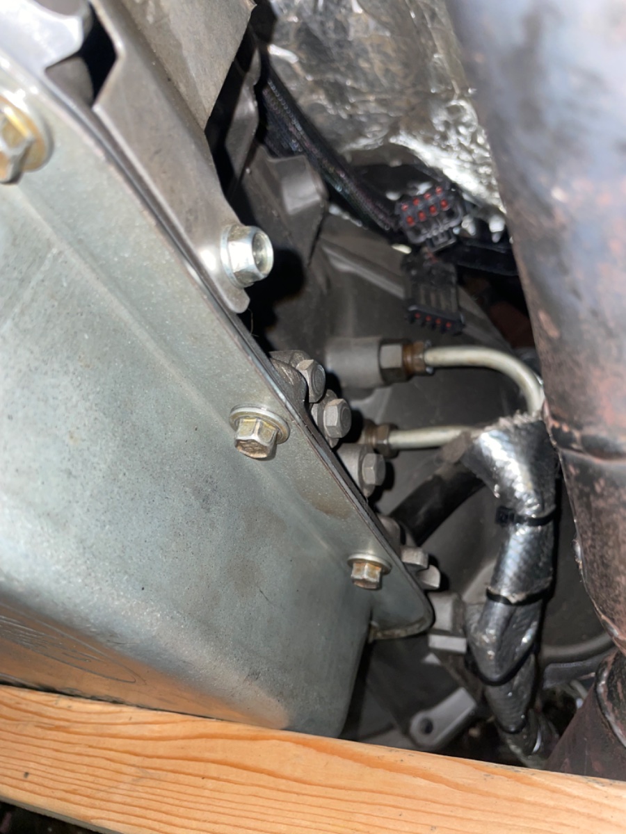

Ac compressor and line remain in place, engine comes out around them
Starter, converter access cover, header

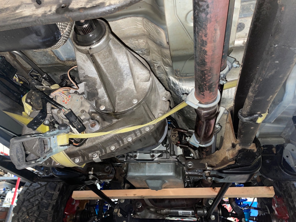

Bolts removed. 15/16 socket used to bar engine over and all 4ea 14mm converter nuts are removed

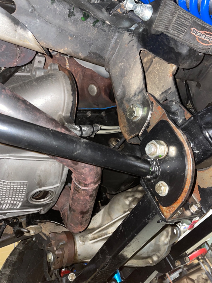

Trans crossmember removed, trans mount, exhaust mount
With t case lowered all bellhousing
Bolts are easily accessed as well as trans dipstick hold Down bolt
Ratchet strap under t case holds it up and a piece of timber across the torsion bar suspension supports keep the trans from hitting the ground

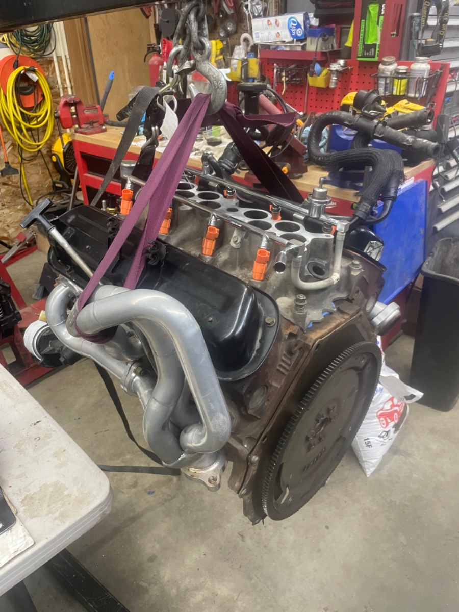

Engine is removed with headers in place
Engine mount plates left in engine bay, with suspension lift it is easy to access the plate
To block studs
I love my hoist, $90 at checker auto back in Colorado 20 years ago… sucker has pulled so many engines. Has enough height to clear even on this ranger

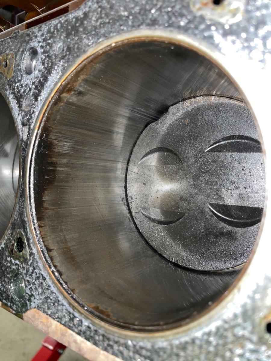

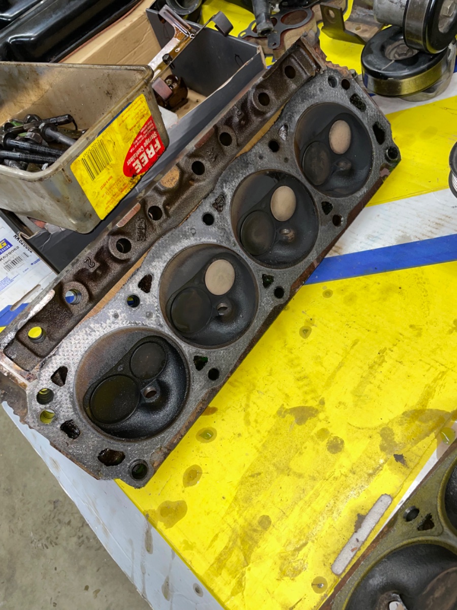

Ring issue cyl 1?
Best guess at this point
I've bought core engines off Craigslist that looked like that and the cause of death was running lean.
Yeah, 1 and 8 are both hurt
Agree with above.
Would like to see the spark plugs that hurt motor. Those look to be changed.
Edit
That engine went lean, tried to turn backwards real fast due to preignition, wiped weakest drivetrain component
Scanning pics from here, I see a slight nick in the cyl 1 head, in the squish area, corresponding to the area of broken piston.
I'm betting the pre ignition burned off the spark plug electrode, it landed on top of piston, then piston came up and smashed it against the head, something had to give.

Those are the plugs from this hurt wngine they have 2000 miles on them

No electrodes missing from
Plugs

I have lots of very very good engine dudes looking at these pics with me, first thing everyone says is “lean”
Overheat, post 668
1 is hurt cyl 8 looks fine bank 2 had even and decent compression
Unless you see something I do not
Boat anchor now
I’m going to check the cam dimensions see if it survived
I’m hoping to re use cam and springs

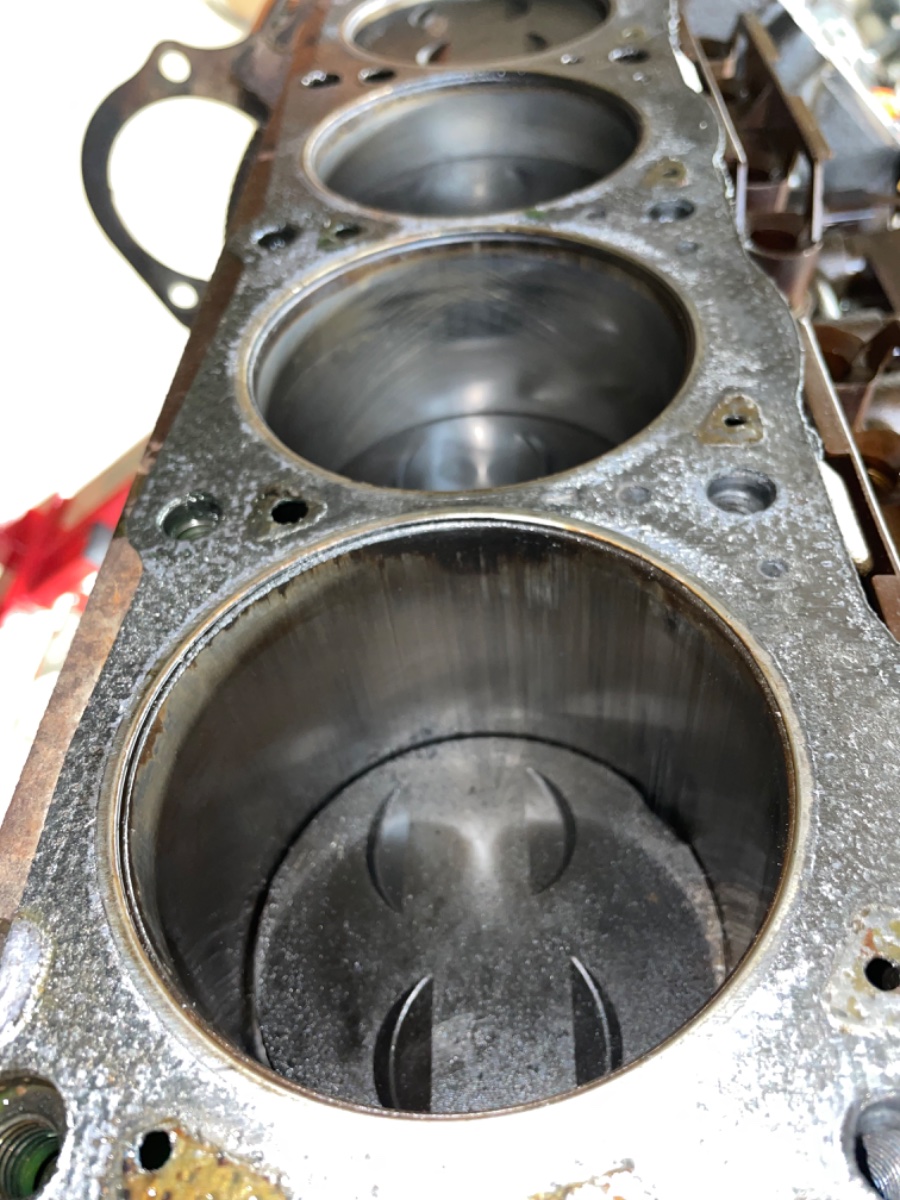

Can you pull the piston out of the 1st hole? I'd like to see what the rings look like and if the skirt was rubbing. The scuff marks in the pictures of the cylinder wall appear aluminum color on my phone.
Absolutely
I plan to dismantle the heads and bottom end today
I need to get this thing running and out of here before it gets snowed in
The bore is not smooth anymore I can feel depressions in the bore, it feels “wobbly”
I can see scuff marks on the side of the piston as it passes by the spark plug hole
This engine had raw fuel in the crank case for a while, if you guys remember I had a stuck injector dumping fuel and there was quite a bit of cranking before the Holley actually ever fired the engine
Many things may have lead to the demise of this block
