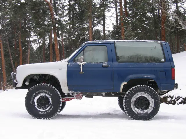

Side shot with spacers installed (much better):
(Yes rust & paint repair is coming, just not as important as some other mods)
