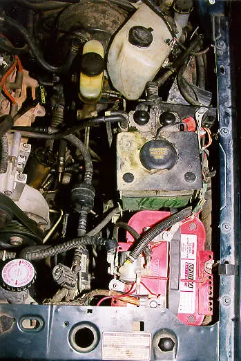

Here's what I did for my dual battery mount:
I cut the coolant tank apart and used a different windshield washer reservoir.
I haven't heard of anyone modifying their Explorer's A/C compressor for use as an air pump.
That seems like a great place for the battery, thanks, I think i would move the coolant reservoir as well so the battery can be reached more easily from underneath the radiator frame

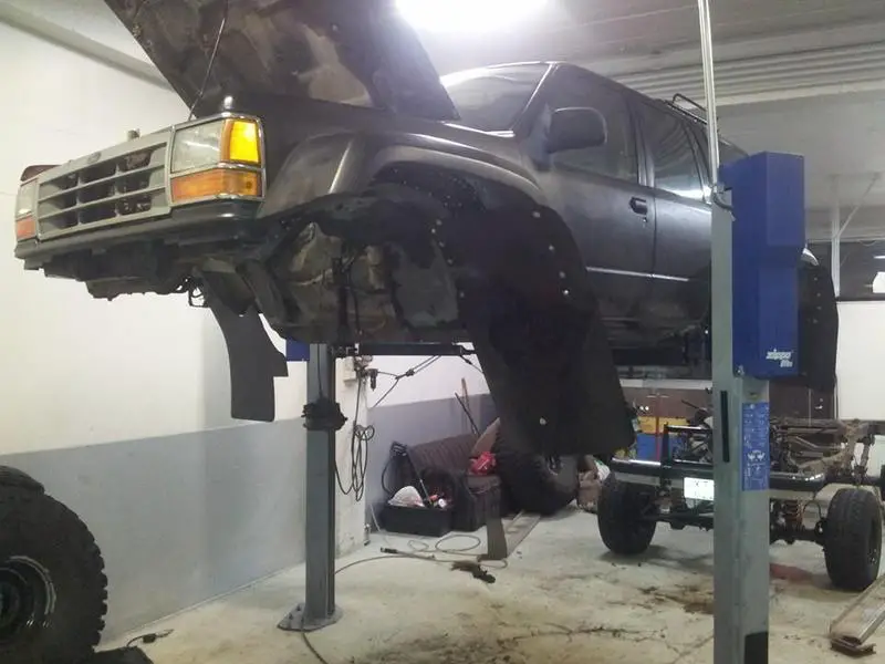

Woke up with a splendid idea, and this is the days' progress, i was bored of working upwards in tight and stupid positions with a welder and angle grinder so i did this to speed the process and increase build quality
this will also make short work of replacing the clutch kit
and paint the frame and body floor
All the space in the world to replace clutch and build link mounts on the frame
Frame is as new, just needs wire wheeling and painting
same can be said about the condition of the body floor, ive only found one rusty hole, below the rear right tail light in the corner of the wheelwell, but its easy to get to once the frame has been removed so i can fix it quickly

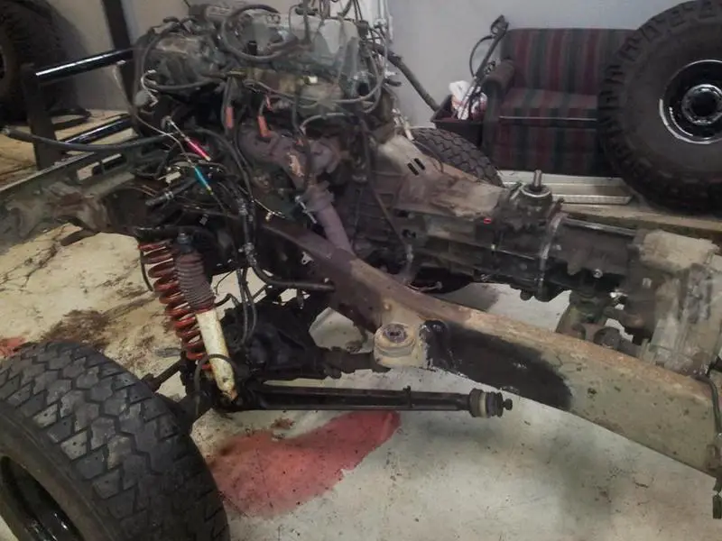

Took out the transmission to make more room for full welding of the front radius arm mounts
Meanwhile my girlfriend was wirewheeling and painting the floorpan and rocker panels with light gray rust sealant
and next verse is to build 5 link rear suspension
Sunday
EEEK, I wouldnt want to have to budge that rotten old head bolt :D
Einmitt það sem ég hugsaði, og þetta hefði maður sko ekki upplifað i súkkunni! :)
Arm mounts fully welded
Floor pan and wheelwells looking healthier
New clutch kit and slave cylinder, gearbox painted white for better brightness underneath the car if something were to go wrong in bad situations
Another one of the radius arm mounts, pretty massive looking
