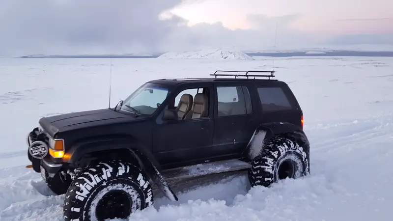

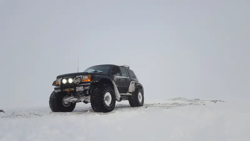

Well I made it, yearly trip to camp Landmannalaugar 2016 as I had planned, everything went according to plan, or nearly... :)

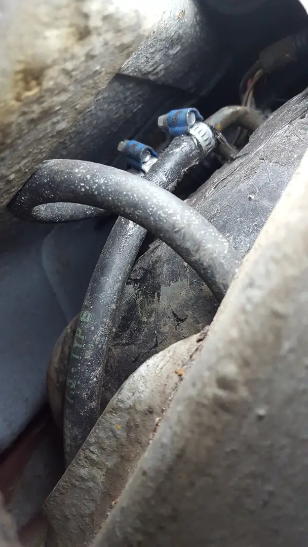

The reason for the engine troubles in the test trip were easily found, when I had removed the fuel tank to repair the fuel leak, I had cramped the fuel line between the tank and the frame rail when I tighteneed the tank up again... doh! For that reason the car ran fine for about 2 days when it bit a hole through the fuel line so air could get in, this resulted in poor running and very hard starting...
This was fixed as soon as I found the reason!

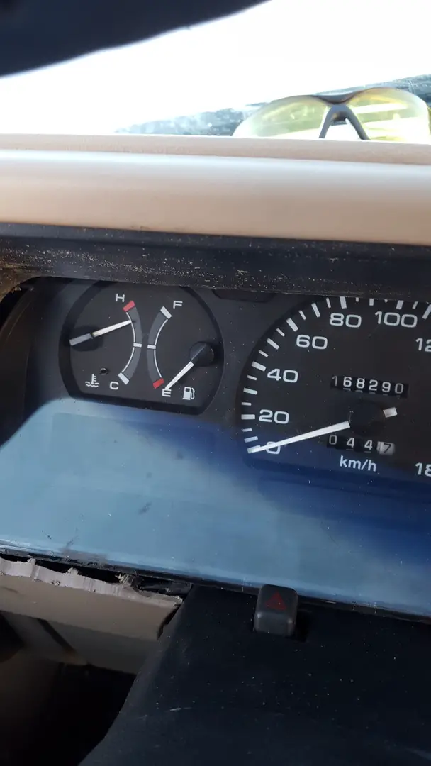

The reason the engine was overheating is naturally both that there is no fan shroud, and that even with the engine at nearly boiling temperature the silicone clutch on the fan doesn't work, my temporary solution was using three electric fans filling up the element area of the radiator, this almost fixed the problem completely, the engine still heats a little under full load moving slowly, so I have to check this some more...!

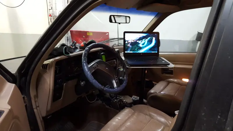

I bought a cheap laptop, 20.000 icelandic, around 150 usd, it's got an SSD hard drive, so it can handle the vibration of being in a car, I will be using this laptop to connect with my GPS and drive by it if weather conditions are such that you can only see your windshield wipers...!
the plexi glass table is welded on a piece of exhaust pipe material which I slide into another piece of pipe welded to the center console, then I have a wingnut which I tighten through the outer pipe, so I can adjust the height and direction of the computer to my, and the passengers' liking...

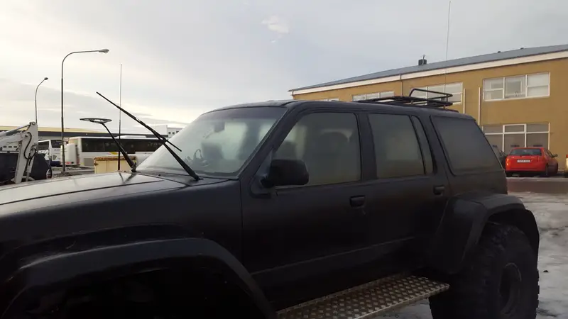

I put some side steps on the car, the height of the door opening is around my waist height, and I'm 6'2", so this was a necessity, this will also help keep the car clean... maybe I will put some side lights on them later... who knows.

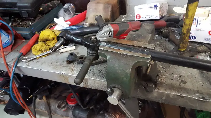

The afternoon before takeoff I decided to shake the car on an inspection pit where I found 2 broken tie rod ends, so I just replaced all of them to be sure,
after this it was time to fuel up and leave for the trip!

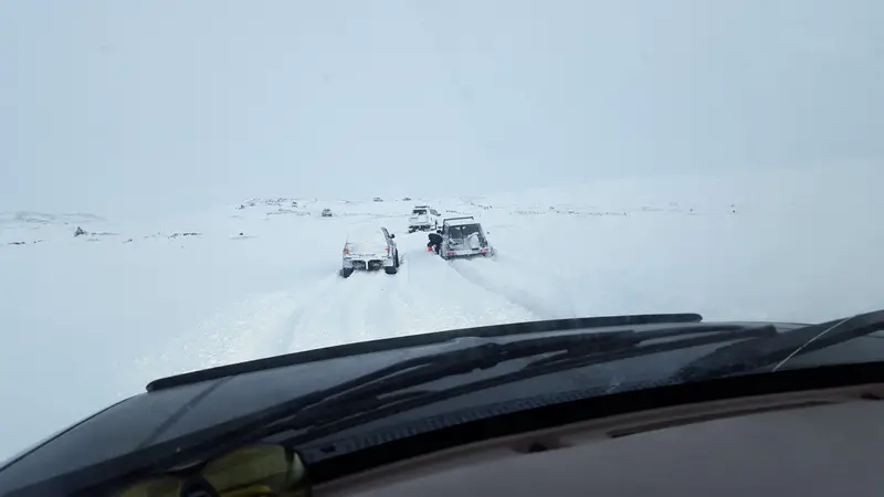

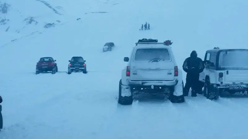

Friday 8th of january me ad my friends went on a trip..
The first group, my Explússó, Suzuki Fox 38" with toyota pickup diesel drivetrain, 44" disel hilux doublextracab, two 38" hilux og patról y60 á 38"

On saturday we woke early and went back to greet the rest of our friends who were coming to meet us, traveling through the "VALLEY OF DOOM" as the Top Gear USA presenters call our "Dómadalur" valley, you can probably find this episode, i think it's called VIKING OFFROADING or something, season 3 episode 16
http://www.streetfire.net/video/top-gear-america-03x16-viking-trucks-ptbrtgbr_part-1_2423803.htm

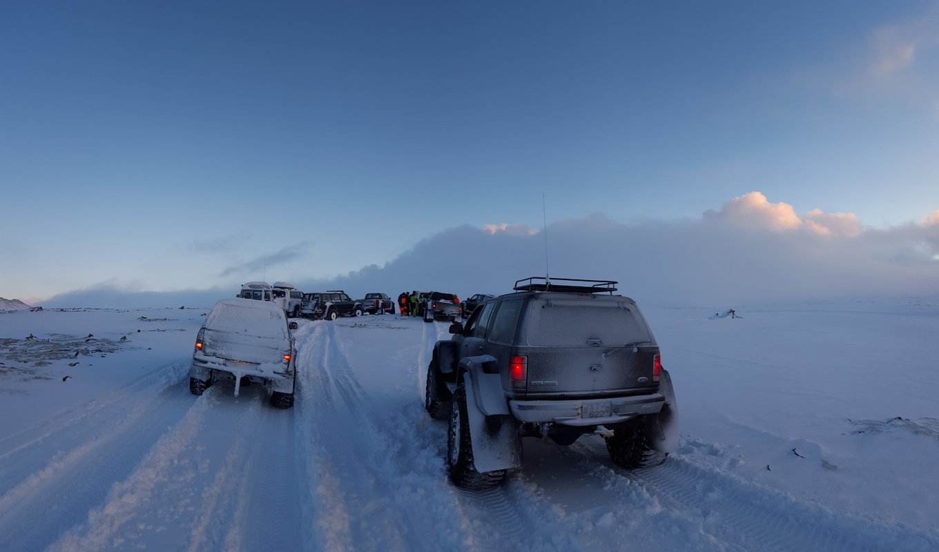

Thats where we met 15 other of our friends in the Valley of DOOM
Most of the cars in one photo, not all of them...
The largest tyres, and then the smallest, and the funny thing is that the average driving speed was not much different between us two...!
Parking spaces almost running out... it's like a tourist week in july summer

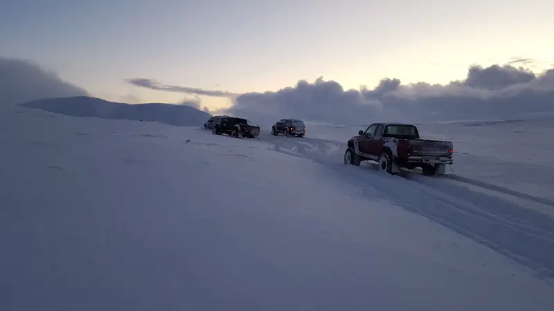

Later on saturday, the weather was still and -12 degrees

On our drive home the sunset was mind boggling... you really had to pay attention to the road but this sight was so amazing that you just wanted to stop and stare
The red line is friday, the dotted line is saturday, and the yellow line is sunday

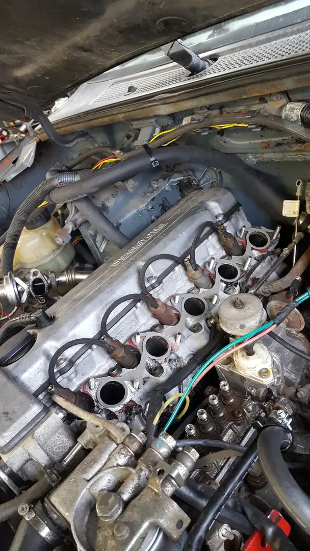

The other day I removed the intake manifold to inspect and do some fuel tuning, i noticed the bolts that hold the manifold are most stripped or loose and the threads ruined, so I came back with a tap and cleaned the threads, installed steads instead of the bolts and fasten it down with a new gasket and nuts to secure it properly...

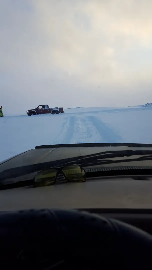

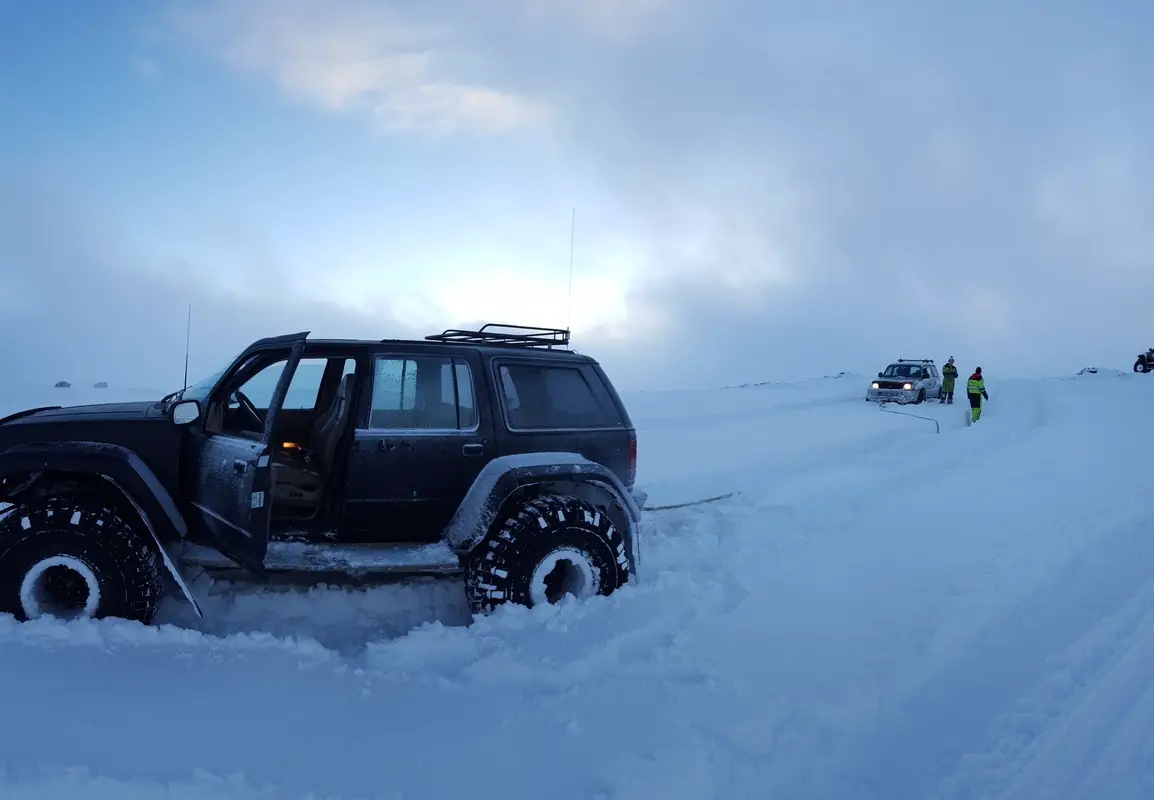

Me and father were racing a little if you will, when suddenly I saw the earth swallow his truck, and a milisecond later I let off the fuel pedal and down I went too with such force that the fender flare flew off, the water splashed all over the car and surrounding area, I knew I was properly stuck but I was very glad it wasnt much deeper, the water level where I was deepest was around the lower sill and sidestep... probably 4 feet...
My girlfriend screamed at me and said the front wheel had broke off my truck, she could see it out the window... I quickly realized this was only because the fender flare had come off, lol, I was pretty relieved when I figured that...
3 cars of 4 total stuck in the slush...
Removed the flare completely to retard further damage to it... and tried moving the car back and forth,, I was able to move it back and forth maybe 2 car lenghts, but the slush ice was so thick and heavy under the car that I couldnt pick up any speed to hit the ice bank to crawl up,
This is where I sat and sang my song, "Crapstuck blues"
This is where the Nissan had pulled my dad out, and they were both working on winching out the Tacoma...

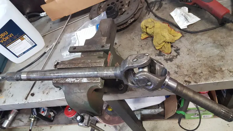

I meanwhile turned my car towards "land" if you will... breaking an UV in my axle shaft, leaving me only with 3 wheel drive...
The tacoma freewheeled, couldnt touch the bottom, and would probably have wet his carpet if he went in all the way
In order not to winch the tyres clean off the car we had to use this spare tire in order to lift the car up and over the ice bank... it worked flawlessly the first time... maybe we have done this before... lol

This morning I went to the garage and tore out the broken axle, this comes to prove that with these open UVs no force should be applied unless the steering wheel is straight, they WILL break, even with a 2.9 tdi :)

Bought new axle shafts from SPICER... welded the UV into it... they usually loosen up and turn, loosen the C clip and break the UV...

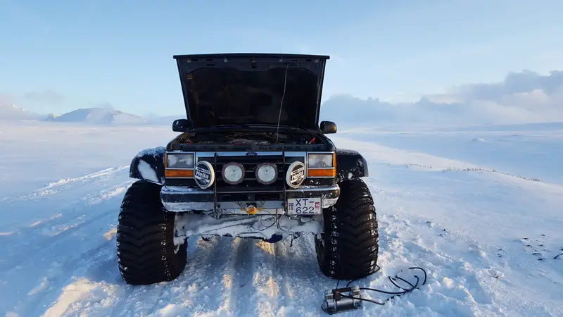

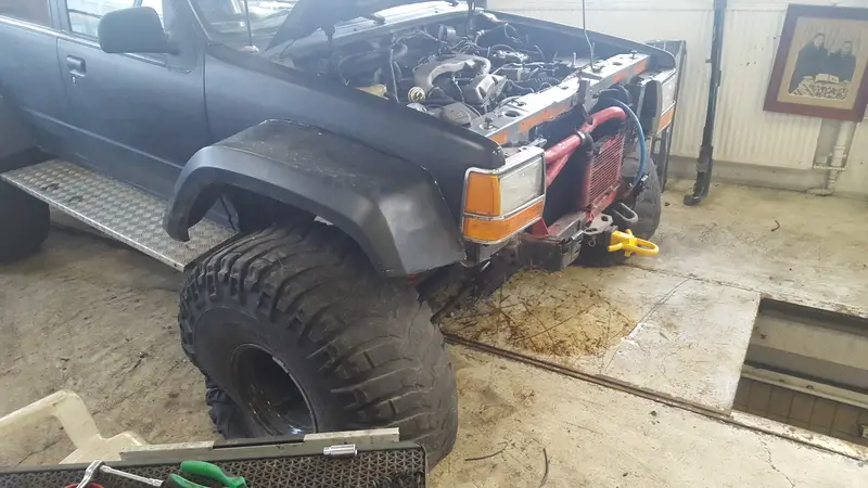

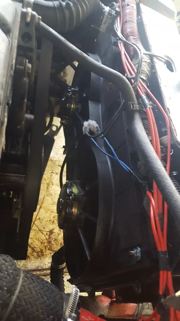

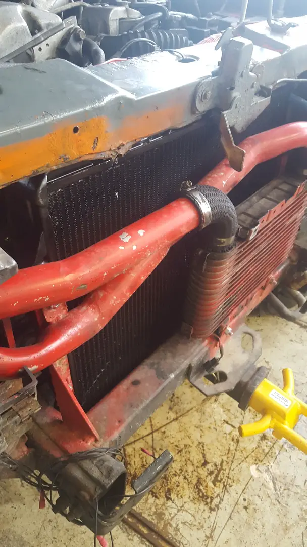

Well I haven't been very busy with the Explorer lately because Ive been waiting for my custom made radiator, a 4 row copper core radiator, and an american made (made in china) electric fan
But after last trip I had yet to glue the fender flare back on... so I did today
Real manly radiator, almost as thick as in a semi tractor truck
Dual electric fans, they kick on at seperate coolant temperatures and draw only 14 amps each
I need to find a new place for the engine oil cooler...
Both fans at full blast
