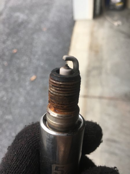

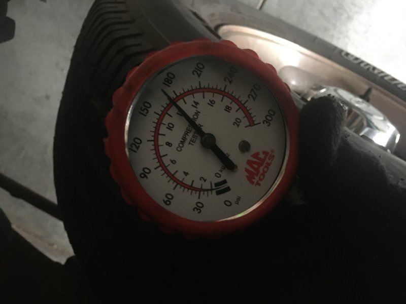

Hi I think it's the plug wire shorting out. Look at it in the darkness.View attachment 176125 View attachment 176126
Here is a pic of the number 5 spark plug, and compression test on the cylinder. Engine was cold at the time. Spark plug has only been in there 3-4.000 miles.
