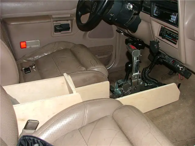

Did some research on the internet about building a center console. Going to get supplies today. I will take pictures as I build. I am going to use birch plywood covered with vinyl to match the stock armrest. Will use the stock mounts on the rear for the arm rest so I can keep the stock height and look as much as possible. Got a double cup holder from a Cherokee center console that should just fit in between the transmission shifter and the arm rest because you gotta have cup holders, Man!! :confused: :eek:

I found some vinyl that matches the interior and should be picking that up in a few days. Roughed out the sides of the console today in a few hours. It lines up with the original arm rest mount and should work.
The Cherokee cup holder I got is too wide (friggin J&^ps) so am using some for a boat. Might only be able to fit one in there.

Nice so far! I have been planning my center console for a year or so, collecting parts etc. Mine will be wood and fiberglass, with a cooler that drains out the bottom of the truck, te CB mounted, ARB switches, gages, cup holders, all sorts of junk is going in there. I picked up some mocha bar stool vinyl that is a PERFECT match for the ford mocha interior years ago, I got 8 yards of it, I figured I would use it for all sorts of stuff, i was right!
Looking good! Can't wait to see what you come up with!
