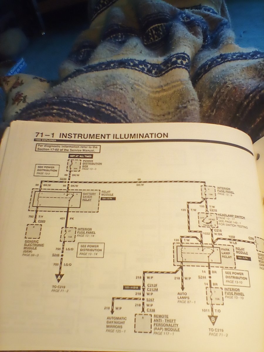

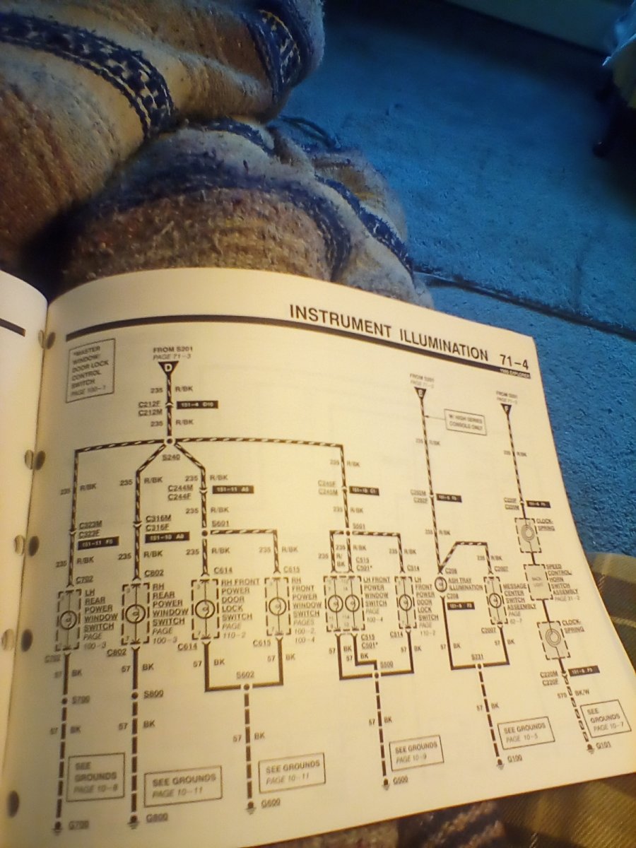

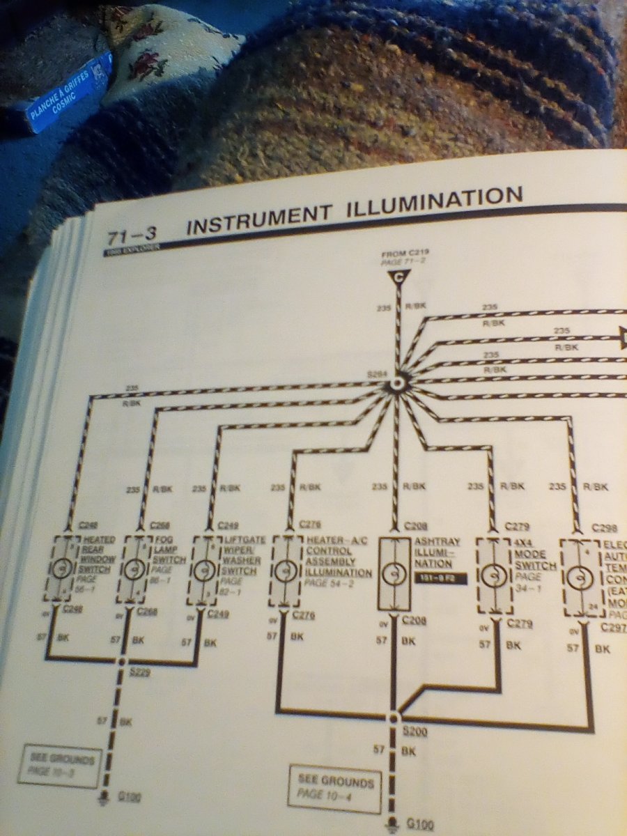

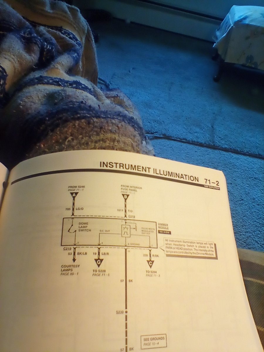

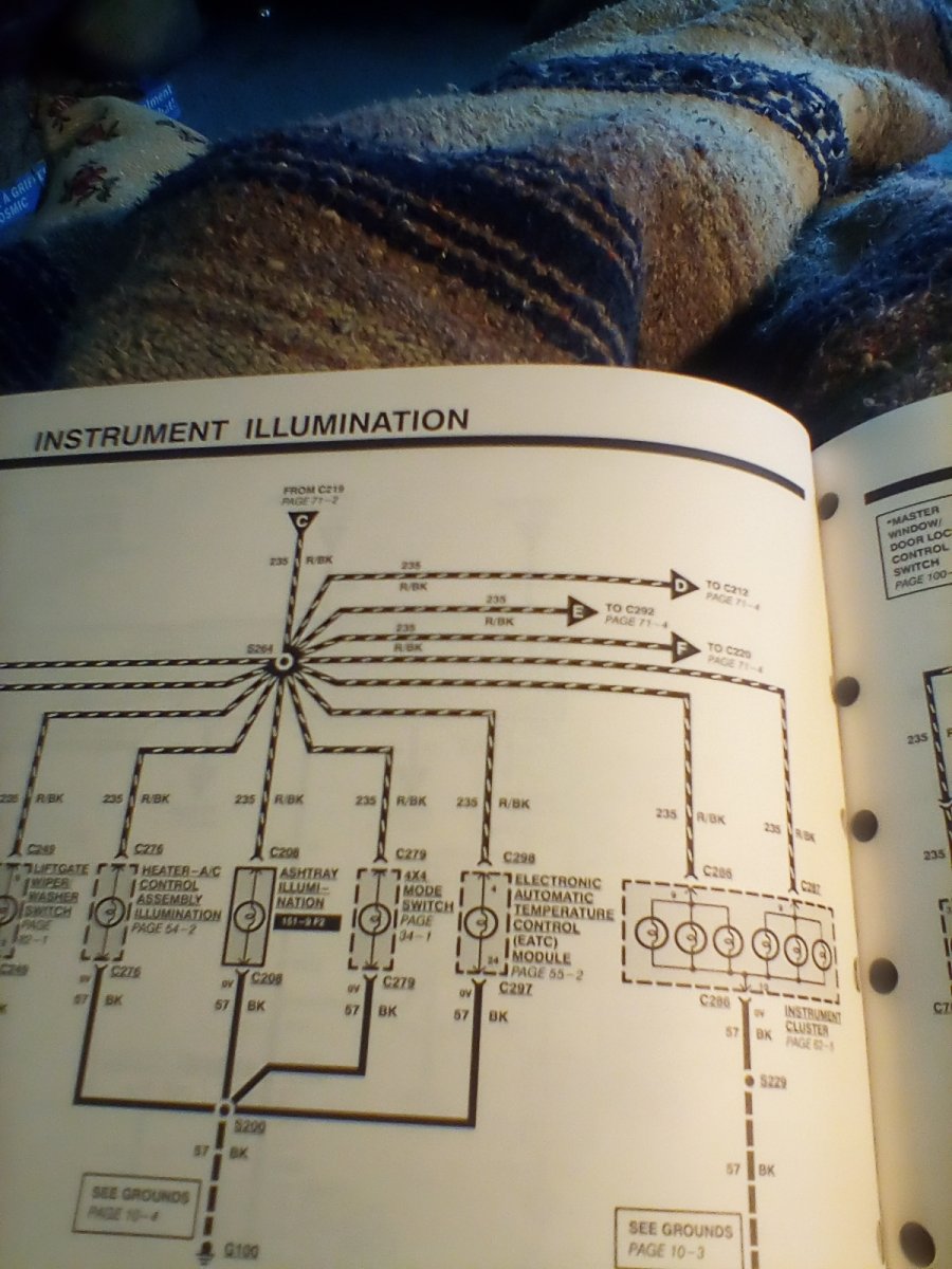

You did not state, if check for voltage at all those points?
I believe, it could be the dimming module.
You need too check for voltage at all the key points. There are a few few fuse that control that system. From the attached diagrams the 4x4 lights are a different system.
See attached diagram. Start at the fuses ( check for voltage) and go thru the diagrams.
1-5 see second post
1-5 see second post

AFAICT, they all (or at least most) including the 4WD light runs through the dimmer, on the red/black wire out of the dimmer module.
It's shown on this attached PDF and it may also be helpful to Jussin, once he acquires a multimeter. This is a merged diagram from two separate ones.
The bulbs i used to replace the burnt ones were all working, both the original headlight switch and replacement were working. I cant confirm the dimmer switch works other than its affect on the 4x4 lights.
? Are you talking about the bulb in the switch for 4x4 switch.
1. Get your test light or volt meter, and see if you have voltage in and out of the original headlight switch.
2. If you have voltage too the switch; then the dimming module is OK.
If not, then the dimming module is bad.
3. Check ground G100 on Left hand fender apron. Or put your multi meter on resistance and see you have a ground at the headlight switch.
4. You can buy a test light at harbor freight for $10. Also There mult- meter is cheap.
Just a Note, if you have a bad connection, the mult-meter will show good , but when apply voltage then the bad connection will open.
5. The relay module ( pink wire)get power from fuse 7, 30 amp.
6. There is also a interior fuse panel. Fuse 27, 15 amp
7. The dimmer module feed wire is light green with a orange stripe.
The under hood light is on that fuse and the interior map lights.
8. If that checks out dimmer module.
a) then you need too check ground G100. Black wire
The headlight switch has two 12v feed too it.
b) light blue with a red stripe
c) brown with a white stripe. ( from relay module)
9. See attached for headlight testing
