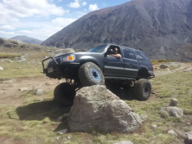

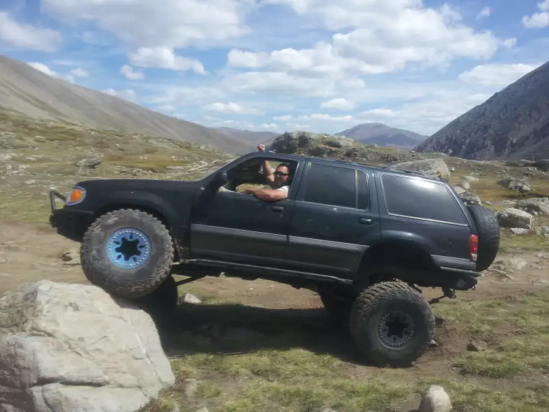

Took my bro out for a day of wheeling at Wheeler Lake. I drove the Merc. He wheeled Double R. And TNT came along for the trip. All three did great and no breakage other then TNT broke a motor mount from doing poser shots on rocks so much. LOL

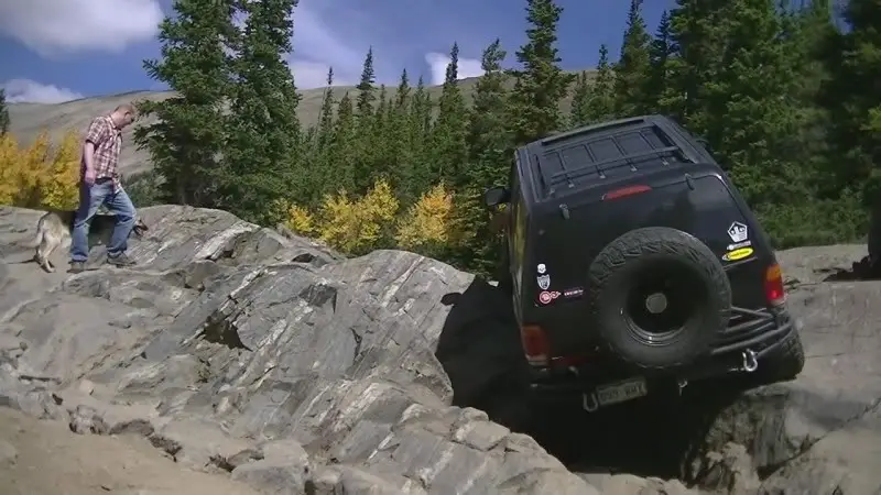

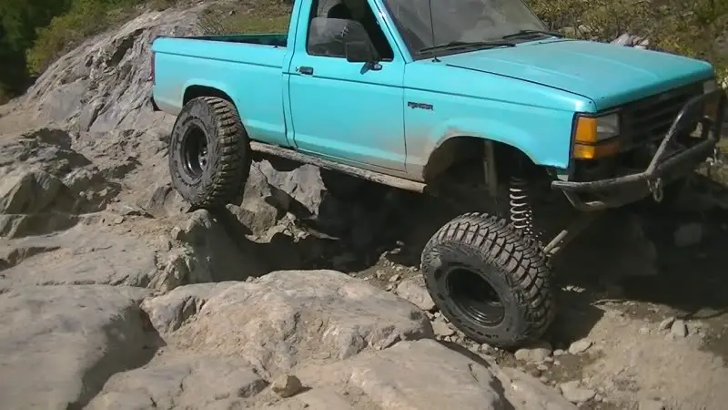

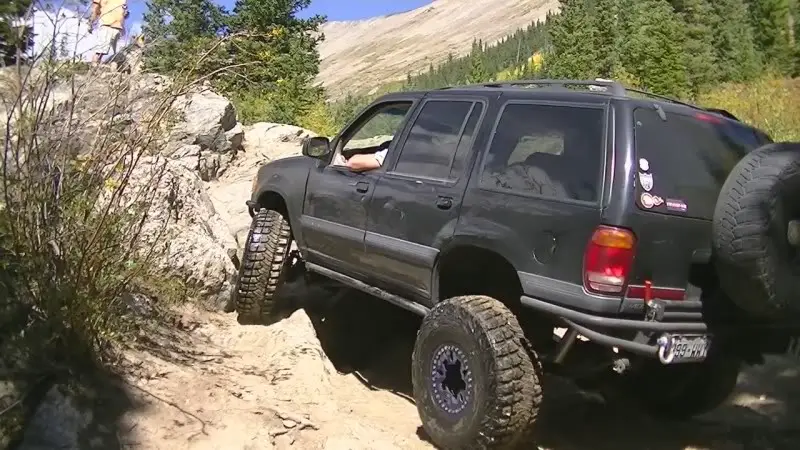

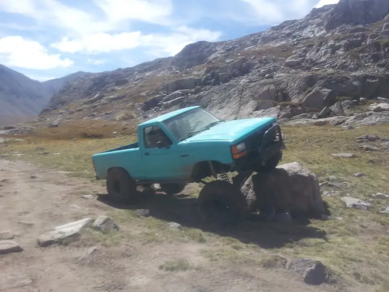

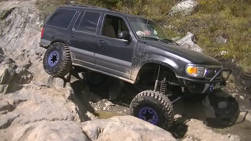

We did a flex test at the top by seeing who could make it up the rock the furthest without pulling tire. Winner in order.
1st place (easily won still think there was more in her)...

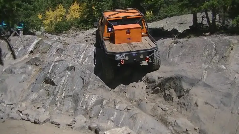

2nd place (kinda thinking Merc should have been 2nd look at the day light under drivers rear)....

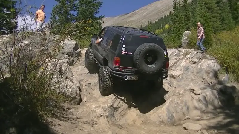

3rd place (should have be 2nd by default since TNTs owner told me when to stop right before his mark on the rock. I didn't feel bad though cause Double R blew past his mark. LOL)
I think you caught a sasquatch in the RR flex pic!
LOL yeah that guy... He was up there on ATV with his woman she had about the same amount of clothes on. He asked how much I would charge to make his Toyota like the Ford. I said I don't work on Yotas sorry.

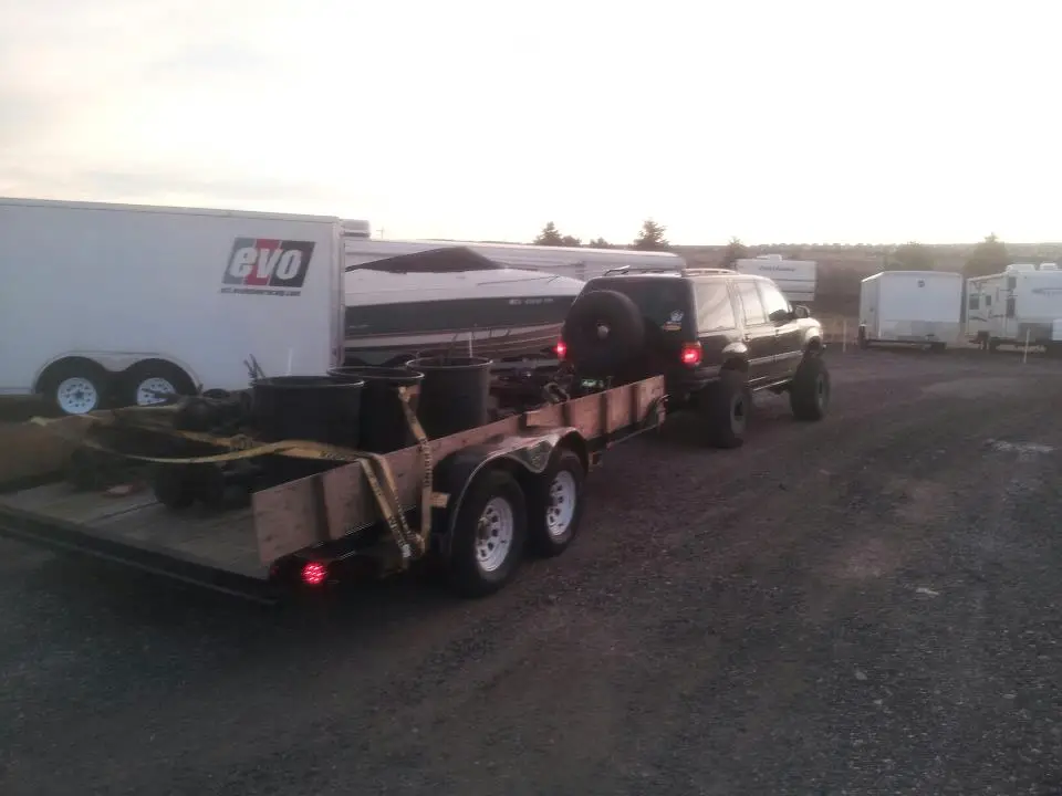

Here is pic of me using the rear bumper I built to tow 4,000 lbs on 50 mile trip to haul scrap metal. Merc did great.
