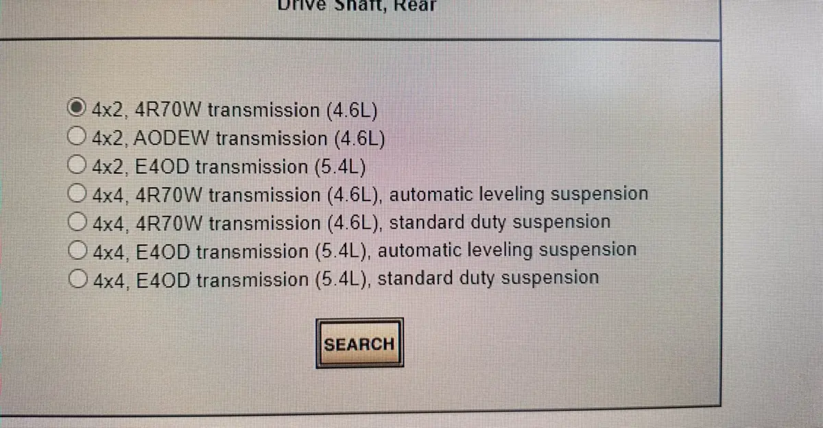

Also, what when I search for the rear driveshaft on car-parts.com this is the only choices it gives me

I thought that we needed one from a 5.4? Does it matter what transmission will the driveshaft from the E4OD work?
