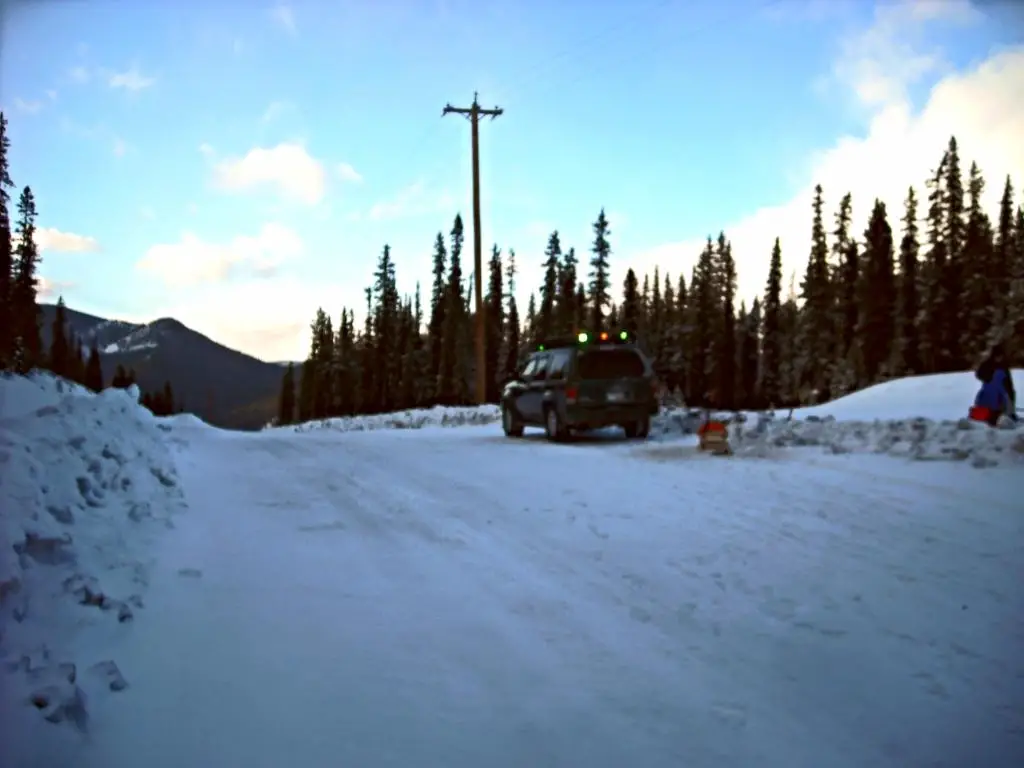

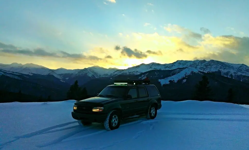

Here's some quick pics after a long day "Exploring" some Alberta back country today, more to come.
Looking west as the sun sets over Panther creek towards Jasper National park.

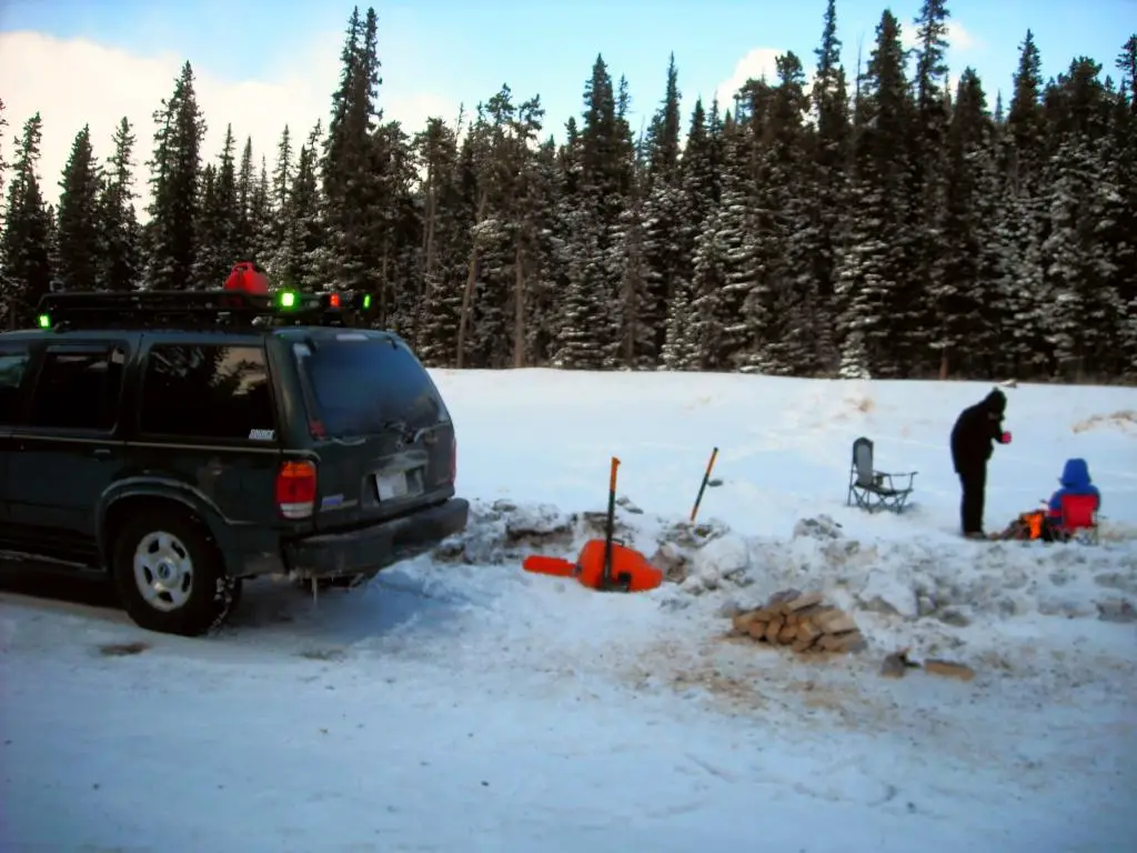

A nice fire, hotdogs and some sledding along Sheep creek.

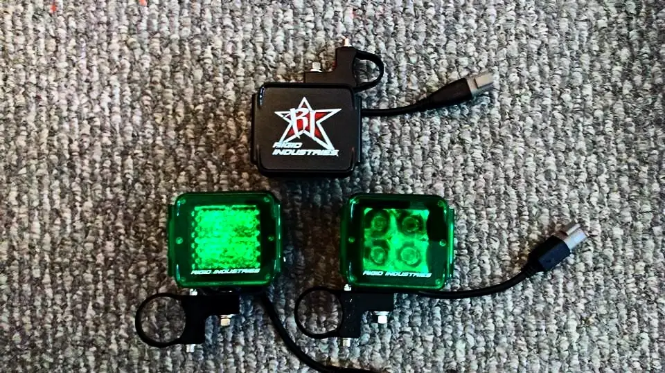

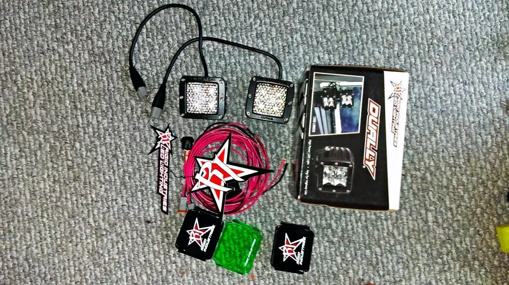

I first got a pair of Rigid Dually Diffused pods for camp lighting and 1 Dually spot. I put the spot up front with the plan of it being used as a reverse light once I got a 30" bar.
The Quality really impressed me right out of the box.

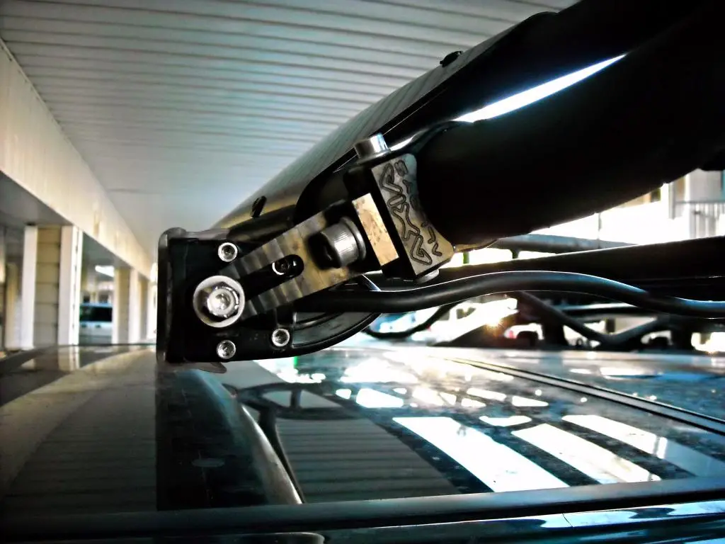

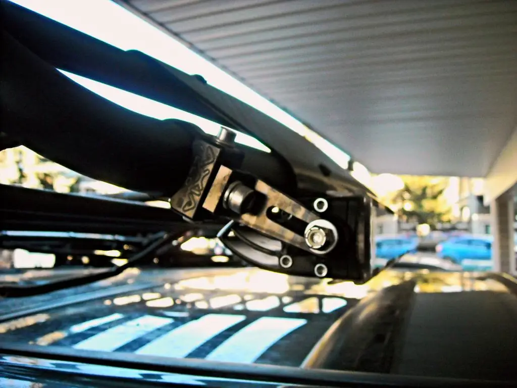

I mounted them to my rack with the Rigid billet tube mounts. These fit perfectly and mount very tight.

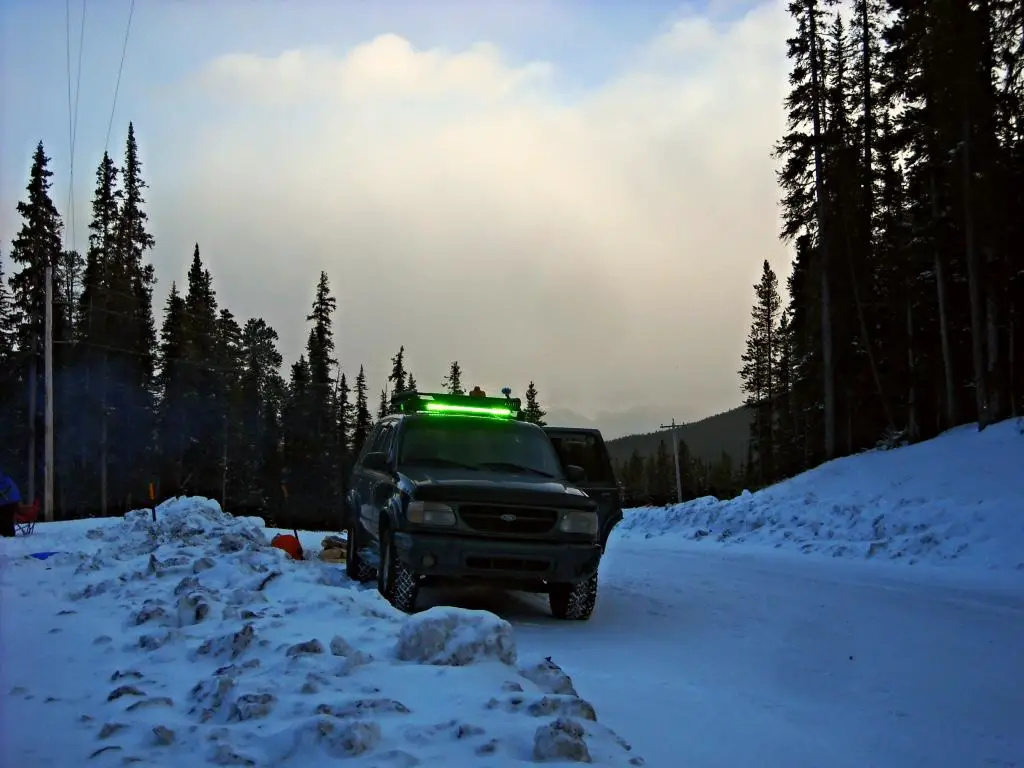

I also got some green covers for a little protection and so the light isn't quite so harsh when lighting up camp.

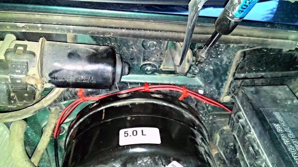

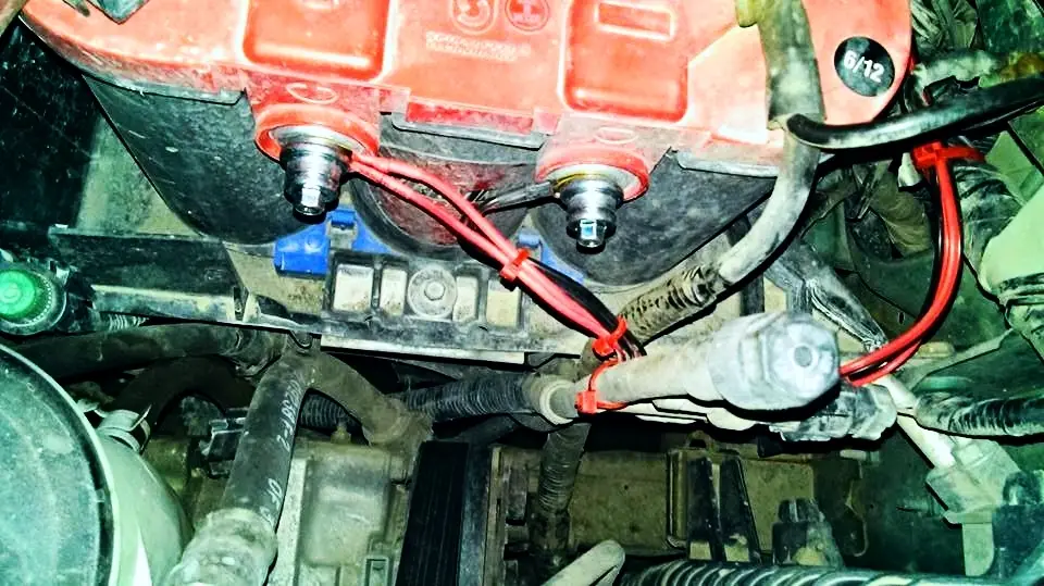

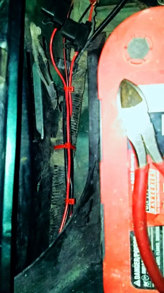

I decided the side post of the Red top was the best place to get power and use as a ground.
I tried to tuck the inline fuses as out of the way as possible.
As well as the rest of the harness.
*I think the truck will still get 1 more Dually diffused per side and after that I will run some wire loom over the harness.

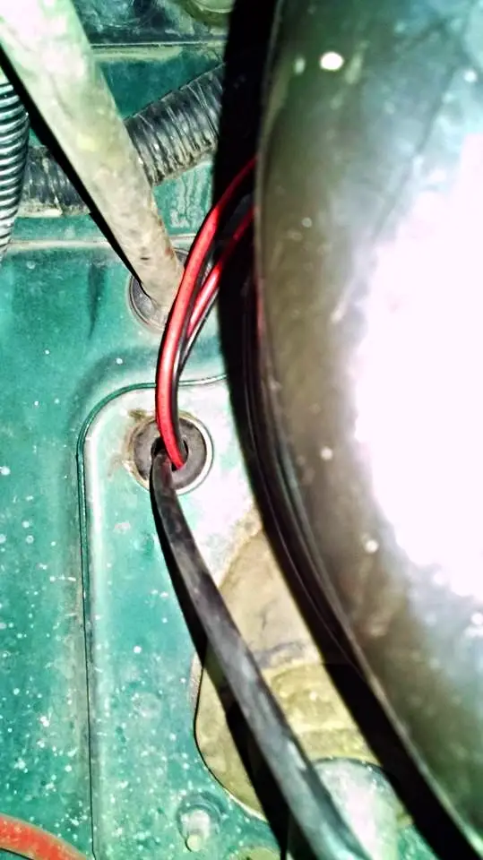

I put a new grommet around the hood latch release cable and ran the wires though there.

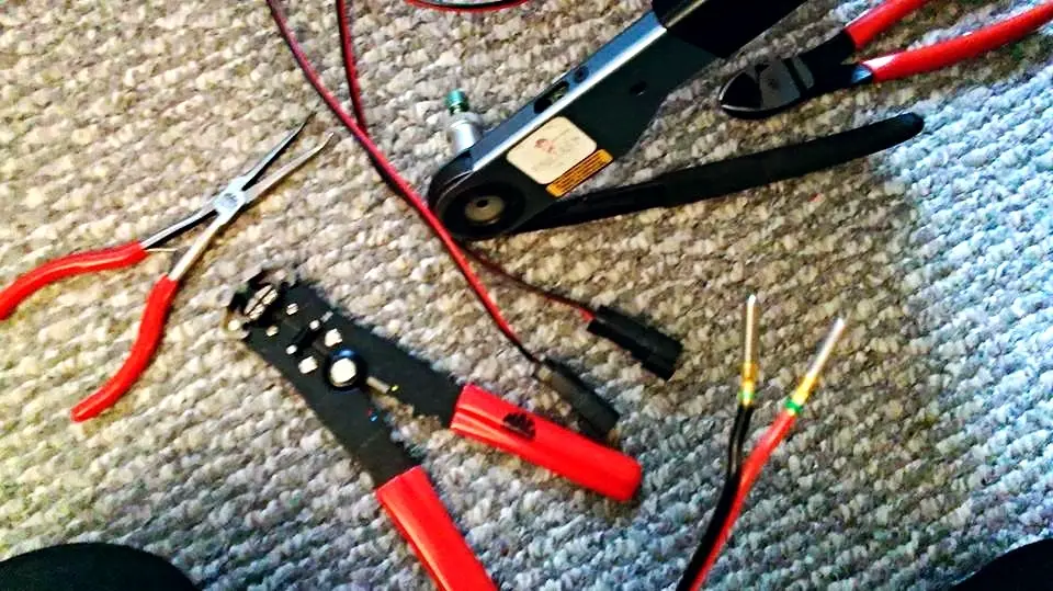

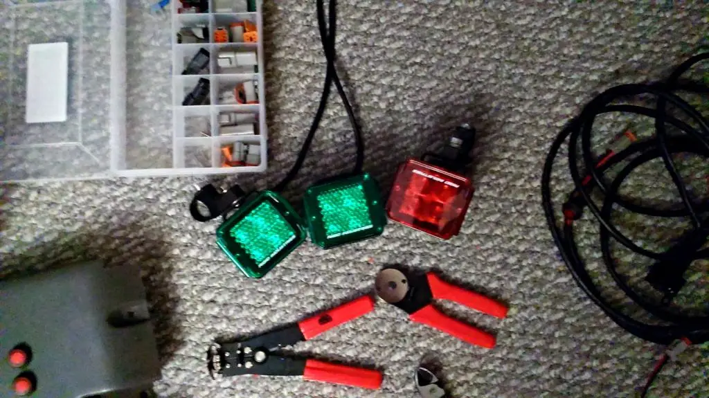

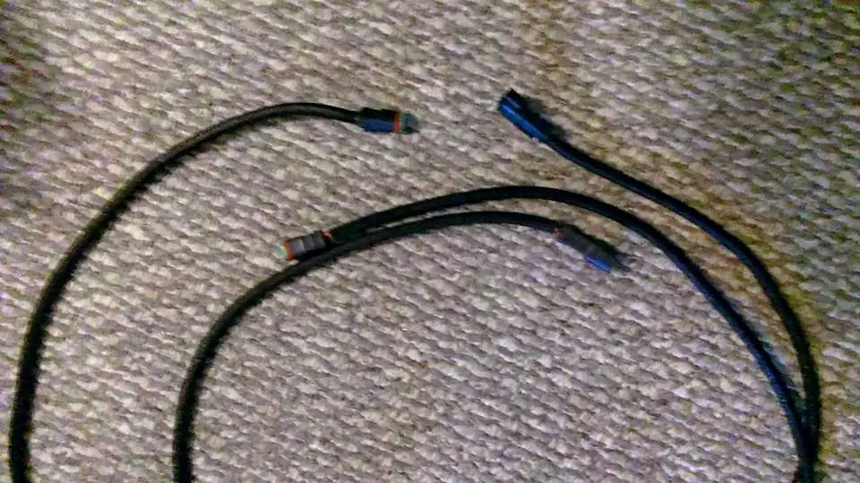

I needed to make some harness extensions so I ordered some 2 pin Deutsch connectors and borrowed a crimper from work.
I built the extensions and covered them with some 3/8" asphalt loom.

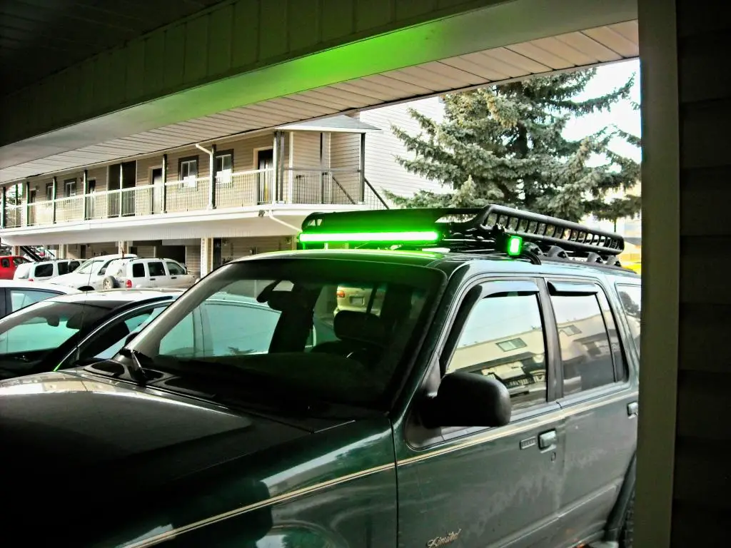

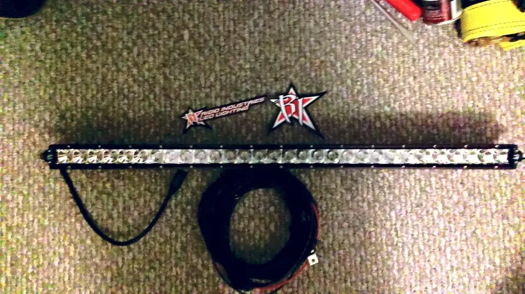

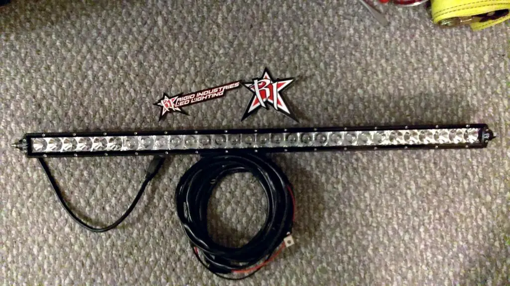

Then I picked this up and 2 more Dually diffused.

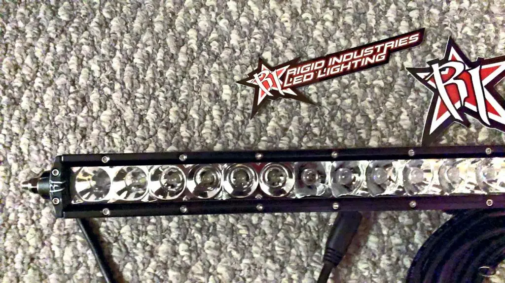

Rigid SR 30" combo.
You can see the flood optics on the end.

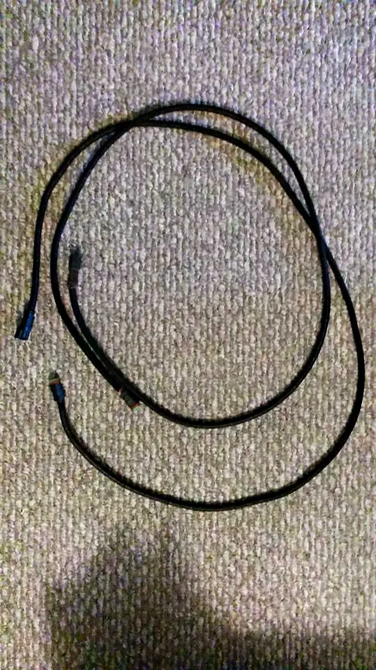

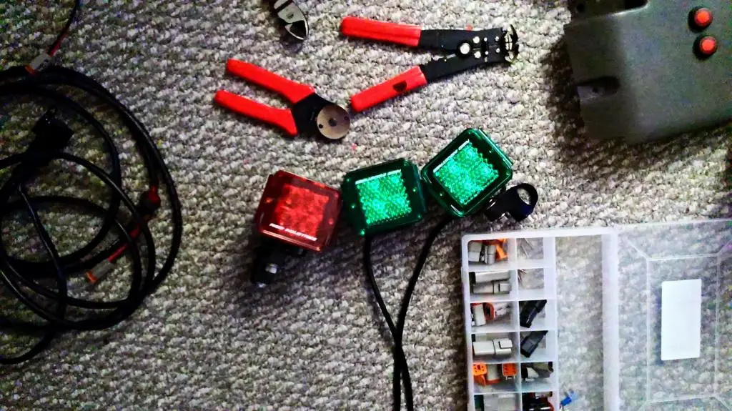

I needed to build some more harness extensions and decided to pick up a Deutsch connector kit that came with a crimper, this will be nice to have around. Got some more covers as well.

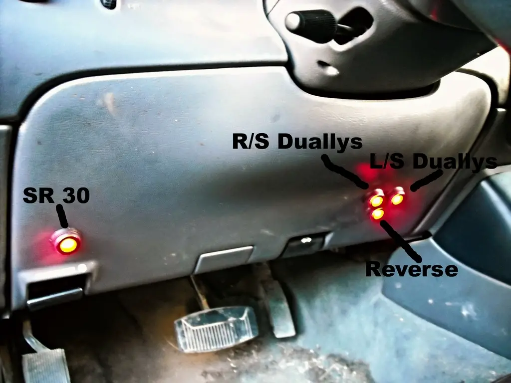

I mounted the relay for the SR 30 under the dash and this is what the switches look like.

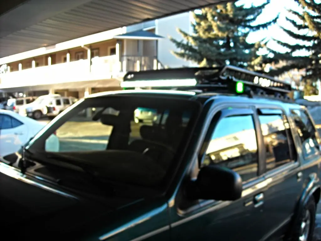

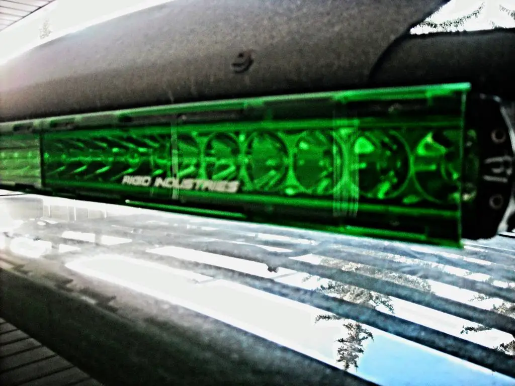

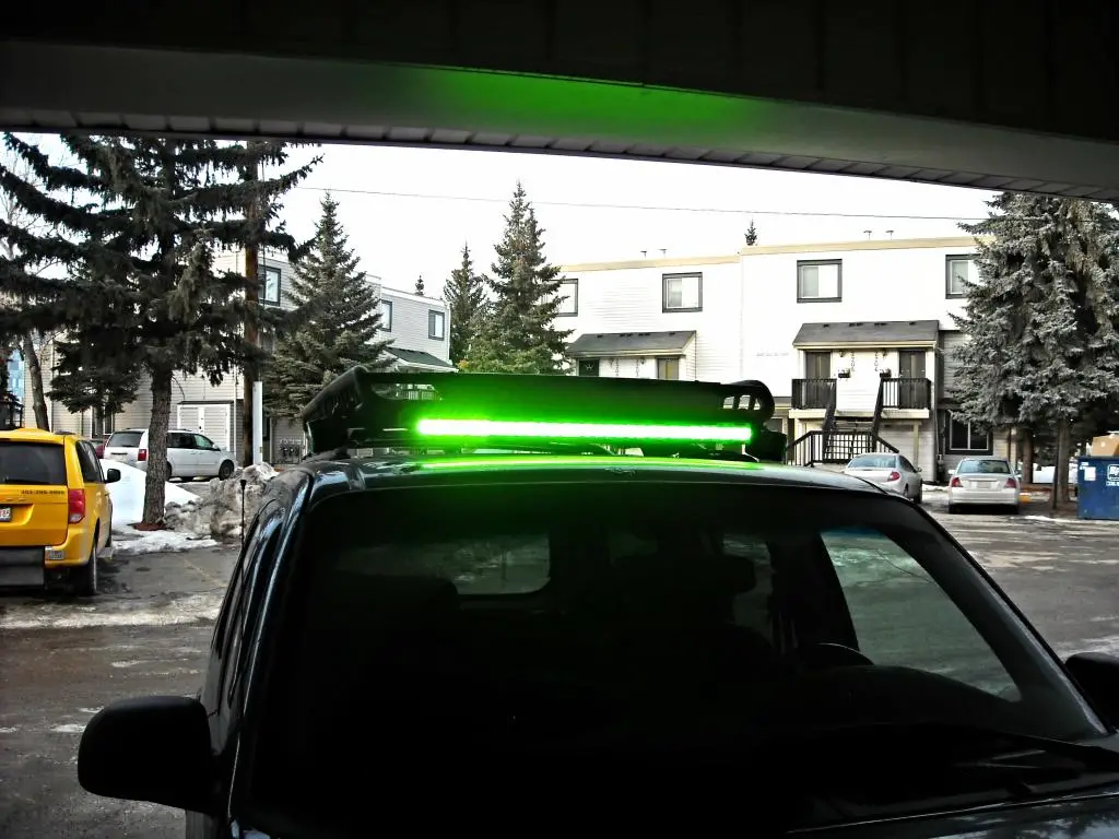

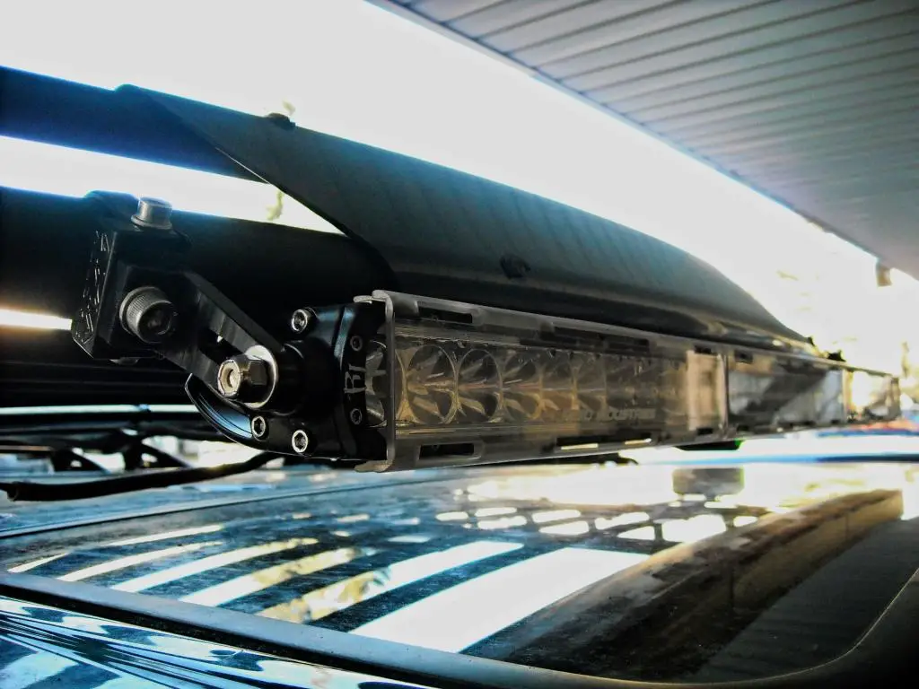

I also mounted the SR 30 using Rigid's billet tube mounts. The mounts are really clean and the light is solid.
This is when I added the extension to my Rola rack along with 2 more cross bars I picked up from the wrecker.

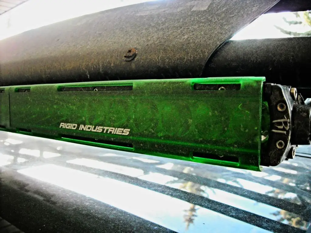

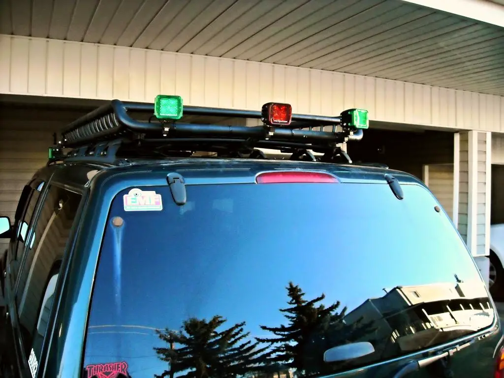

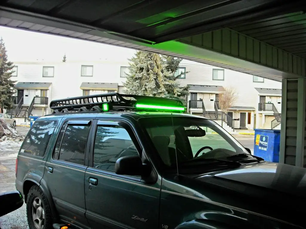

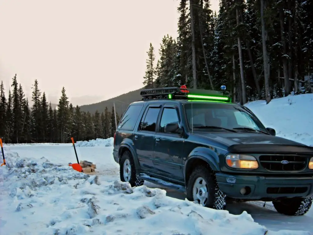

I got some clear covers for some extra protection and some green ones to match the Duallys and for driving in the snow. I think I'll still get some ambers as well.
I think it looks good tucked under the rack and not to flashy.
I couldn't wait to actually go use this light.
This is what the Duallys look like on the back. As I said earlier I think I want one more Dually per side, a little more light will be nice but i would really like to be able to control the right, left and rear separately, right now it's right side and right rear on one switch and left side and left rear on another switch.

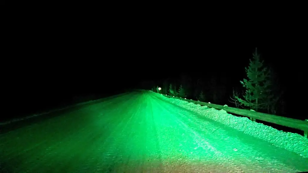

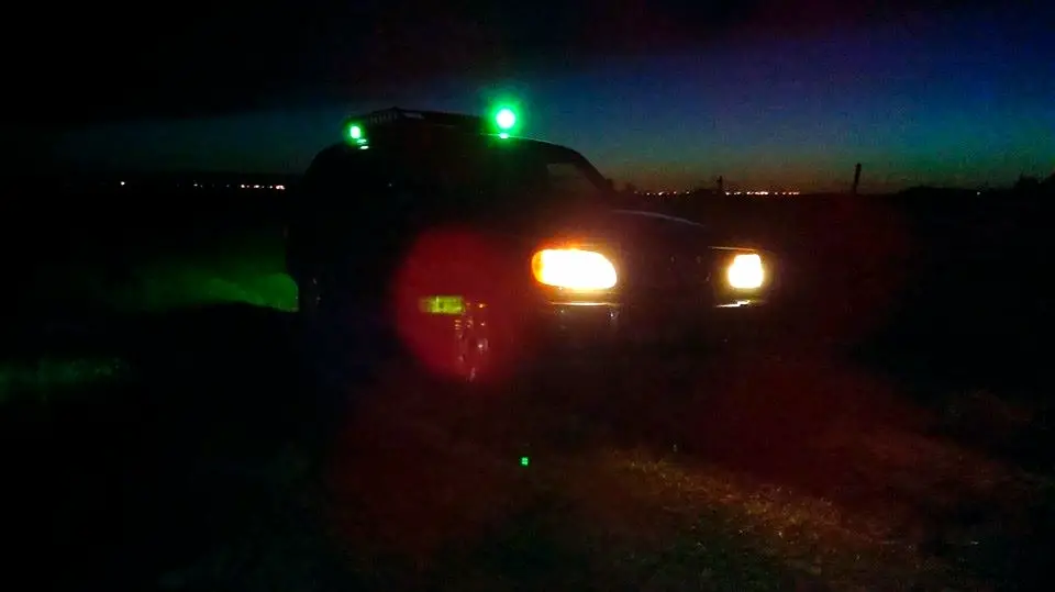

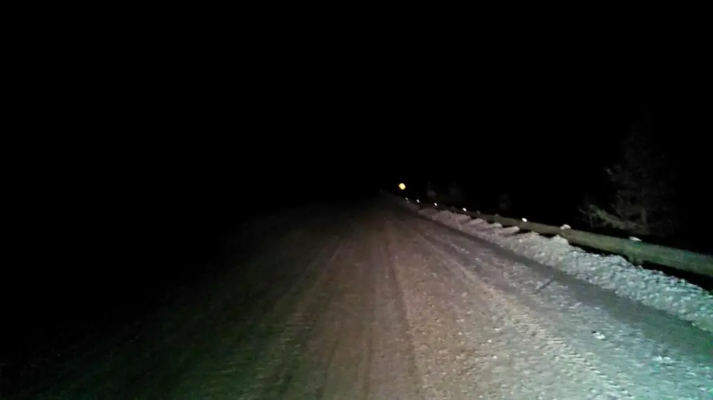

I was finally able to get some good night time comparison shots. These are away from the city with only a little bit of moonlight.
Stock low beams.

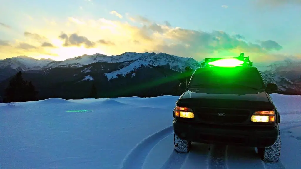

The green was nice on the snow because it's not nearly as harsh as the white, it did take a minute to adjust once back on the highway though but it wasn't bad. I do like how the green matches the truck and the other lights but I still want to try some amber and blue covers in the snow and dust.

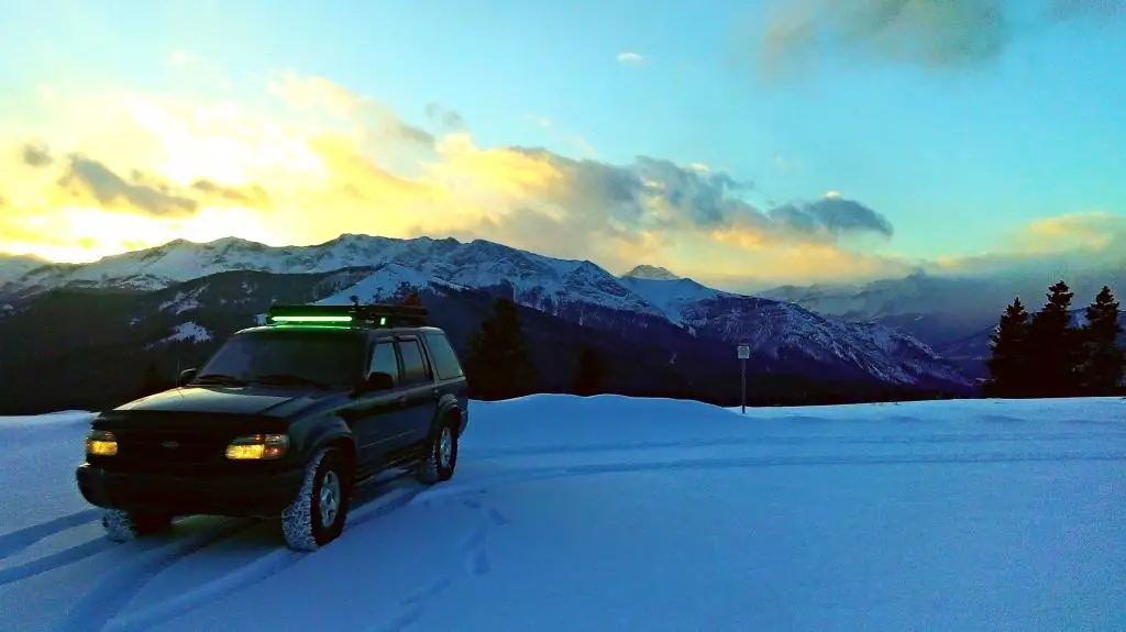

I found a good hill to climb up next to this back road and got some pretty decent "aerial" shots of all the lights.
All on.
Just SR 30 and left side Dually diffused.
Just SR 30.

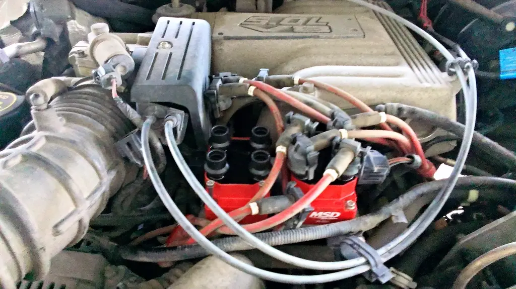

So after almost 2 years both of my MSD coils shorted out and all I could source in a timely manner were 2 more MSD's, so I reluctantly went that route again. These ones better last more than 2 years but I'm not holding my breath. The MSD's are really nice when they are working but I think they will be swapped out for some Screamin Demon coils sooner than later...
The red sure looks good...
The last time I will ever buy an MSD coil.
