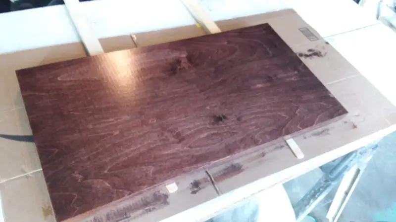

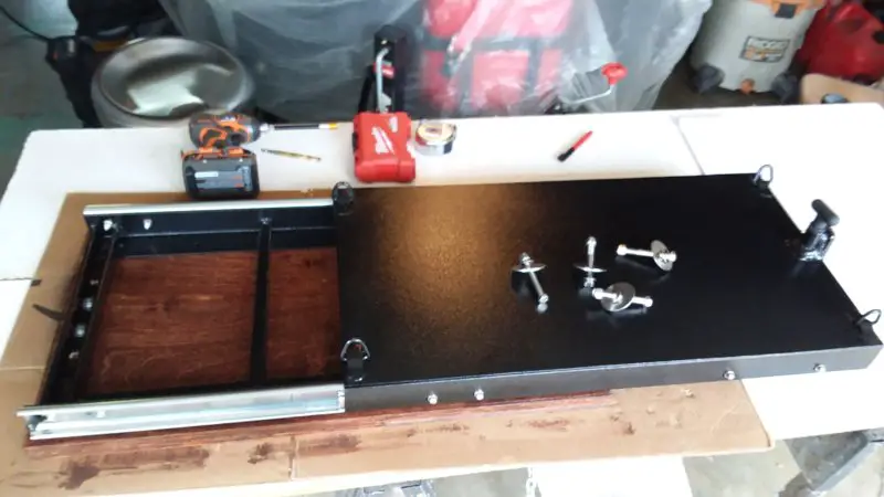

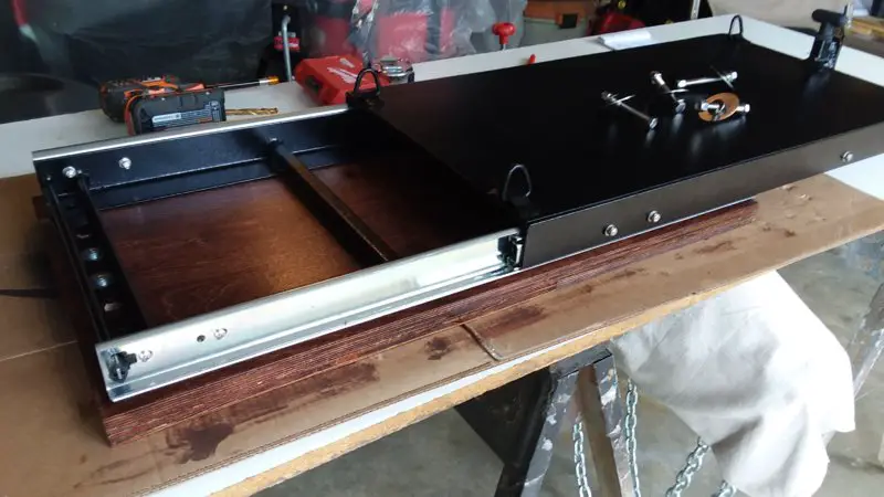

Fridge slide has returned from the powder coating shop. Looks fantastic! So glad I went ahead and splurged on this item. :) The powder is Hammertone Black, 60% gloss.

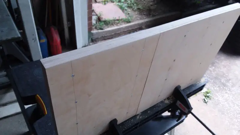

I made the base to lift it up off the trailer floor, to clear the cabins side door that this will exit from. I ended up going with a 1.25" lift using a sheet of 3/4" & 1/2" Baltic Birch Ply. I wanted an extra 1/4" height to let the slider's lock nuts to clear the door opening better. (Remember last post telling the width widens as the opening rises). The top gained 1/2" width because of these locknuts.
After cutting the ply (3 pcs), I countersunk 16 (ea) 1" R2 head SS screws and fastened the two layers from the bottom. Sanded all edges flush, then stained, and 3 coats of spar urethane gloss to match the trailer floor.
After assembling and adjusting the slides back on the unit, it was held in place to the base with a couple wood screws/washers to mark and drill the 3/8" mounting bolt holes. I had to drill a couple holes into the base's top latch pc, to be able to get a drill bit from the top, thru the base, and into the trailer floor. Hated to do that after the powder coating, but I painted the fresh drill holes to match with some good old Rustoleum. I swapped out the slides 1/2" bolts with 3/4" bolts, and then cut off the extending bolts flush with the locknut. 1/2" bolt just didn't make it past the locknuts nylon by 1/16" or less. Bummer. All good now!
It is now ready for install in the trailer. Will get to it soon. Pictures don't do this any justice. It's way bigger than it looks, and it looks way better in person. I'm very happy with myself on this item. (pats self on back)

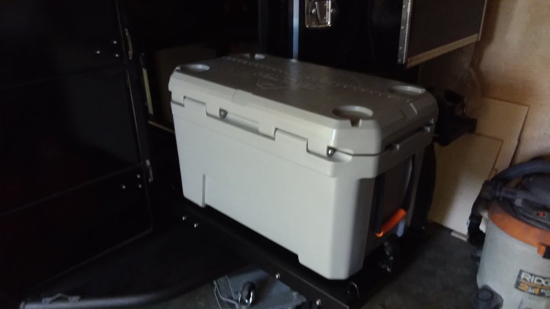

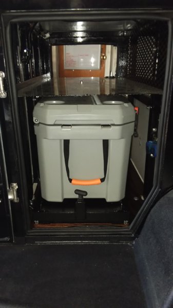

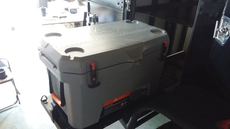

Drilled the holes for the 3/8"x3" SS bolts, and mounted the slide to the floor. Large fender washers on the underside bolt heads.
I placed the 70 quart Coleman Marine cooler on it, and it fit no problem. I then found that the 54 quart Ozark trail (Yeti knockoff) is the same size as the 70 quart. The 54 quart is at least 5 times heavier, so I used it for the mock up. A 54 quart fridge I'm looking at is the same size as this cooler, and since there is some room to spare, I might go for a larger 65 quart dual zone fridge/freezer.
The 1" over extension slides worked out perfect. The lid can be opened fully with room to spare next to the cabin. This thing is solid. Smooth operation opening & closing, and the lock latch works flawlessly. :)
All the way in the cabin Dr side
Pulled out view from front of trailer
Pulled out view from rear of trailer
I put 100 lbs of weight in the cooler. When fully extended, the slide doesn't show any signs of disturbance from the weight on it at all. I believe this can be called a successful mod.

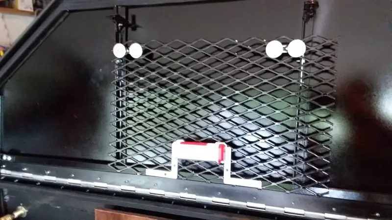

I had a half sheet of expanded metal left over, and decided it would make a perfect mount wall for items, such as the Charge converter. Measure, cut, prime, paint. Mount to underside of tongue box lid using the center supports, with right angle brackets, bent at a 90* on one side. Drill out holes, and install small rivnuts. Screws and SS fender washers on the brackets, and utilize the holes made for the light bracket for the bottom of the expanded metal. When the time comes to install the converter, I will move the light and change the brackets to more washer/bolts. Couldn't center it as the holes in the expanded, wouldn't line up to the lower holes. Ah well, I can trim it down later.

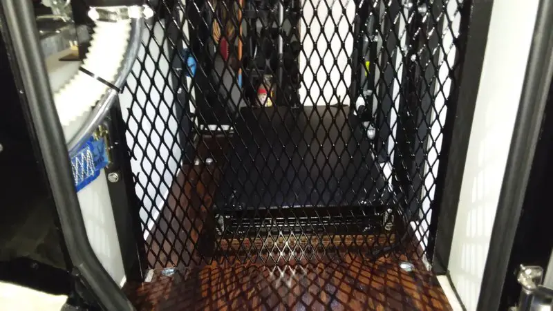

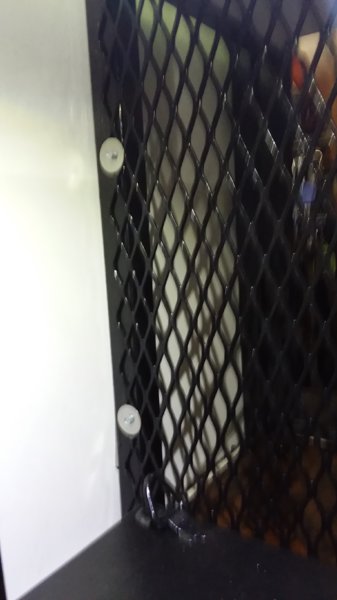

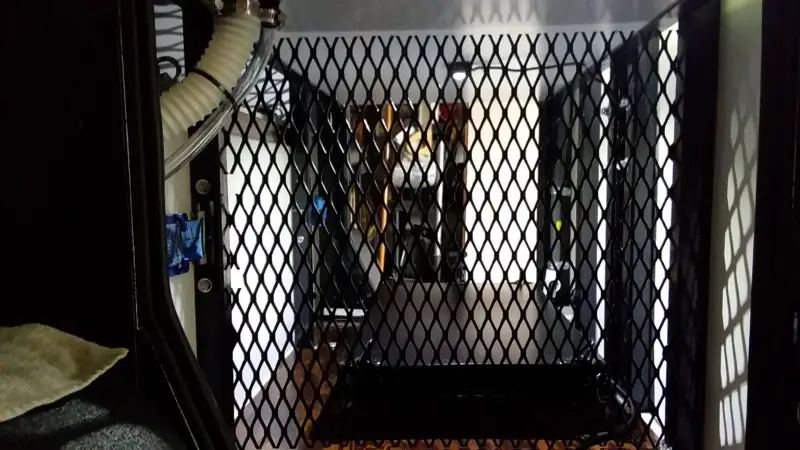

So, while I had the expanded metal out, I decided to make a divider wall inside next to the fridge slide. I plan on using that lower space next to the fridge for the tent accessories. Annex room, and cold weather hood mainly. I will use a small cargo net to hold it all in place so none of it will hit the inside of the door.
Pass side view.
Mounting bolts to frame. Other side is the same

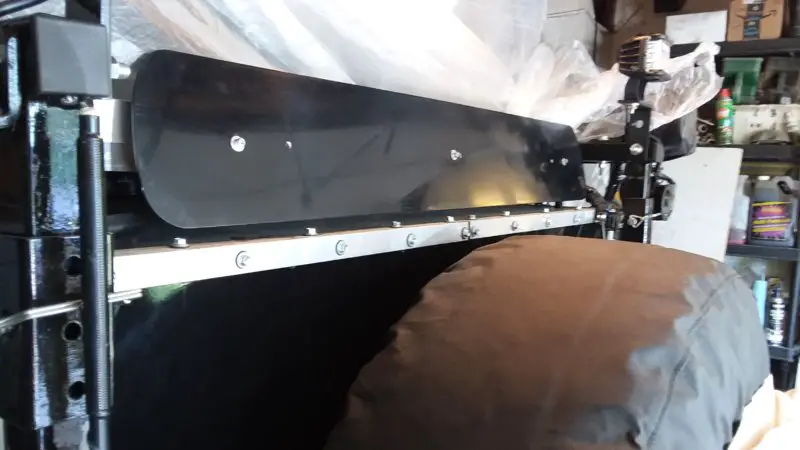

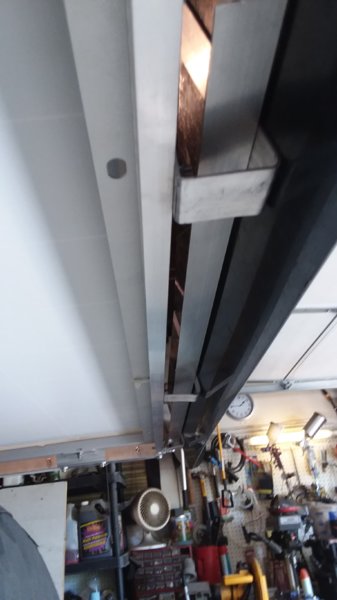

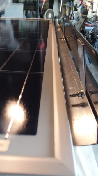

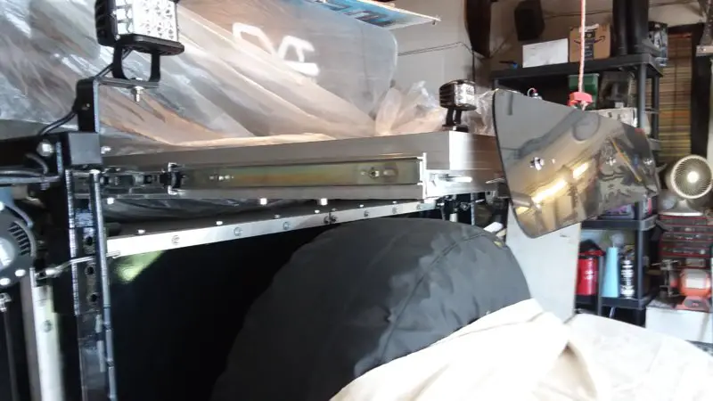

In the spirit of free to me mods, I decided to remount the wind deflector for easier use of the solar panel.
I had it mounted to the trailer cabin front wall, and in order to deploy the solar panel slide, the tent rack had to be lifted to clear the wind deflector. Originally thought no big deal, as I really wouldn't use it until after tent was setup. I decided against that foolish line of reasoning.
Made up a new set of aluminum brackets using 1.5" flat stock, and a pc of alum angle to brace the deflector from behind. Drilled a few holes into the alum channel frame I made for the panel, and bolted this bit of kit together with the same stainless hardware used before.
So now it is attached to the solar panel itself, and can slide out when ever I want to use it. Campsite, parked in piggly wiggly, driveway, on a cliff having lunch, etc...
Top view of brackets.
Bottom view of brackets.
Closed.
Open.
