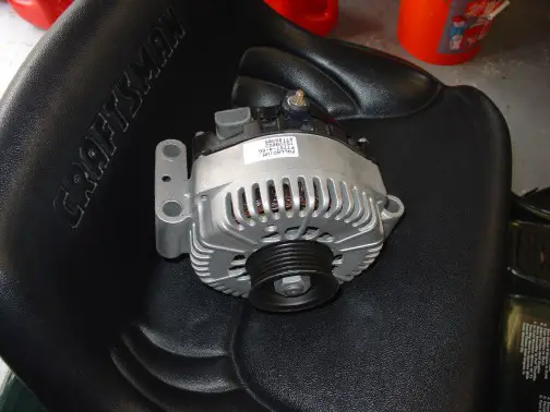

I picked up a rebuilt 130 amp alternator at Advanced Auto Parts. The cost was $154.88 with a core charge of $75.00.

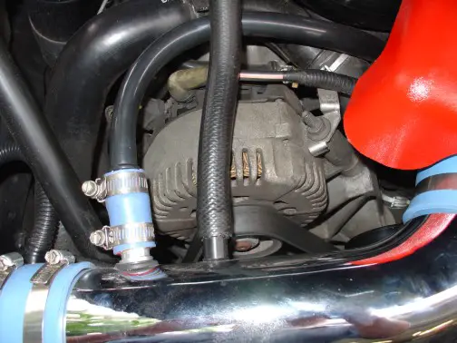

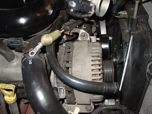

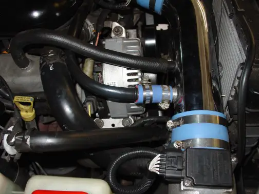

To remove the alternator, first disconnect the negative battery cable. The next step is to remove the intake tube and its ancillary hoses to gain access to the alternator. The next step is to remove the serpentine belt from the alternator pulley. The next step is to disconnect the wiring harness from the voltage regulator. This is followed by the removal of the nut securing the B + wire. Remove the two bolts and one nut that secure the alternator and lift out the alternator. The ¼” air ratchet speed things along nicely.

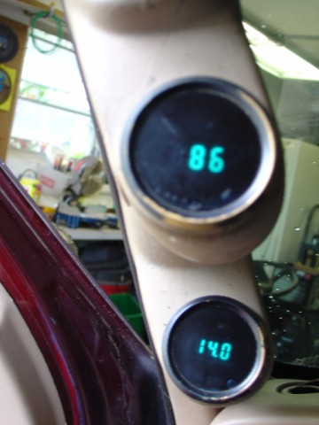

The truck was cranked and the volt meter monitored. A display of 14.0 volts at idle is a welcomed sight.
The installation took less than 15 minutes. It took longer to go to the auto parts store ( 3 miles away ) than to do the removal/replacement.
