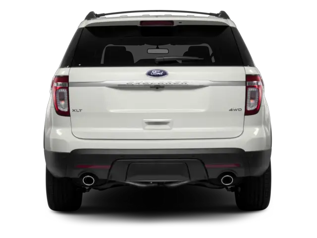

here is some pics
this is stock exhaust " pic from internet"
this is mine after changing them , " sorry i didn't take before"
as you can see they are bigger and wider, but guess what?
they aren't the real exhaust

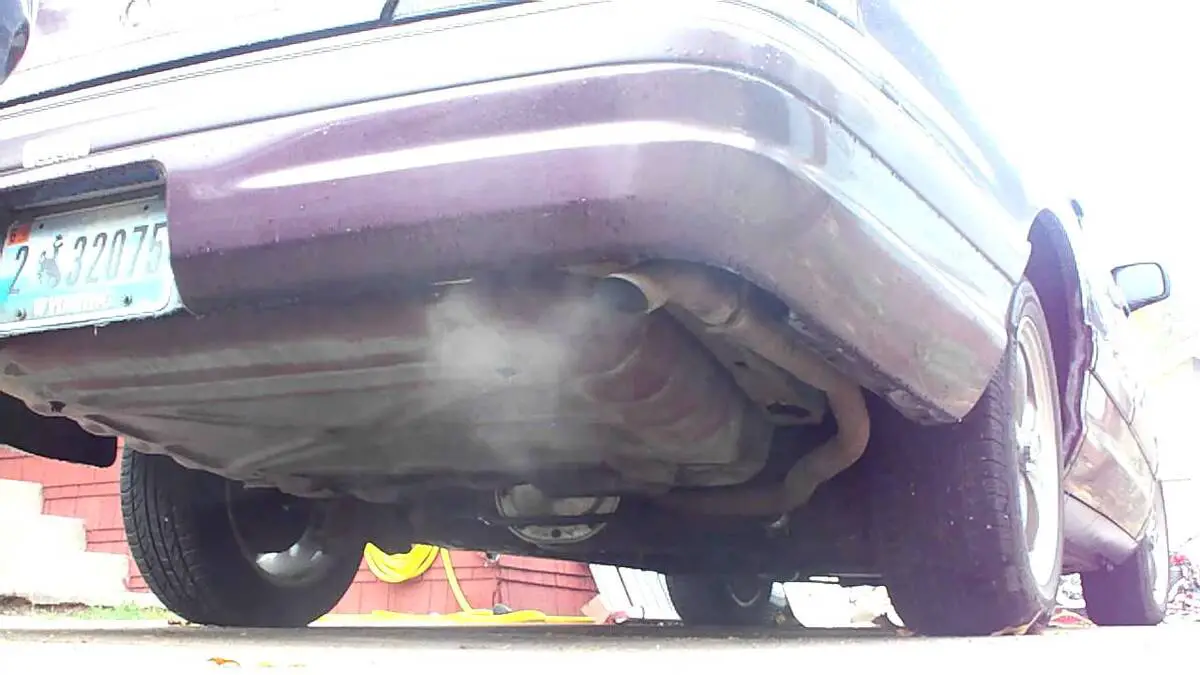

check this pic from under the car
the holes now under the exhaust mufflers, they changed how the exhaust go out like the old style cars
for now my problem fixed 100% and from my experience, this issue isn't catalytic converter at all.
