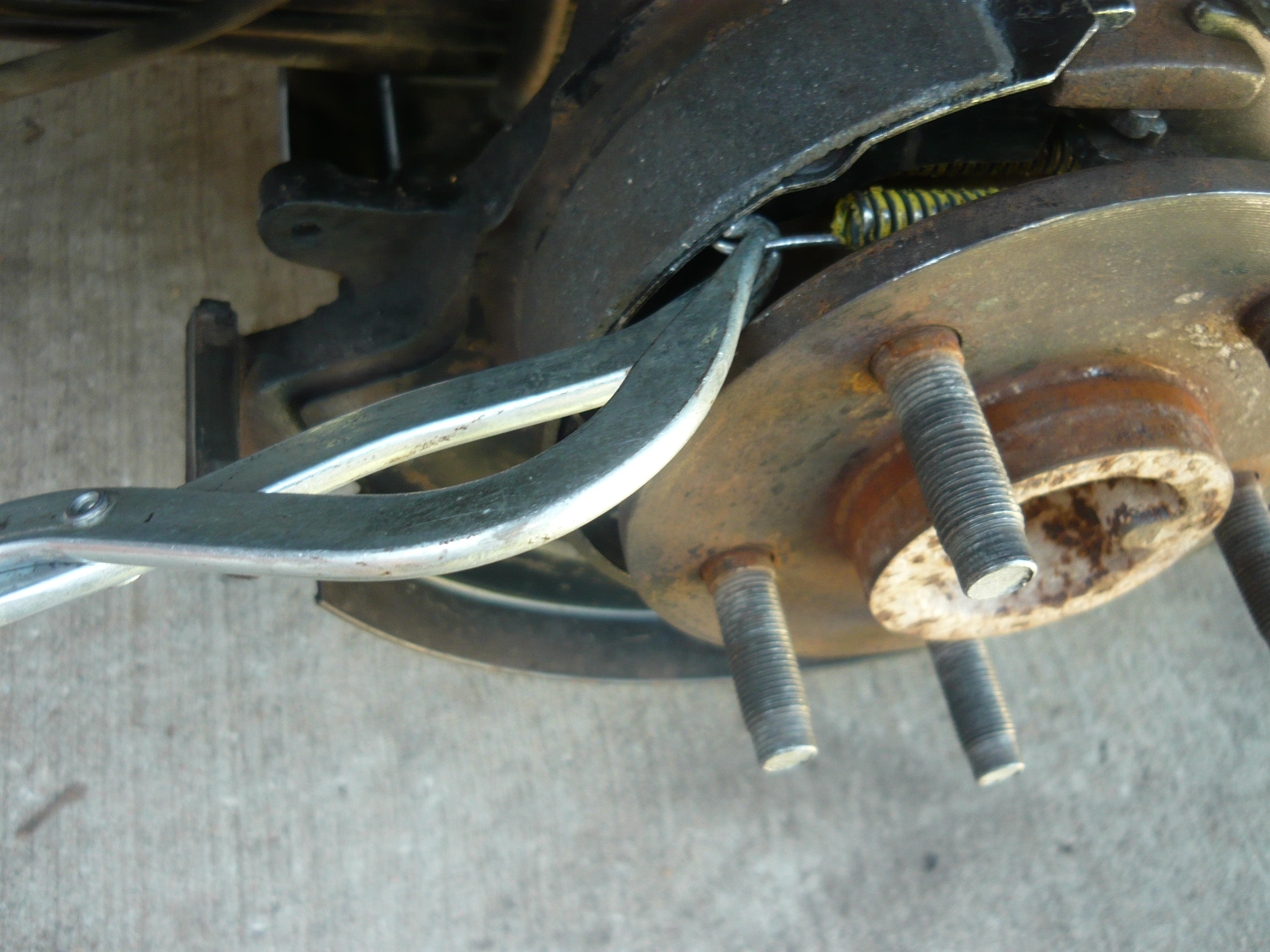

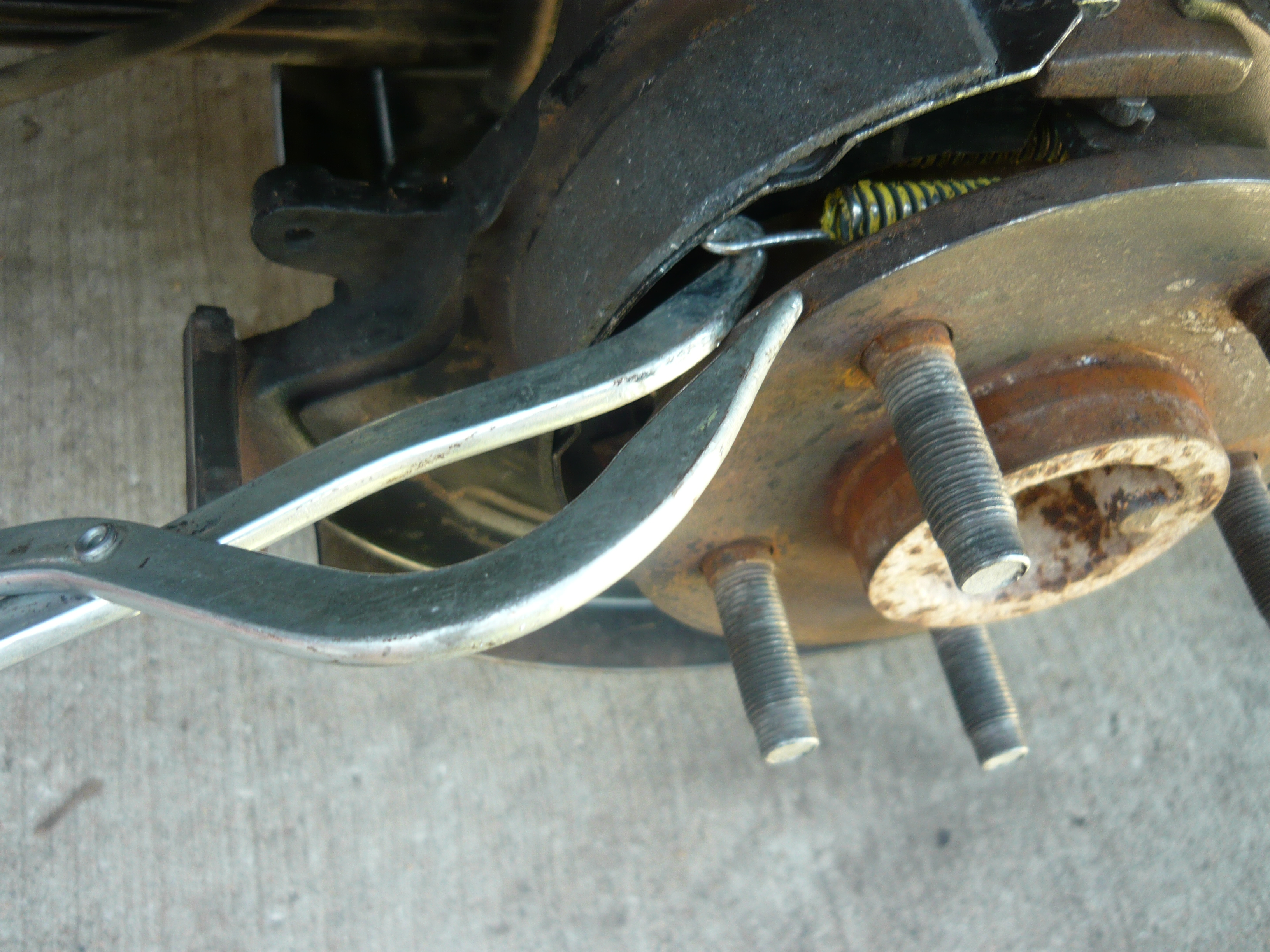

I literally had a dream last night about using it to reach in, grab the spring and hook it into place. Turns out this it what this tool does! WoW!
I was trying to use it in the wrong fashion, using the hook to slide it to the slot like my old hook did.
My comrades, I shoit you not. This tool is a life saver! ( I am going to take the liberty of editing the first post of theh "how to" with pictures.)
With this tool you reach in from the side you want to pull from, hook the spring and then grab it with the "plier" tooth of the opposing scissor side.
Now the spring cannot slip out. The handle makes it easy to pull the spring into place at the right angle, and with enough of the hook protruding, with the proper reach around to just hook it, and let go.
I literally lit a smoke, took a puff, grabbed the hook and right into place she went.
Pictures attached. Feeling much love for the day now!
This tool iS GM on one end, and Ford on the other. It also quickly connects and disconnects posts mount springs
