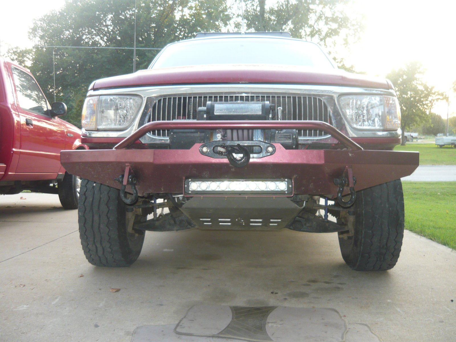

@traveler gave me this big ol trans cooler, If I recall correctly he told me it was off a v10 f250
After trimming and stuff I found a good spot for it, low down right in front of the condensor. The mounting hole on the left is the existing core support hole, I used a self tapper on the right side mount.
There is about half the space between the condensor and cooler now, so I think the belt driven fan will draw more air thru it.
If there is not enough air through it, I have room for one or 2 of these now easily.
LoL that's pretty much where I have mine. I have 2 fans on mine. I towed the camper yesterday in 100*+ heat abd the transmission never got over 180.
That's great news. Your Mighty EB performs real well, I must say. Thanks for the cooler and being the guinea pig!

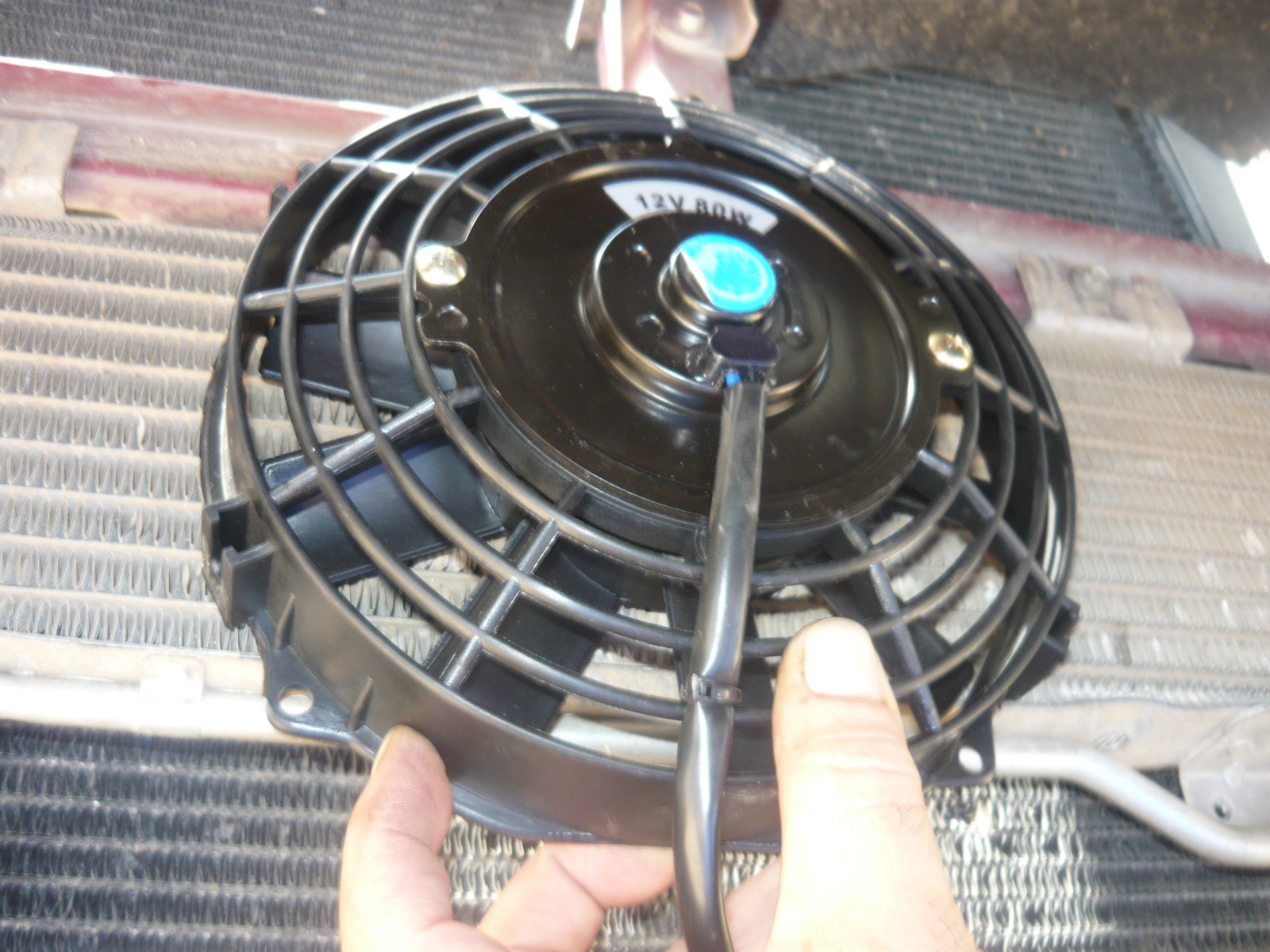

Well, I stuck a fan on there , haven't wired it in though. I think I'll put the switch in the rear parking sensor switch location since the rear sensors are long gone anyway-and it's always lit up saying "off"
Yeah, she's off all right.

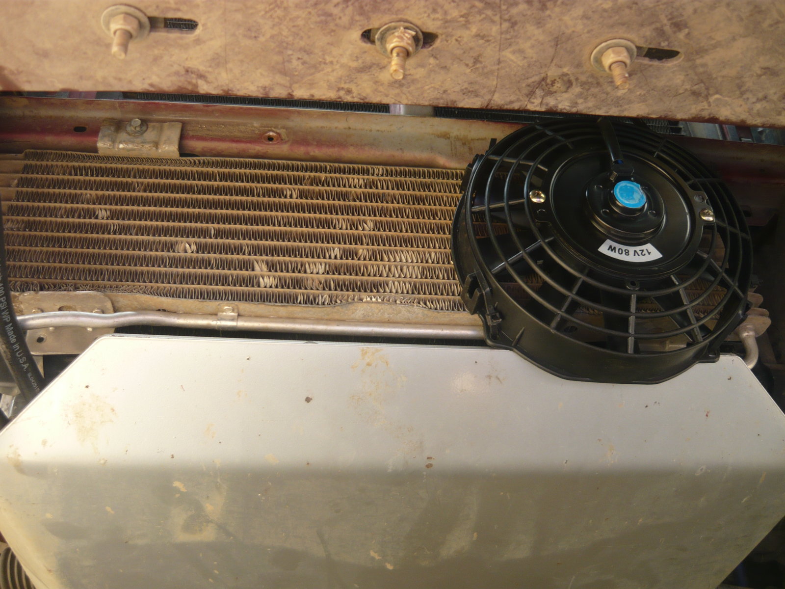

I got real lucky, after fitting the fan I decided to see if the skid plate would still fit. It's so close I could claim I did a lot of measuring and complicated maths
I think the fan is tucked away good enough^^ but if was to cut into the upper tab lip I could move it up a bit.
I will mount it higher when I add another, sooner if I don't .
That's great, it looks like a perfect fit for the space.
It definitely runs cooler with the fans. But mine is sitting above the bumper vents and below the grill. So they help air flow.

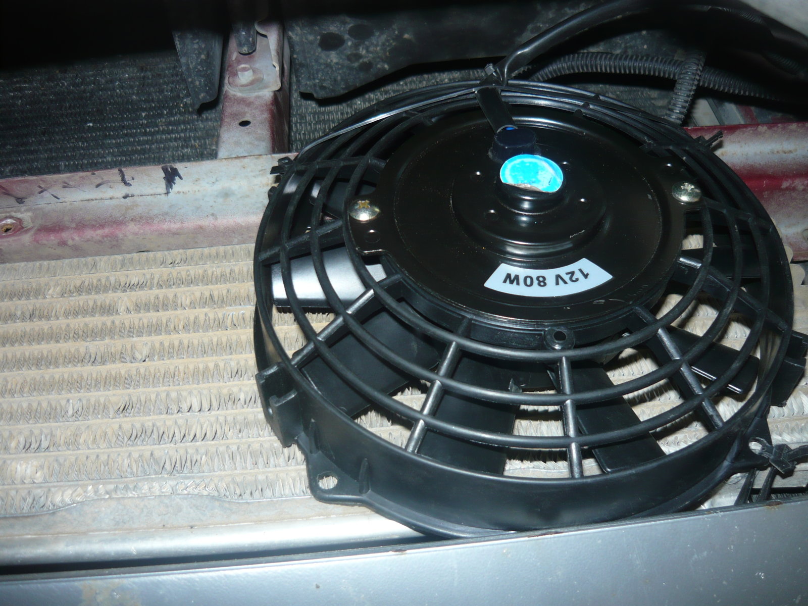

I didn't like the fan mount at all so I trimmed the metal above it to allow a better fitment. There was some fan overhang on top, which I fixed by cutting all the way through on the ends, cut just the lower sheet metal lengthwise and folding the remainder upward. The flap blocks the 1/2" space. Here you can see the ledge that had to be trimmed, but you can't see the flap. Sorry.
It tucked in a lot better now

Well, take a good look.
Today I driveway washed Betty, and since she saves our life every time I try to kill us, this accidentally came out of hiding
Lots of worn out paint but it all got waxed anyway
