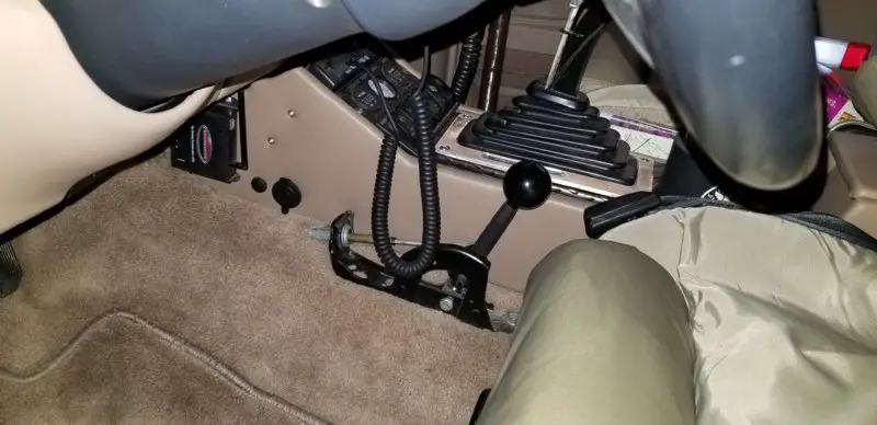

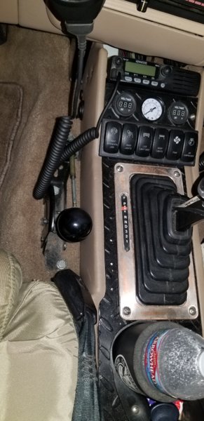

I think Rick has the 4.3, but he also has a manual trans. What diff gears do you have?
One thing I am not a huge fan of is the twin sticks. I am a experienced crawler, and don't understand when you would want one axle in low and one in hi. I totally get why you would want the separate neutrals since I use my TeraFlex 2lo all the time on the trail. Looking at install pictures, I think the twin sticks will fit where I have the cable shifter for my NP231 because the mount is wide. Really don't want to redo my center console yet again.

You can't put one in high, and one in low. It won't allow it.
As far as axle gearing goes that also doesn't really come into play unless your talking a 323 to 513 difference.
The crawl ratio is much higher, but nothing like a doubler with twice or three times the amount. Those that use that setup have a much harder time with brakes holding.

But you can put one in high or low and the other in neutral, correct? Now I have to think about the 3.8 versus 4.3. The Rubicon is a 4.0 and that seems to work fine with auto transmissions. Hmmmmm

Yes. That's correct. Front low only. Rear low only. Rear high only. Or both in low or high. Just can't have front high only.
There is room for the sticks next to the console, but they do go a bit farther than I like. The cable version might be a better option for placement.

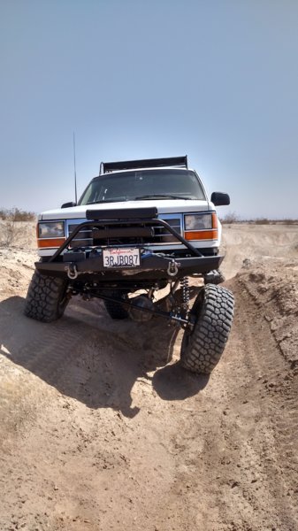

How about we discuss 35" versus 37" tires?
I have been thinking of going to 37" tires for several years. I am not sure if the juice is worth the squeeze. The Explorer takes me nearly everywhere I want it to go in its current set up, and with the mods I am going to do probably this year listed in a previous post, it will be even more capable. The skid plates rarely make contact. Sasha the wonder dog is getting older and already has trouble jumping into the back seat. Larger diameter tires means more strain on the axles. 37's are very cool, but are they worth it?
To get 37" tires under my Explorer would require:
1) Moving the rear axle back 1" for the larger diameter tires to clear the body. 35's rub on the front edge of the rear fender opening when new. Sounds easy, but not. I could take care of it with a custom leaf pack, which I am planning on soon anyway. Would have to modify the driveshaft, but will have to do that with the Atlas install regardless. But, won't moving the rear axle back 1" partially negate the benefit of the larger diameter tires?
2) Explorer will have to be raised about an inch to clear the firewall and front fenders. Easy to do the rear with the new leaf pack and I can adjust the coil overs in the front. But, it will change the drag link and track bar angles, and the caster, and possibly cause binding issues with my front driveshaft at full droop. Will also need to move my bumps down. It will also change the center of gravity, and its very stable in its current configuration. I mean crazy stable, like a weeble wobble.
3) Move the spare tire mount over to clear the right-side tail light, which might not clear the gas can, which would make me redo a bunch of stuff with the rear bumper.
4) New tires and wheels will cost me around $2500.00. I can sell my 35's and wheels for about $1000.
I think I just talked myself out of it, but lets discuss anyways.

Yep, stick with the 35's

I say your good. It just sounds cool, not much difference for a lot of work. You could find some short 37's so you can say you have 37's:D

Are you sure you're not just saying that so you will have bigger tires than me??:)

I was thinking about larger tires the last time I bought new IROKs. I went through the same list you did and wound up just keeping what I had. I have been running 36s.

Sounds like a lot of extra work and $$ for another 1" of tire lift.
If you was having issues on the trails and needing to go bigger because of that, than yeah, it might be worth it. But, since your not........Just stay with the 35's. Bigger isn't always better, especially with a D44.
I would work on getting more articulation over the 37's. Personally, I think the D44 is maxed out with 35's for long term hassle free reliability.
