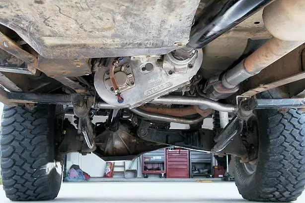

I do have a question for the Atlas II owners. Do they fit between the Explorer frame rails while clocked flat? I got a quote (see below) and the guy said there is a flat rotation option. I would really like that because, well, its flat, out of harm's way, and I wouldn't have to modify my skid plates.

It would fit if there wasn't anything else in the way.
I was able to use the stock T-case skid with no mods to it with it behind the 4.0L/M50D.
I had to lower the mounts at the frame by 3/4" with it behind the 5.0L/4R70w, and that left a 3/8" gap.
I think your better off changing up your rear drive shaft to 1330 or 1350, over the 1310 on the atlas. Your going to be working on it anyways. Just my O2.

Is the camera angle, or is the Atlas still going to be below the frame rails even if clocked flat?It would fit if there wasn't anything else in the way.

Not sure on that. It might be lower, regardless.
The case is massively thick, and can take a beating. Lowering the stock skid covers it well. Just to be safe, I'm welding two stock plates together just because it's cheap.

The bottom of my Explorer is covered with skid plates from in front of the transmission to the gas tank skid plate. They sit about 1" below the frame at the transfer case. Hope they clear.
As far as U-joints go. I have 1310 double cardan's on both drive shafts at the transfer case. OEM Jeep stuff that is very easy to locate.

The bottom of my skid, is 4" below the frame.
The pass side of the case looks to be dead even with the frame.
With it clocked flat, the pass side might drop a little, as it will lower it as the dr side is raised. Won't be much, maybe 1". Just a guess by looking at my setup.
We have diff trans tho, and not sure if there is a height diff at the tail housings.
