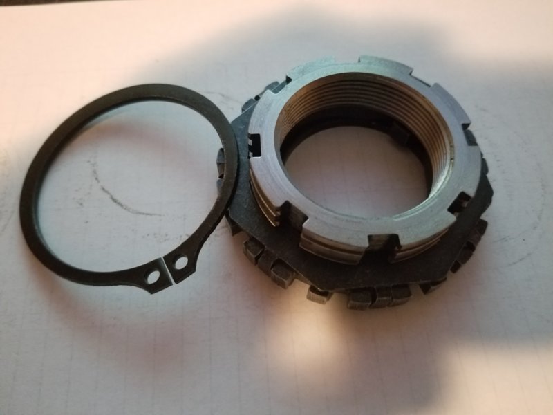

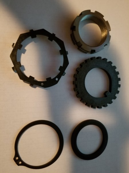

Looking at the Stage 8 kit, I can see why it would be a pain to install, but I like the fact that there is no outer nut that requires 150 pounds of torque. One thing I don't understand is why they machined three snap ring slots into the nut when the inner slot should be all that is needed. I will give them a try. I have pulled the front axle apart maybe 3 times in five years, and as long as I didn't ruin a inner axle seal pulling the shafts, I shouldn't have to get in there for a few years. I also have a pair of long snap ring pliers that will make it easier. I installed the shafts, spindle bushing and spindles this morning. That's all for now.

pics!! I want to see this stage 8 kit and what you are going through here......... pics or it isn't real!!

I'm not going through anything since I haven't even made an attempt at installation. I was wrong about the three snap ring grooves, there are two, so you can start the nut from either side.
Behold

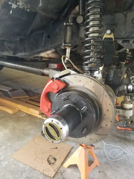

I got both sides finished up today. The Stage 8 bearing nut kit seemed to be very well made and didn't take me any more time than OEM. I had to move the crown nut 3 or 4 times on one side, but it went straight on the other side. Having them means that I have to bring a pair of long nose snap ring pliers along for long distance expedition type trips.
I have basically rebuilt the front axle over the past few months; axle shaft U-joints, ball joints, repacked wheel bearings, new spindles and bushings, new brake pads, new hub seals and fresh diff fluid. Longest job of the day was getting one of the axle shaft end snap rings to seat. 30 minutes of wiggling the lock out and shaft end, and pushing the shaft outward before it finally snapped into place. I'm glad I ordered a new set of the Wild Horses spindle bushings. I tried to knock the bushing out of the damaged spindle and it didn't come out without damaging it. I left the other in the still good, but very old spindle for a spare.

Today while I was putting the front tires back on, I noticed the pre-load on the driver side bearings was loose. One thing I really had down with the OEM bearing nuts was getting the pre-load set right. I have always set bearing pre-load by feel, and this is a whole new learning curve. Mounty, you were right about the crown nut thingie being a pain. I tried every notch combo, then ended up resetting the pre-load on the nut and the crown nut dropped right into place. I had to tap it slightly to get the snap ring to fully seat. I think once I get used to it, it will not be any more of a pain than the OEM nuts. With the Stage 8 system, there doesn't appear to be any way the nut could ever back off.
Now I am wondering if when the washer spun I put too much pre-load on the bearings and damaged them. They looked great so I reused them. I repacked them by hand like I always do, and didn't notice any slop. I will have to keep an eye on that side for a few local trips to make sure.
