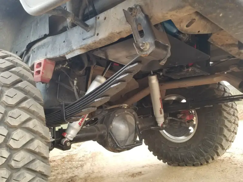

Shock arrived last night so this morning I got to work finishing it up. Its cramped back there with the auxiliary battery, air compressor / tank but everything should clear just fine. If I decide there is too much compression and want to move the shocks outward at the top, I will need to move the air compressor / tank back because it looks like the shock body will hit the end of the tank right before full stuff. If I trim the rearmost cross frame member a little bit in one spot I can do that.
I have the shocks on the 5 out of 9 setting for starters. I think I might go for a drive tomorrow.

Let us know how the test drive is, I have my BII shocks set on 7 in the rear 6 up front....no sway bars, works good. For testing I put them on 1 and then on 9 can totally feel the difference!

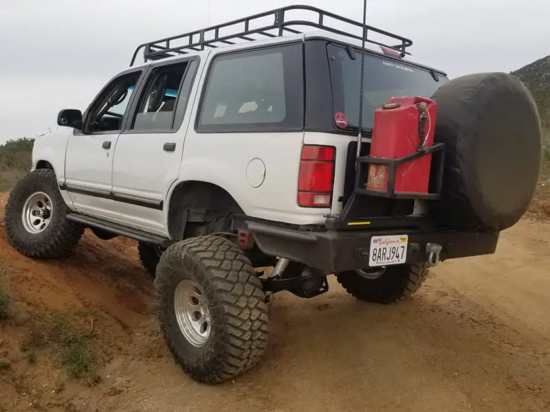

I am also gathering parts to redo my rear bumper gas can and spare tire swing-out carriers. I have a trailer spindle with a bronze bushing instead of wheel bearings. Its hard to move them because I have to tighten them up quite a bit to keep them from having any wiggle. The only good thing about them being so tight is I can open them to wherever I want and they usually stay in place without a locking pin. I have been looking at swing out kits for a while now and keep returning to these Spare Tire Spindle. I am going to wait until Ruffstuff has a sale. I will also need two weld in locking T-pins, but those are all over ebay. I am going to wait until the summertime when I am not using the Explorer as much.
As you stated, the issue with a freely turning hinge is that it won't stay put unless the truck is level. I have a pin to keep mine wide open. At times it can be a pain when I just want it open a small amount.

My James Duff rear bumper uses wheel bearings and it has locking pins that drop down when you get the tire swing fully open.
They are a PITA but it does work well.
Wifes FJ cruiser has a HUGE tire swing and HUGE wheel bearing pivot, the nice thing about her Metaltech rear swing out is it attaches to the stock tailgate with a bar, so when you swing the factory hatch open the tire swing goes with it, the stock FJ shock holds everything open...I wish our Fords had side opening gates for that reason
I saw a BII where the dude put a 37" or larger tire on the tail gate used HUGE hydraulic lift jacks to make the whole thing open and close easily.......something to think about :)

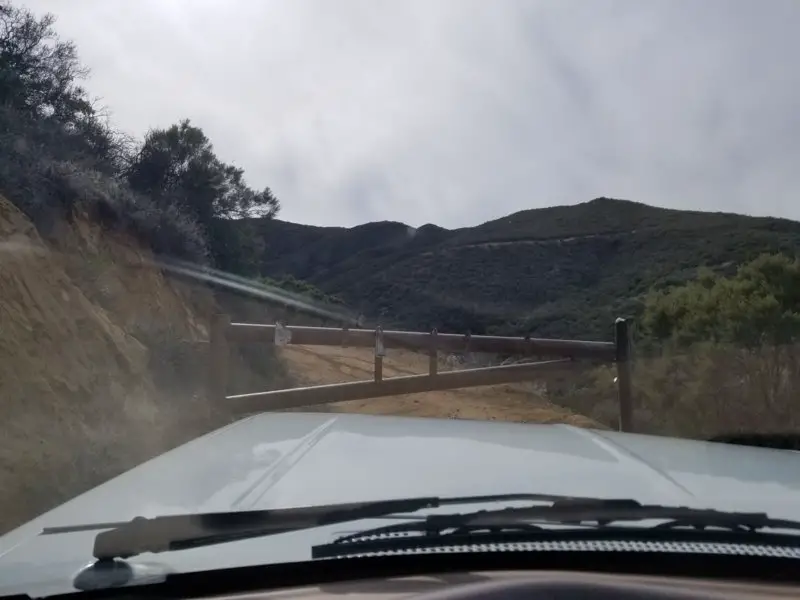

Today what I had planned was canceled, so I went for a drive. I was going to go about 50 miles up I-15, and then take SR-79 to High Point Truck Trail, which is located on the back side of Palomar Mountain. it runs into Palomar Divide Truck Trail in total about 40 miles of mild dirt roads with lots of switch backs and steep grades. Cruised up the 15 at 60-65 with no issues, took a few scenic pictures.
When I a few miles up High Point I found this;
Yes, that's right a locked gate. I back-tracked to the highway. On the way out I was going faster than I usually would and felt the Explorer get slightly airborne a few times while coming off of some large "rolling dips" (angled dips in the roadway to control drainage). It was very smooth. I drove to a more rougher, unused trail that connects with those trails about 20 minutes farther down the road. A few miles up, another locked gate. This trail is rarely used so that one was a surprise.

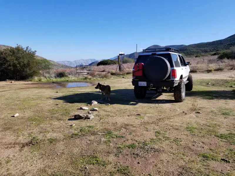

Drove about 10 more minutes once I got back to the highway to the last connector to this trail system and found.....
Another locked gate, what the heck. No reason for this road system to be closed this time of year. Oh well. Now, I'm about 75 miles from home and the only dirt I have seen is the short distance to the locked gates. On the way home, as a afterthought I decided to check out the Black Mountain Truck Trail and Forest Trails. They are located east of Ramona. I should have come in on the east end from Santa Ysabel, but it was a last minute type decision. I drove several miles up into this area. Its very scenic with steep, one lane grades. It was getting late so I didn't take any pictures of the scenery and am going to go up there some time in the near future when I have more time to explore the area. Took a few flex shots when I decided to "check" the rear springs and shocks for clearance issues. Found one minor issue, so that's good. The spring plate on the driver side is contacting the side of the plastic gas tank. I need to cut the corner off of the plate. I always wondered if there was a way to cover that corner of the tank because it seems like its exposed in that location.

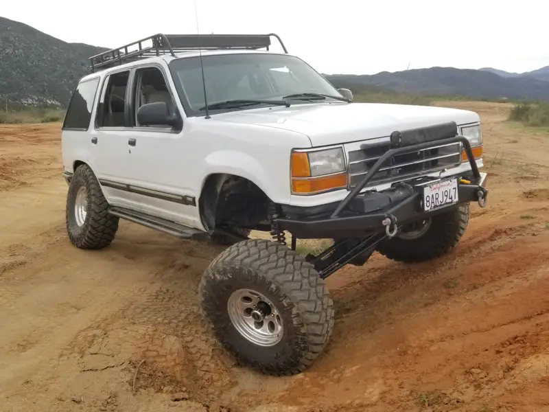

Not really flexed out, but its the best I could do.
Springs are into the bumps and there is still a lot of shock left. Its also much more stable. When at the leaf spring shop they did the fork lift flex test. I noticed the leaf springs went inverted and I have always thought that was not good. The shop owner explained that since these springs don't have much arch on them at ride height, they are going to do that and it won't cause any issues.
I played around with the rear shock settings and ended up on 6 because it removed most of the body roll on the highway and slowed the rebound when the springs unloaded. When crawling, I could see turning them down to 3 or 4. Overall, everything seems to be working very well.

closed and locked gates........sucks
Our taxes paid for those roads....and their gates :(
Those locked gates did piss me off a little. My right to pass on public lands was restricted. I have never been a fan of gates unless they lead into private property.
