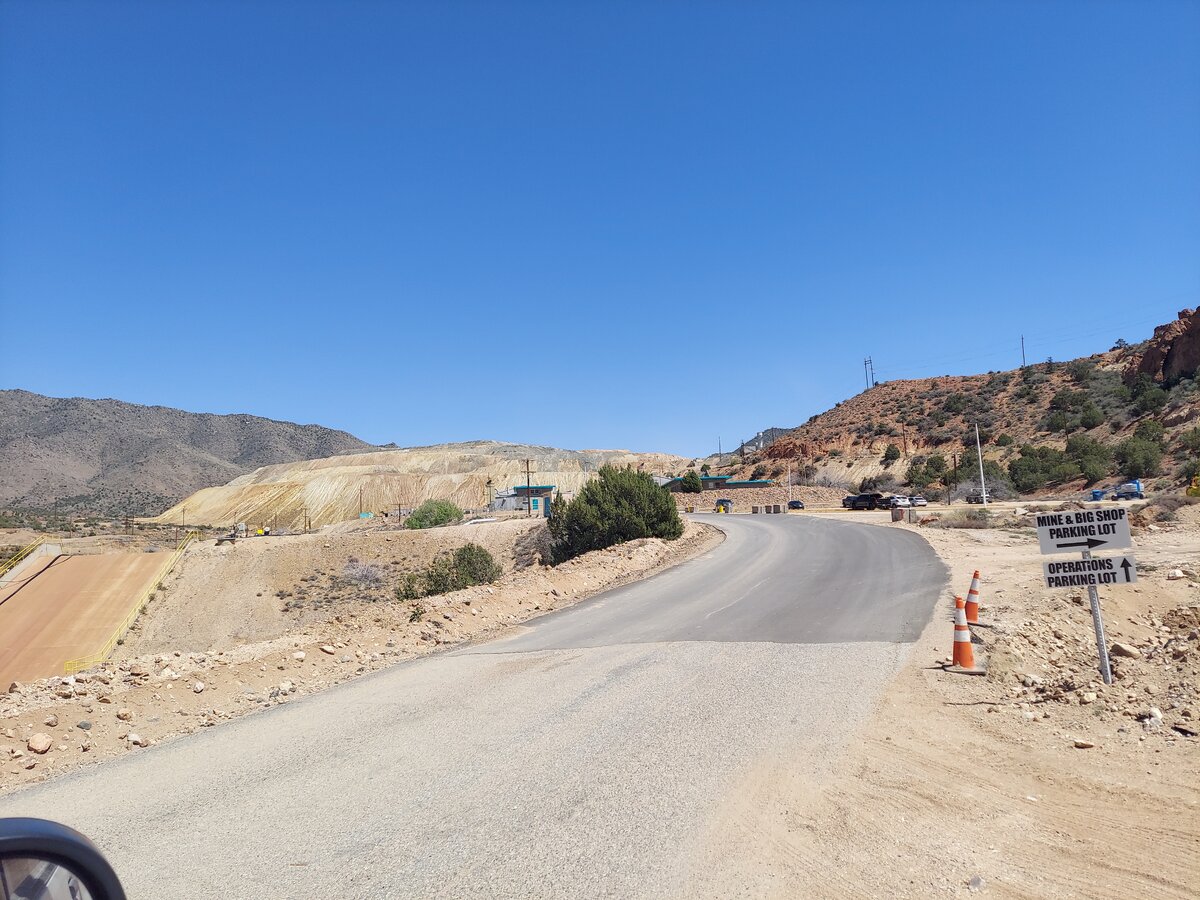

Mineral Park is north of Cerbat. Not much left and not easy to access. Most of the original townsite is under this giant modern mine run by Duval Corp.
This is from the backside of the tailings pile to give you a reference. It's huge.
