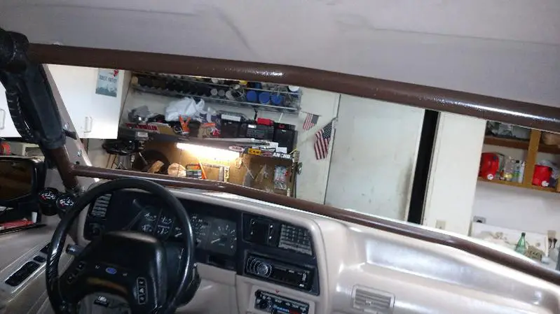

The cage has been in for several years, I was just making it better and got a bunch of ideas in my head. It was made at our cage party so there are a few like it out there. It was made with compromises to keep as much passenger space as possible. For example; B and C pillars are 1-3/4" .120 wall, everything else is all 1-1/2" .120 wall, and it has bends in tubing that most racer guys don't like. It is very sturdy and should function well if the need arises, but if I was racing it, it would have to be a complete do over. I think the worst case scenario for me is getting hit hard on the highway and it overturning at freeway speeds (55-60). I think it will keep the roof off my head.
The floor plates are rectangular with rounded corners, 4x6" or 8" 3/16" plate if I remember correctly.
I have it padded with roll bar foam, and am adding more where I added tube. I regularly bounce my head off the tube above the driver's door so having padding is a must.
Edit: Little cold today for the paint to stick, so its not my best work, but I am going to cover most of it up with padding.

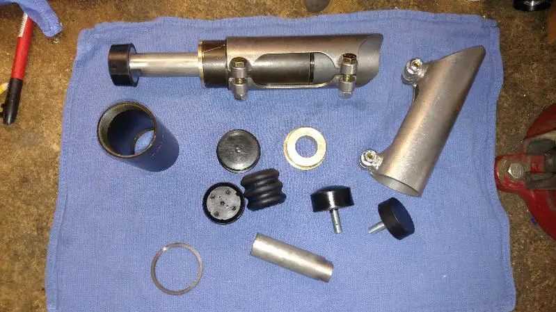

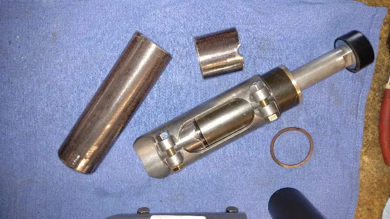

Finally got the Stinger bumps yesterday. Did a little work with them but am trying to figure out how far to mount them off the strike plate. My issue is there is no information on the actual shaft compression. Fully extended, the shaft measures 2.75". The way they are set up is with the bump body empty, the shaft will fully compress, but takes up all the space inside the body. With two foam inserts, there is actually a little pre-load on the shaft and a wrench is required to seat the threaded end cap. There is no way the inserts would compress completely flat. But the question is, where do they stop? I sent an email to Daystar, but it took a week for them to get back to my vendor when he asked when I should expect them, so I am not holding my breath.
Another issue is the short version I got due to shaft length are real short. You can see in the picture below I made up spacers to go above the bumps so the upper pinch bolts won't deform the cans. The longer tubing is to be used in place of the actual bumps while welding.
I was thinking I might remove the snap ring that is used as a stop for the bump bodies and push them into the cans another 3/4" so they are mounted nearly flush with the bottom of the can. Then, both pinch bolts will engage the bump body. I can cut a split in the spacers, then tack weld them to the top of the cans to do double duty as spacers and stops. I can get a tack weld in a location that will be easy to cut off if I ever want to change out the Stingers for gas bumps. The only issue I can see is I won't be able to remove the bumps from the top of the cans, but would have jack up the suspension until I could pull them out from the bottom.
Edit: the only reference to shaft length I could find after an hour of searching was a review on Amazon. Said the overall length compressed with one firm and one medium insert was 6.5", which would mean there was one full inch of shaft showing at full compression.

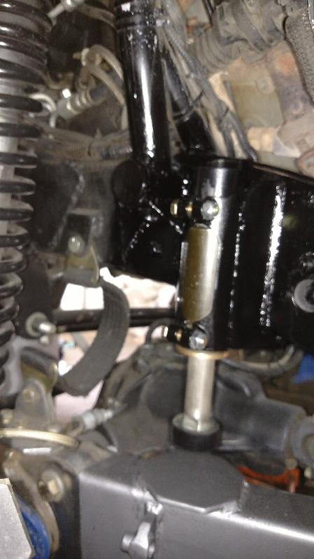

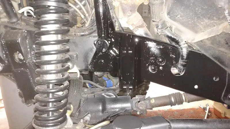

Got the driver side bump can in today. It was going to be the hardest to place because the rear coil over shock tube is 1-1/2" further back on the frame. I added a strike plate on top of the already beefy radius arms upon the advice of a racer guy who bends tubing for me. He says the pads on the race trucks get dented over time unless they are at least 3/8" plate. 1/4" X 2 should be fine.
Pre cleaned up with the bump in place.
Cleaned up and painted.
I was going to weld a small gusset into the space between the coil over shock tube and the can above the gussets already in place. Then decided the difficulty in welding in such a small piece was unnecessary and even too much overkill for me. The can is welded to the coil over shock gusset and where it meets the frame on the rear side, then I welded the gussets over that, so I think its good.

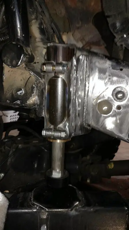

When I get to the passenger side, I should be able to gusset it completely down both sides as it will not be so close to the coil over shock tube.
Got most of the passenger side done today before the wife came home. Need to cut out the gussets, weld, clean it up and paint. Also am welding a plate over those three holes in the frame towards the firewall I never liked. Something about their triangle shape says failure point. Don't remember what they were used for, except the lower hole. It was for the stock radius arm.
Pic of the driver side with bump mounted.
