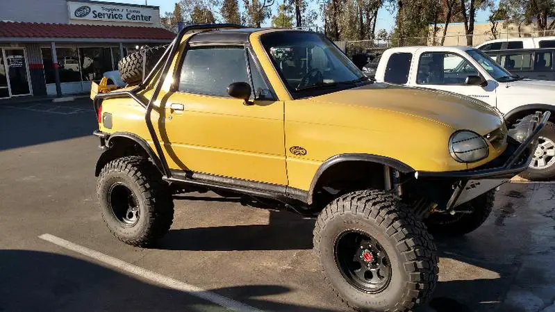

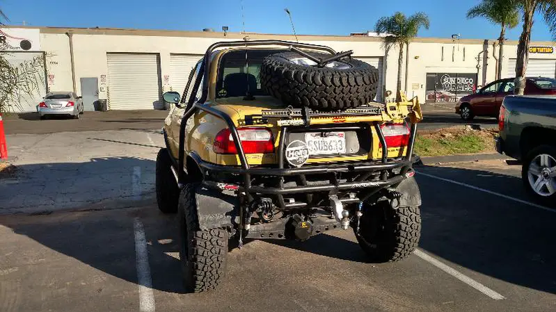

Anybody know what this is (make, model, etc.)? I saw it at the shop that bends tubing for me.
I thought it was kind of cool, and its really well built.

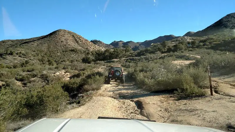

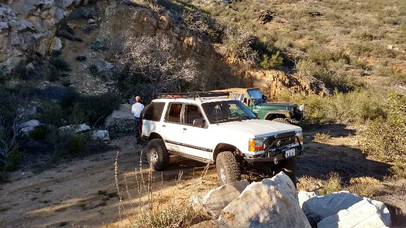

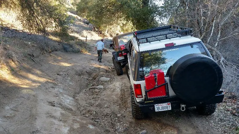

Spent the day in the back country prospecting and off roading with Mike and his Green Machine. It was a very good day for both.
Entrance to trails.
It was a whole new to me bunch of trails. I was surprised there was somewhere in SD County that I haven't been. A few moderate, mostly technical trails, but all pretty overgrown with pinstriping brush.

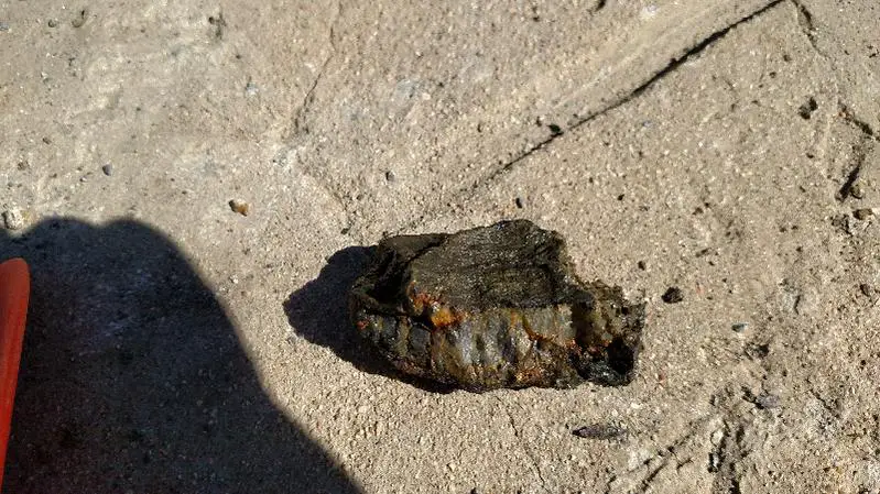

Never actually seen gold in rock before. We picked up two buckets of this stuff. We also found a dry stream bed toward the end of the day, and got a bunch of small flakes in one spot under some rock. Cleaned it out and covered up our work for a return visit because the entire stream bed looks promising. It's hard to get to and seems rarely visited. There were several abandoned mines that dumped their tailings in that stream bed.
Poser shot on old foundation
