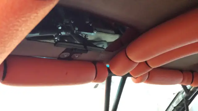

Visor road test showed they do not seem to reflect light or vibrate so as to be annoying. Good to go.
I'm officially a copycat ;)

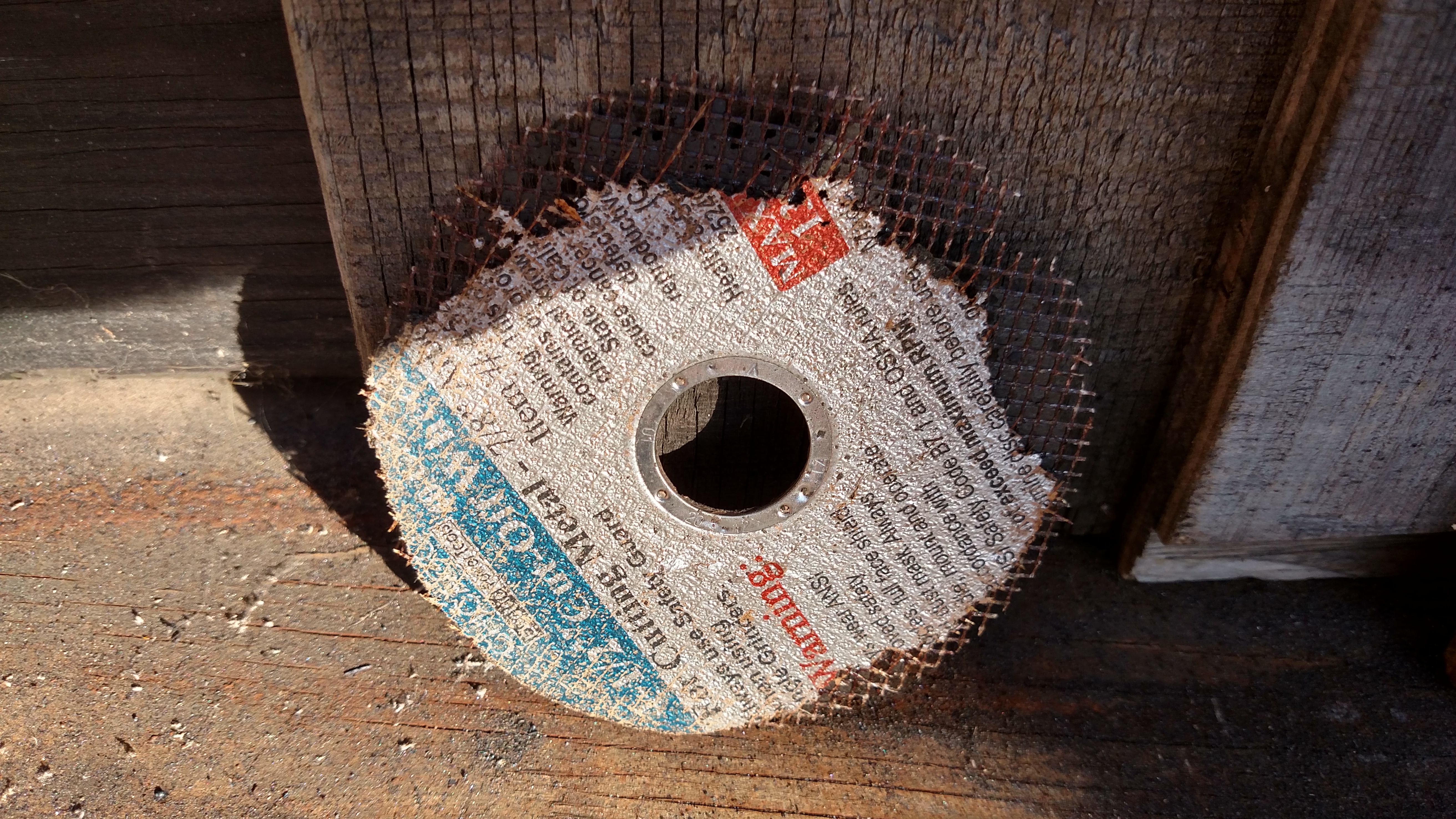

This is not due to my build, but its related so I am posting.
Wear Safety Glasses!!!!
I am building some gate hinges because I did not like anything locally. I was using a 4.5" angle grinder with a cut off disk. I was running low, so I used my last resort box of Harbor Freight cut off wheels. One exploded, and a piece hit me right in the safety glasses. The piece then took a chunk of skin off my nose, and forehead. I felt a forceful impact, and then my face was wet with red stuff dripping on the concrete. I thought I was in serious trouble after seeing a few pictures of cut off wheels imbedded in peoples faces, but my safety glasses saved the day. They have a bunch of gouges in them, but did their job. I washed my face off, a couple of big band aids, and back to work.

Dang glad the safety glasses did their job!
