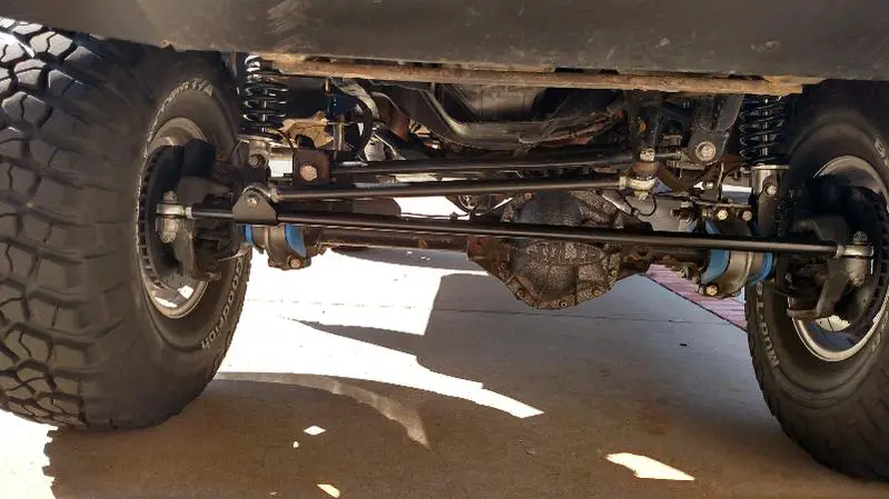

Should be getting my tie rod back tomorrow. The machine shop that straightened it says you can't tell it was bent. The delay was because he did not charge me and put the paying jobs first. He says it should not bend in the same spot, unless I park it on a rock again.

Got the steering back together. 1/8"-1/4" toe in, good to go.

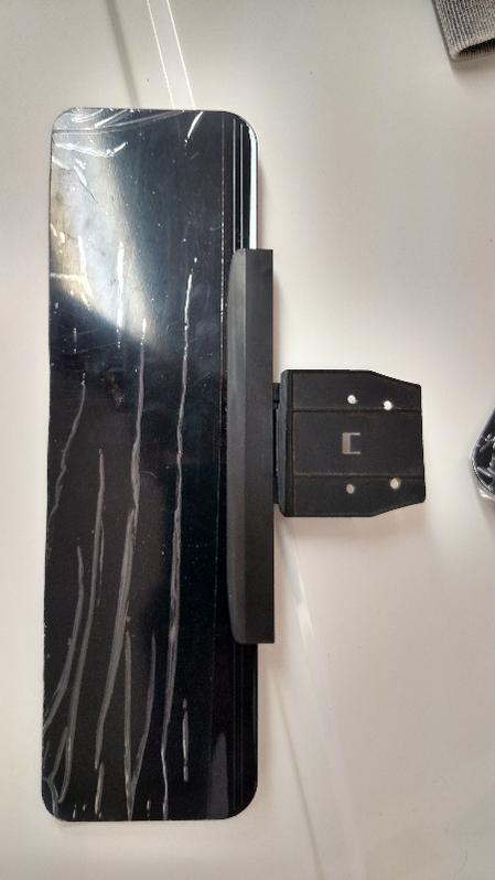

Wife was complaining about no sun visors on the last trip. They were removed to properly place the cage windshield cross tube. I ordered these universal visors off eBay for $14 for both. They are supposed to attach to the existing visor.
A little trimming turned them into sun visors that won't get in my way, and seem to do the trick. No vanity mirrors though, sorry.
Need to run to the hardware store for some longer self-tapping screws to install. I can screw them through the headliner and into the roof support behind the windshield. Will post a completed pic when finished. It should also help keep the headliner in place. It's been abused and is getting old.

Straight tie rod.
Never sleeved it, if it gets bent again I will have to figure something out.
So what's the trick to adjusting heim steering so the heims line up? I tried wrenches at both ends, shoving metal in between the heim and mounts, they still shift at the last second. End up saying close is good enough every time I mess with them.
New sun visors installed. They should work out nicely.

I guess I've been lucky with my heims, normally they line up without too much trouble.

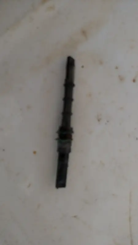

Spent several hours today changing out the AC systems compressor, drier and orifice. Took longer to get the orifice out and flush the system than anything else. Orifice was a little dirty and I had to use a curved pick to get it out of the tube:
Will get it evacuated and charged next week. Giving the AC system one more chance.
