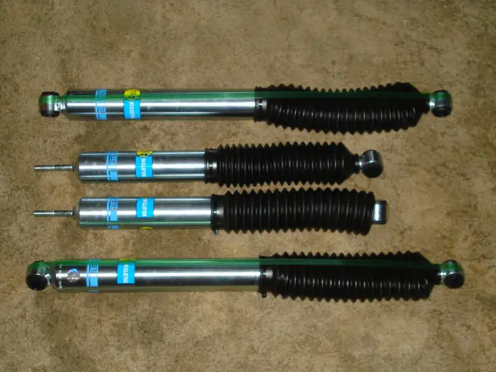

So after finally having the time to replace my worn out shocks with my pretty new ones, I quickly came to the conclusion that it wasn't worth trying to forces the old bar pins out of the Ranchos for use on the new Bilsteins.
Thanks to some searching and a post by zhanx, I've ordered a set of JKS bar pin eliminators to make the job easier. Now I just have to wait another week to finish the swap.

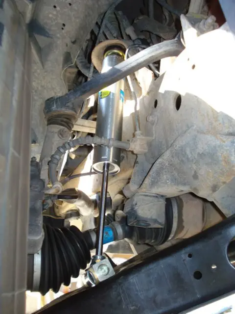

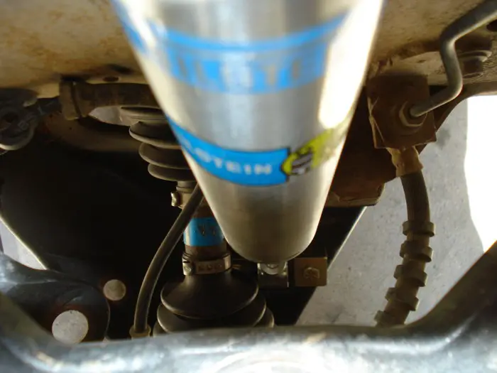

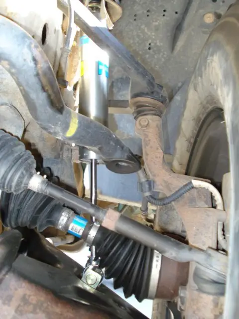

I finally got the front two shocks installed today.
It was a definite pain in the butt to drill out the holes in the BPE's so they would fit right, and as expected the clearance with the CV boots is pretty tight.
Overall I'm very happy with the way they turned out, and ride.
