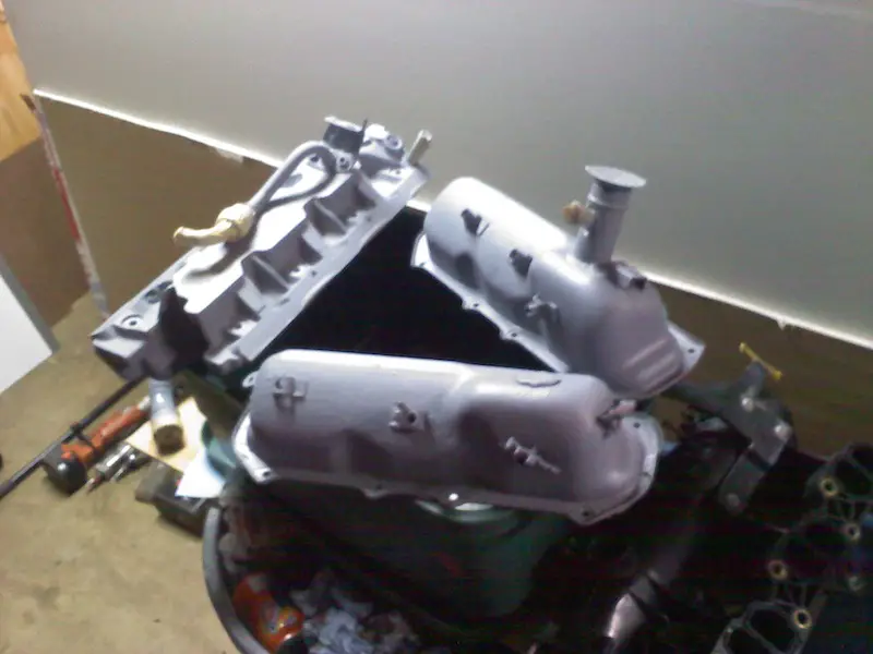

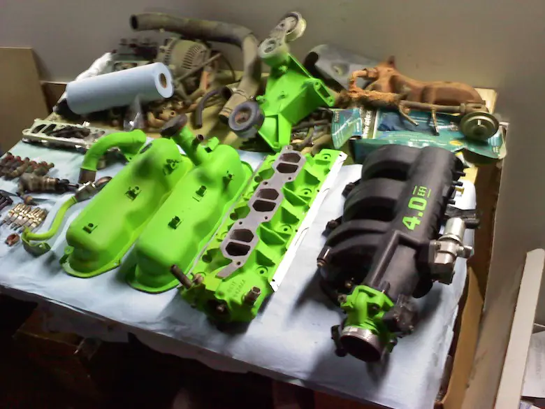

Got all my stuff painted tonight..
The machine shop still hasn't picked up a new head for me to replace the one they cracked.. yeah.. they cracked it. Just goes to show how much Porting/Polishing is going on!! :p:
Yes I realize the tensioner isn't painted.. that one has about 1/8th of play in it and the bearing sounds like a dying cow.. it's going to get replaced here soon.

Lookin good! What paint did you use?
I tried a few techniques on the other set of valve covers I had.. but this one seemed to work the best:
- Cleaned/acetoned them and let them dry in front of a heater for 15mins
- Sprayed a light base of Dupli-Color's 500 degree Ceramic Primer then heat gunned it
- Sprayed another layer of Primer and then let sit near the heater for 15mins
- Sprayed a light coat of Dupli-Color's 500 degree Ceramic Mopar Green then heat gunned it
- Sprayed another layer of Mopar Green and then let it sit near the heater for 15mins
- Sprayed a light coat of Rustoleum's Fluorescent Yellow then heat gunned it
- Sprayed another light coat of Fluorescent Yellow then heat gunned it until I could handle them
I'm talkin LIGHT coats on each one, especially the Mopar Green
As I finished each layer on each part I let them sit in front of a propane heater, after I finished them with the yellow and they were drying I SWEAR every time I looked over they just kept getting brighter and brighter.. Can't wait to see what they look like today!
Rusto makes a high temp high gloss clear.i used it over everthing,protects the paint,makes it shine like crazy and anything that gets on it just washes right off.
Got mine at autozone.it really made a difference
Going to have to try painting some things using your technique Brandon-Looks great!
