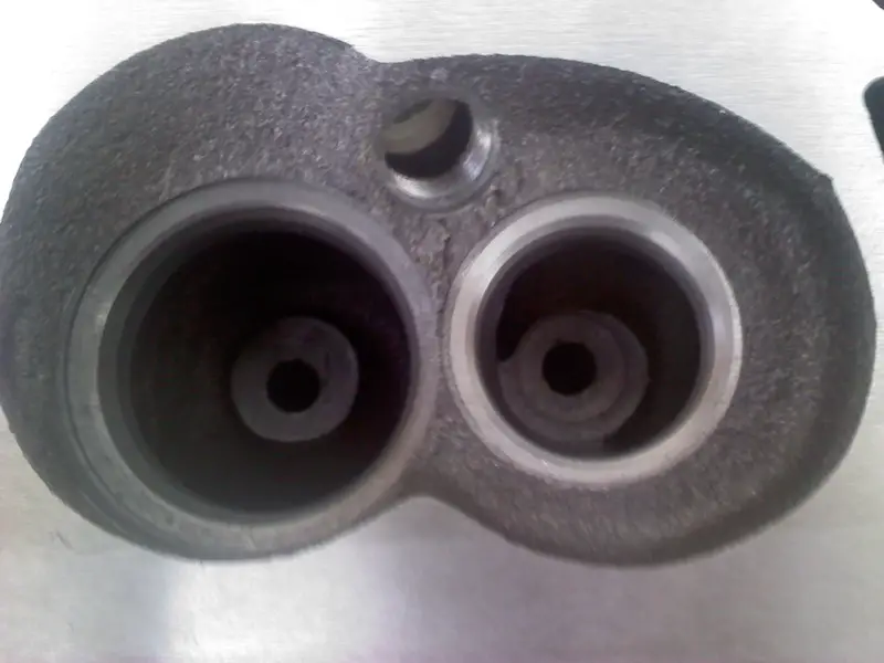

OKAY. So the head I bought off ebay is a no go. The intake valve guides are not perpendicular to each other and are off by almost .1 (read one tenth) an inch, .079 to be exact. Therefor, probably the valvetrain? (valves, guides and rocker arms) would be destroyed in less that 1,000 miles.
Alabama heads only offer the 98TM casting style, they however did NOT change the exhaust ports like other aftermarket companies did. I really don't want to have to go through getting a brand new set of 98TM's and on top of that having to get a TON of exhaust work done on each when I could just get 1 new/used 95TM and have it matched to the one I have already completed.
Looks like I'm off to track down another 95TM, these things are hard to come by! Amazingly enough all the Explorers on craigslist / in the junkyard around here are SOHC's and V8's :(. If anyone has or knows about a set please let me know..
I called the place in WV that you linked there ranger7ltr, they should be giving me a call back sometime later today.. hopefully with good news!
You can kinda see how off they are; look at the gaps between the two valve openings. It's worse on the top side but I can't get a good picture of the differences.
This is starting to turn into a pretty decent headache!

Yeah, as of right now I'd say definitely pass on ModernEngine. Though the guy I spoke to on the phone really busted his butt to get me this one.. customer service is good. We'll see what they have to say when I call him, gotta wait till all the Californians wake up though, lol!
Man that sucks!!might have to suck it up and go with EQ!
I've been on the phone with Modern Engine Inc. off and on all day today.. this is the first they've heard of this problem and they've actually been really pleasant to talk to!
They've never heard of this happening before so they're looking into it with their casting company as well as their personal machine shop, and they're in contact with my guy about what has happened. Holy crap these guys are serious about their stuff!! :thumbsup:!!!!
