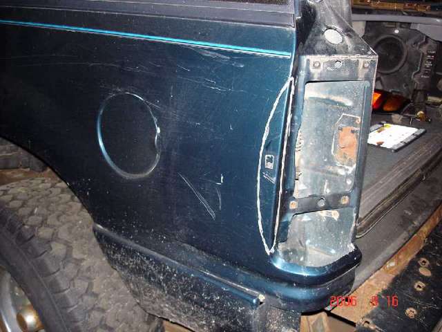

I've got a 94 Limited... and wanted to install newer taillights (95-97) but as we all know those taillights are a bit different and are not a direct fit. I've seen people do it though but they would modify taillights to fit into square openings... I've decided to modify quarter panels since I was going to do a bit of painting anyway... here are some pictures of the process... next - fiberglass to finish and new paint. Will post pictures of the process...

It looks good even without the fiberglass... all I need is some kind of plastic edge that I can slip onto the cut area and voila! I'm done... maybe not! I might want to play with fiberglass and then paint. It would look as it came this way from the factory... as for euro spec headlights... those are Cibie lenses... problem is I still need another one... on it's way.

Euro spec headlights? from Europe, naturally! cost? about $125.00 each shipped. Wiring is a bit different since they use H4 bulbs and have parking light inside the headlight... turn signal is just turn signal, that's all. I could of kept it the US way but decided to just go for the Euro spec all the way.
Taillights... you'll need to get complete tails with sockets and wiring loom, at least enough to get you inside the rear quarter panels in order to splice wires. You will also need to run an extra wire for brake lights... yes, not turn signals but brake lights. After looking at the wiring diagram I figured that all I had to do was to cut one wire and run one end of it to the back to seperate brake lights from turn signals... simple thing. And I'm not loosing hazard flashers...
Besides cutting the outer rear quarter panels I didn't do anything. Insides work good with a little bit of help from a hammer... not too much though since it also stiffens the sides of the quarter panel. I should get some pictures of the set-up as I got it (taillights with wires) and sketch of where to cut. I used my angle grinder... cut-off tool would of been better as it has a smaller diameter cutting wheel. Also a trick of where to cut the wire for brake lights. More tomorrow...

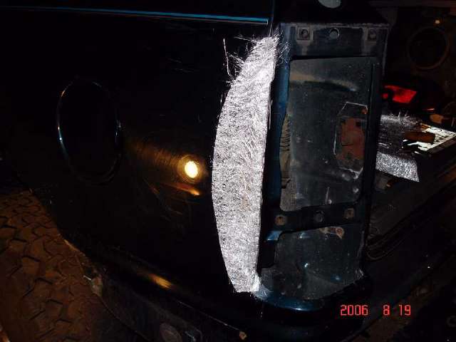

Screwed-up last night... I did manage to cut a fiberglass patch and put it on... didn't realize that my resin hardener is already past it's life expectancy. Found out this morning that resin on the car is still wet... :mad:
now after removing most of the crap off my truck I need to find a way to clean it up and start from the beginning... did manage to take some more photos though... will post later. It's coming along... just don't have enough time.
Here we go... a little update. New fiberglass piece is on and dry... the other side calls!
Looks good. I would have just gotten door trim molding from autozone or something and lined that edge. Too much work into a wheeler ;) Really like those headlights. Now, find some EB axles and get it done!
