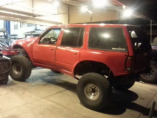

Well im starting to source parts and gather up some good stuff. I figured id start a thread just to show everyone that the ideas are. Should be a pretty fun setup when done. Everything will be being built by Brandon at BTF Fab.
The rear will be a 4 link with a panhard bar and cantilever coilovers. Shooting for around 20" of rear travel. Full size van 9", and should be around 3.5" wider per side than stock
Front will be a BTF front setup more than likely with a fully fabbed spindle with d44 hubs and uniball upper and lowers. Should pull around 16-17" of travel. Will be around 5" wider a side than stock.
It will be a fairly slow build due to finances. It will be built in stages obviously and should take around 12-16 months to be fully complete.

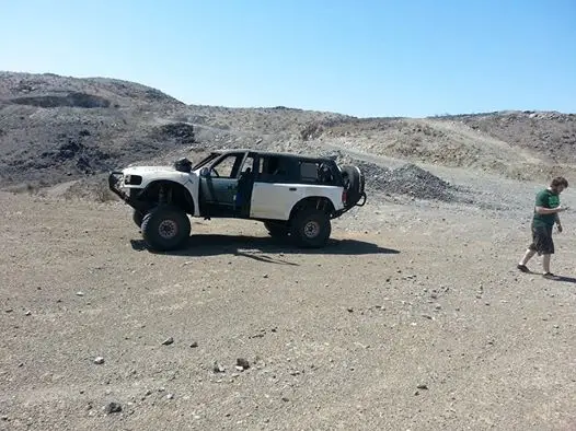

It saw some dirt for the first time in 2 years.
loaded and ready
blown heater hose was only issue of the day.
