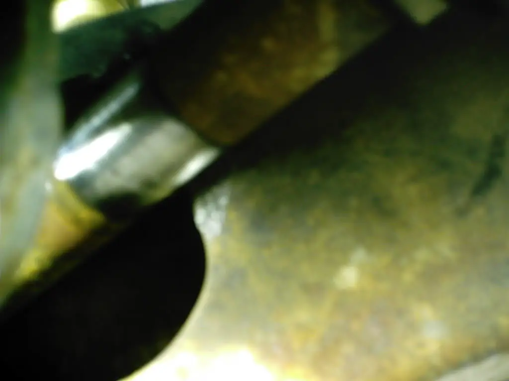

and then i found this..........
it been doing this for awhile but did not realize how bad it was getting. It actually wearing a groove in the axle.:( Now to figure out what to do about it.
grind out the hole. enlarge the window. the opening the axle goes through. take a cut off wheel to it and trim it back and down. its something you gotta do if your getting good travel out of a ttb :thumbsup:

I'd eyeball a few things and maybe even measure your wheelbase on both sides. It shouldn't be rubbing that high up on the window. It's making me think you may have a bent beam or bracket
I clearanced mine at the bottom inner corner and was good to go. you can see a faint outline on my axle and that was it.
i doubt cyber has anything broken or bent. good idea to look though. danny your kit probably deasont rub as much cause its a very well thought out "kit", cyber just has a drop bracket kit which i think would cause more rubbing. and i think autofab already clearances the houseing a little bit.
