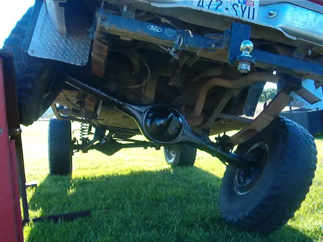

Looking good. Got a question for you. How much space is there from the diff housing to the engine mount xmember? Looks in the pic like its going to hit.
Of the two vertical portions of the engine crossmember only the one in the rear is a problem. as it is there is about 1 1/2" of clearance. I will be bringing the torch out this weekend and making some room there. I will also be adding a bump stop.

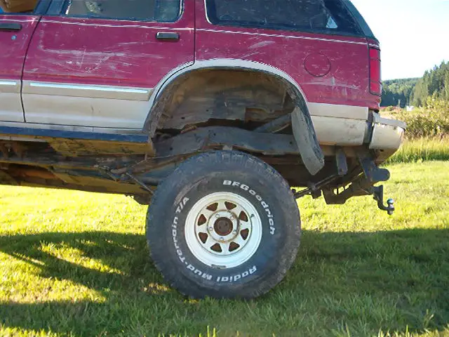

A few rear flex pics.I will have to install bumpstops in the rear,
Those are tired 35's
I still have a few things to do before I am ready for the road.
I am pretty much done with all the big stuff not it is time to fix the small things.

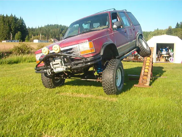

here is a few more pictures from today
It is ramping close to what I did before with my TTB setup.

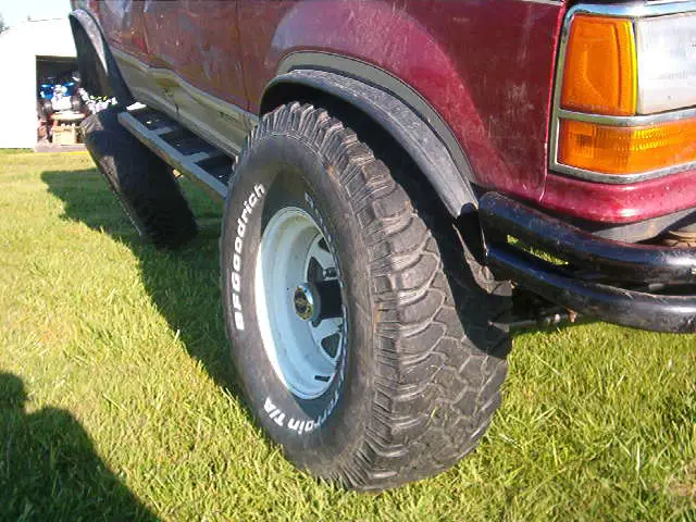

looks good. what tires are you getting next? looks like they are shot.
Because I am wanting to keep my CG low and the worn out 35's fit so well in the fenderwells that I thought about just running my almost new 33's BFG MT, they are very close to the same size as the tired 35's.
Should I buy brand new tires they will be swamper IROKS :thumbsup:

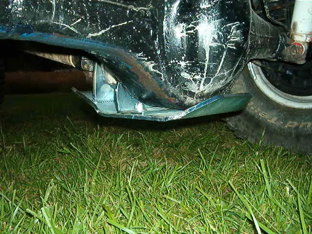

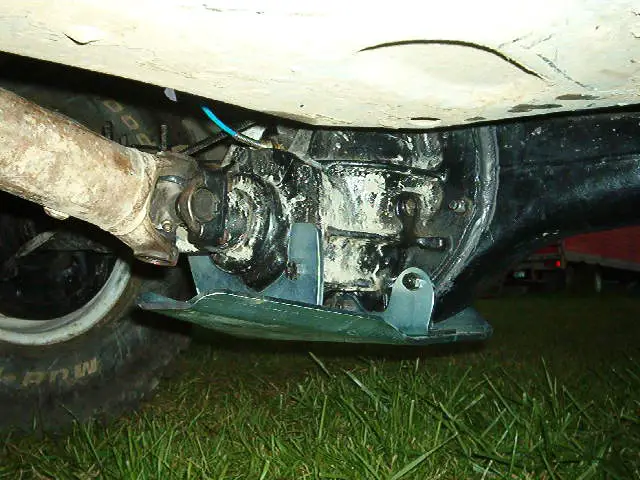

Got the rear gears gears finally broke in and fluid changed and operated the rear locker for the first time, man that is next haven the locker on a switch :D I also installed a James Duff skid plate on the 9" that thing is stout!
