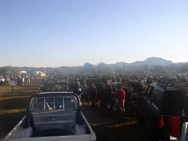

I have been out 3 times plus the two runs at Desert Splash. The Explorer has performed great. I plan on starting a thread to fill everyone in, however 13 hour days and a house remodel is taking a toll.
I dont have hardly any pics as I rode solo, Matts girlfriend and Sams wife have several pics and I will get them soon.
Here is my picture of Saturdays staging area before we headed out.
