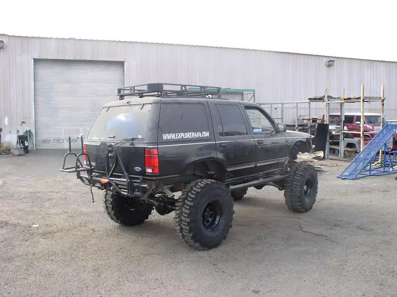

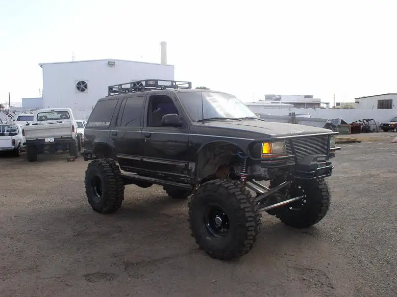

Finished up a few things over the weekend, and we drove it around!!!!
Its only running with the exhaust to the Y pipe and then its all open. It has no power :(
Hopefully the motor needs some back pressure to run correctly.
I ramped it and found a ton of areas that need trimming.
I also need motor and trans mounts so I replaced those today and took these shots
Ramped it but only till I heard the driveshaft hit or the track bar rub.
I have a few more ods and ends then I will give it the full stretch
Not sure if you started it up once in a while, while it was in the garage, but when took my truck off the road this summer for a few months and then went to start it back up it was bogging down a lot and misfiring (4.0 ohv too). However, after a few days of driving on it it was back to normal. I figure it just had to clean itself out some. Maybe it could use an oil change?
He changed it already. Man that thing is massive yet beautiful.
Words can't express the amount of my jealousy. :p That thing is awesome. Can't wait to see some true action shots. :cool:
i bet HE cant wait (forget us...lol) to get into a situation where action shots are necessary ;)
that's sick!!
Yeah, that front doesn't look like it's stuffing as well as it could, but you said you stopped when you heard something hit. For God's sake wash off that dust! :p Looks real good.
:thumbsup: :bounce:
It's a sight for sore eyes!!
