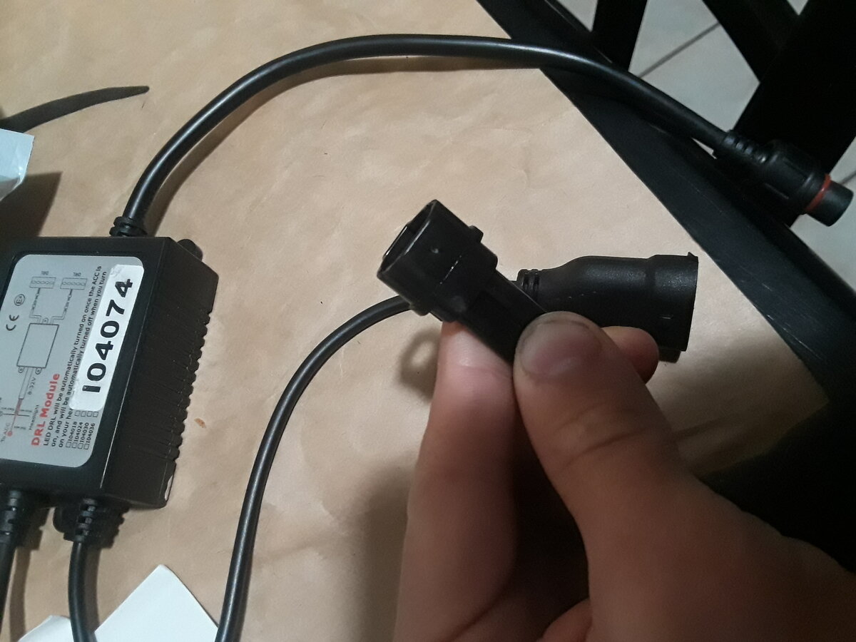

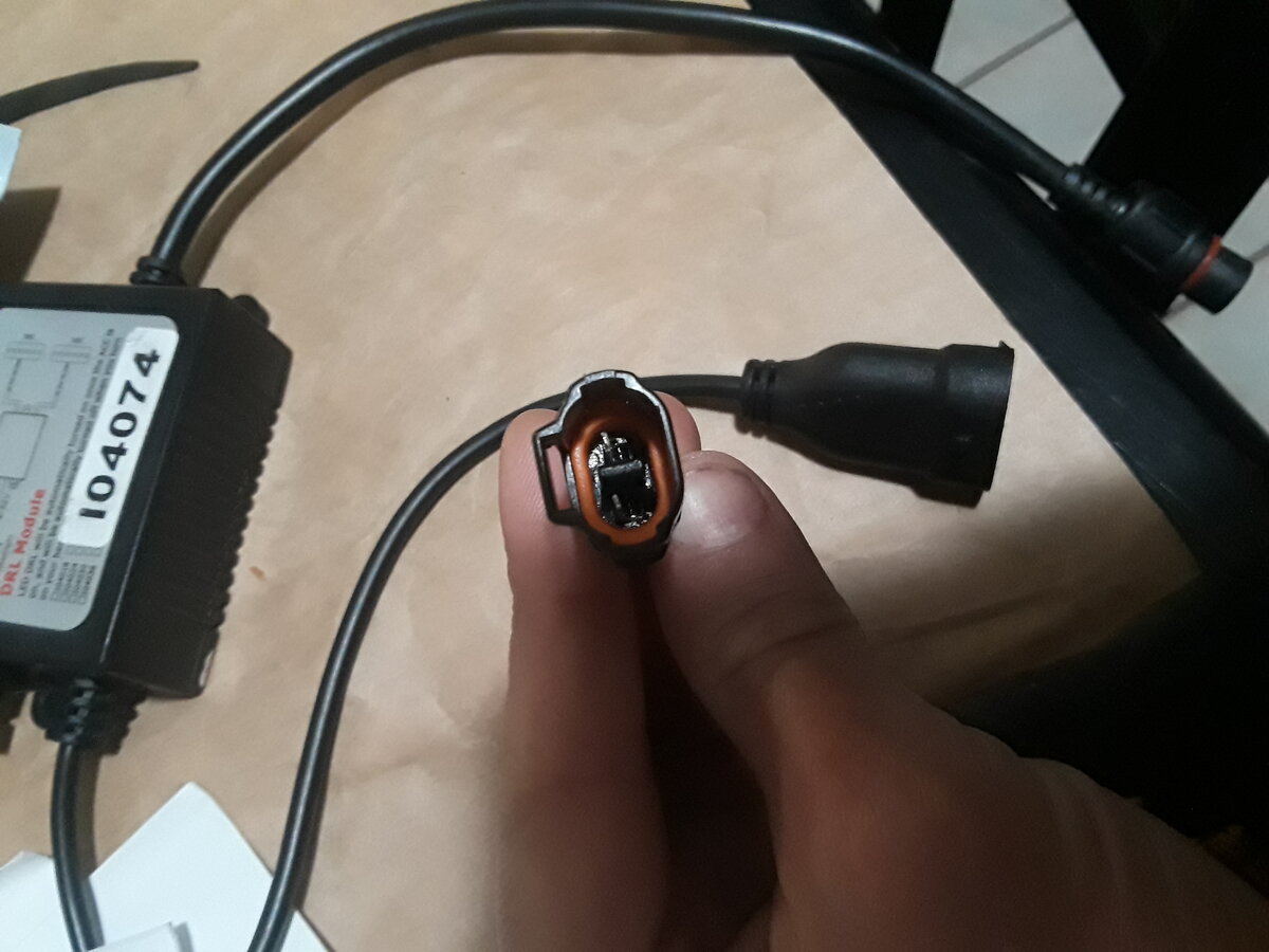

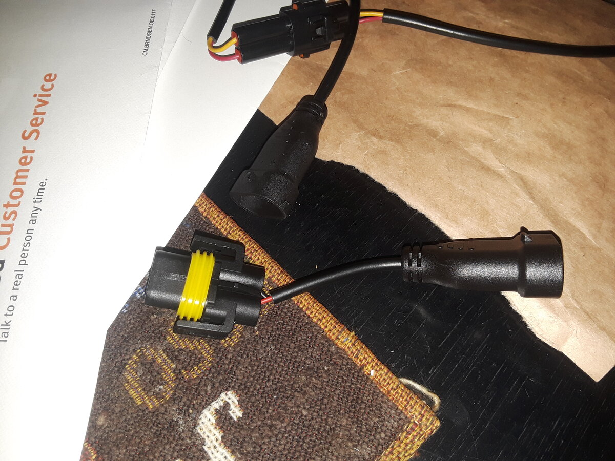

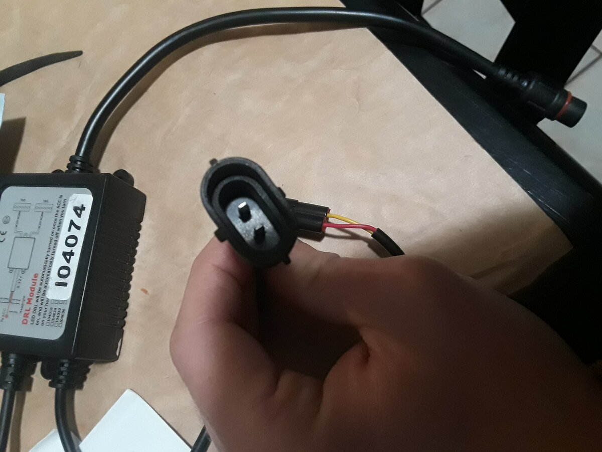

Cannot figure out the DRLs to save my life. Thought maybe the yellow is a switched ground, tried that and nothing still, the fogs work, DRLs we're at a loss for.
Looking at the Vinstar diagram - looks like you don't use the existing DRL power from the harness, just powered from any ACC-On power?
This is what I mean, the connectors between the oem and the aftermarket ones are different styles. The diagram is the start of the new ones. They won't connect to the factory harness, meaning I can't use the foglight switch, which is exactly what I need. The wider connector is the factory harness, the smaller one is for connecting the harness between both fogs for the daytime running lights. Theres a long harness between the two to hook up the daytime running lights via one ground and one positive with an inline fuse with the end connector. Theres also some small extension bits for the "supposed" to attach to the factory harness. Also, tested them, they work when given power. The daytime running lights do not, so we were thinking maybe it's a common ground between them and the fog, so if those aren't ground then it won't come on, but then I'm not sure what the yellow wire is. Unless the yellow is a second positive for connecting a switch, just without a fuse like the other two had, but if that were the case, the red would be useless. I'm started to see why I put this project off again, pita of a project. They came with zero instructions than what's shown on that diagram which is backwards on the box

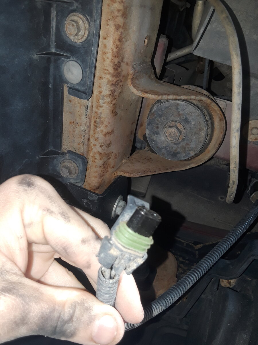

I think I know what you are doing there now. The factory fog lights have the short wiring section to connect the lights to the vehicle harness. You should be able to use that as an adapter harness, cut off the front connector and solder the new light pigtail onto that. They sent that short pigtail yes? Just change the factory connector there, and then it plugs in, those come with weather seals right?
That's the same as doing a radio, wiring in the adapter of the HU, with a vehicle adapter harness you buy, to make one adapter harness which connects the two.
This little one came with it, yes, but it's more of an extension since it's literally the same end as the previous onces you attach it. The freaking radio was easy, this is ridiculous!

Does that diagram on the Vinstar not show it just getting ACC power to the DRL LED's? Then the White taps the headlight power to cancel/trigger the DRL's to turn off.
Figured it out. The connections are all fine, need to just hook up the old connector to this new one for the fogs to mount to the factory one. But the red wire supplies the power for the DRLs, which would mean hooking them into the factory DRLs on the switch. So like the headlight halos, turn the headlight switch once and the halos and other running lights come on, turn it again, them and the headlights and DRLs come on. So that's what I need to do for the red, yellow I can cap off, it's just used to switch the DRLs off when the fogs themselves come on, which I don't really want/need to have happen. So once I setup the modified new pigtail, should work fine, especially when I figure out where the wiring is for the factory trucks DRLs.

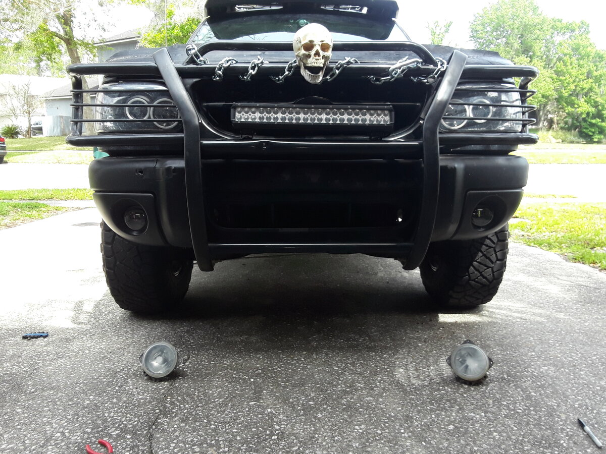

Suggestions for the other green grille leds? It was a 10 pack and I only used 4, dad was thinking rear shock lights, I was thinking running boards or both. Other places that would work well, or think either of those are a better choice? If not the running boards, only the shocks, then that still leaves four to use somewhere, I want to hear some creativity! Hate to leave them sitting around, while y'all give that some thought, I'm going to start taking measurements and cutting up some metal to makeshift brackets for the fogs

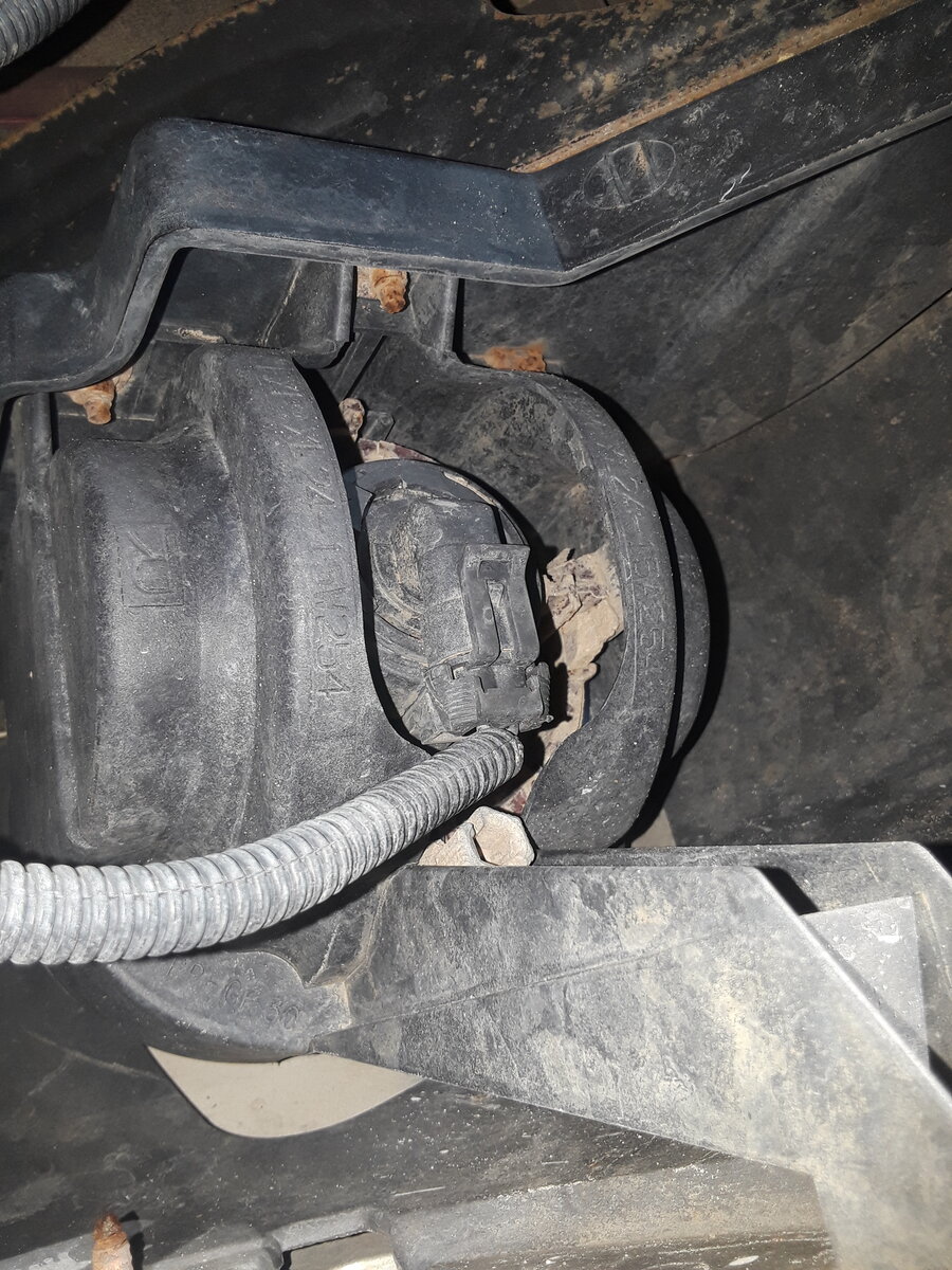

I do apologize for sending so much lately, been trying to get as much as possible done in my two days off. Working on making brackets to hook the fogs to the factory screws, decided to sling a hunk of metal at my hand while I was at it. But they're all four cut, have to cut a bit out of the center of each for the rounded mounts of the fogs, so that's going to be fun, ones almost halfway done with that, but the battery for the angle grinder died, man I need more than one battery. As some info, since while I had the factory fogs apart I didn't nab a picture: the mounts on the new fogs, sit about a centimeter closer together, just between the factory screw spots, so I use the sheet metal to mount in the factory locations, and mount the new fogs to the sheet metal, redneck ingenuity at its finest. Keep everyone updated on how this goes, hopefully it stays as easy as it is right now

Well, they're tight in the bumper trim pieces, but they hold, mostly. I'll go get some actual screws for them once I know they work while they're in, so ones held in by two screws and the other by one. Yes, I'm aware those homemade mounting brackets ain't great, I didn't have anything more than my hands, a drill, a file, and an angle grinder with one blade, so they're not perfect but they hold everything together and sit nice and tight. Now to worry about the wiring though.

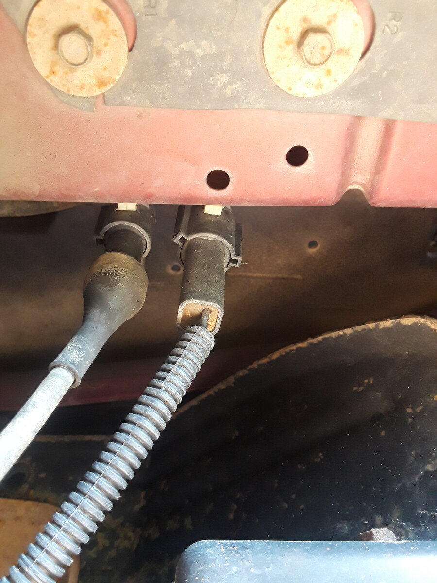

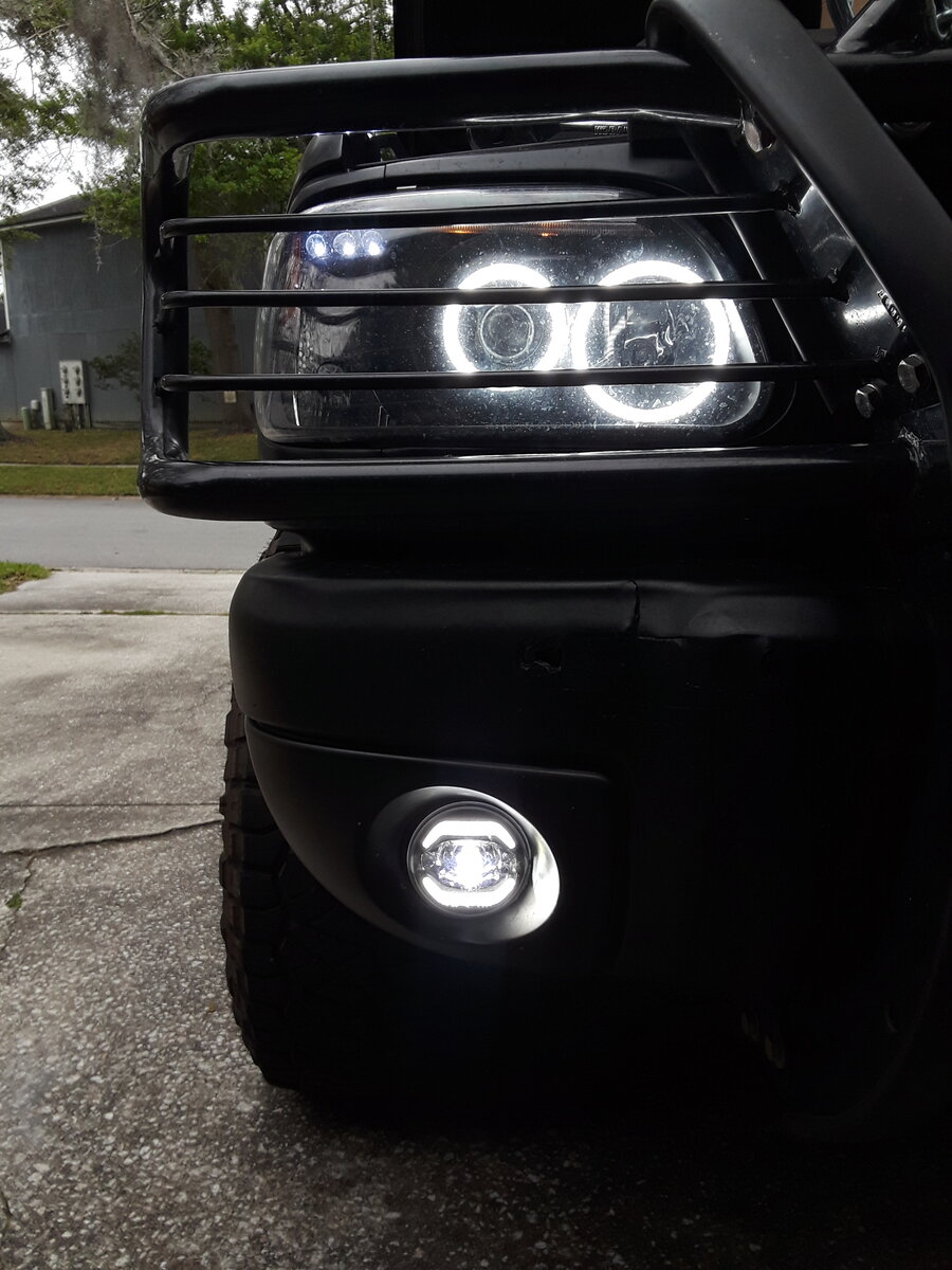

Anyone 100% know which fuse to tap into for the powering the fogs DRLs? Trying to run them off the parking lamps so they work with the halos, think it's the interior fuse #30? But if it is, it'd be nice to know which wire color I'm looking for before I try to untangle that whole mess of wires. If theres a closer spot to connect them, that'd be nice to know as well, rather than trying to run it all the way to the interior fuse panel
And there we go, all done and hooked up, get some pictures tonight after work. Looking absolutely fantastic! Even during the day, the whole garage was lit by them
20220323_112455.jpg 20220323_111130.jpg 20220323_105655.jpg 20220323_105631.jpg
