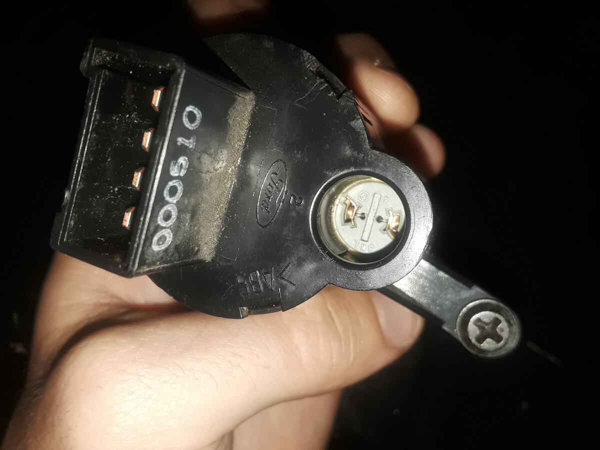

Anyone know where I can find this in blue? LED preferably, at least know the bulb size? I'm having some trouble finding it. It's for the 4X4 switch
EDIT: just found some online, T4 Type B tall neowedge. Already ordered one
