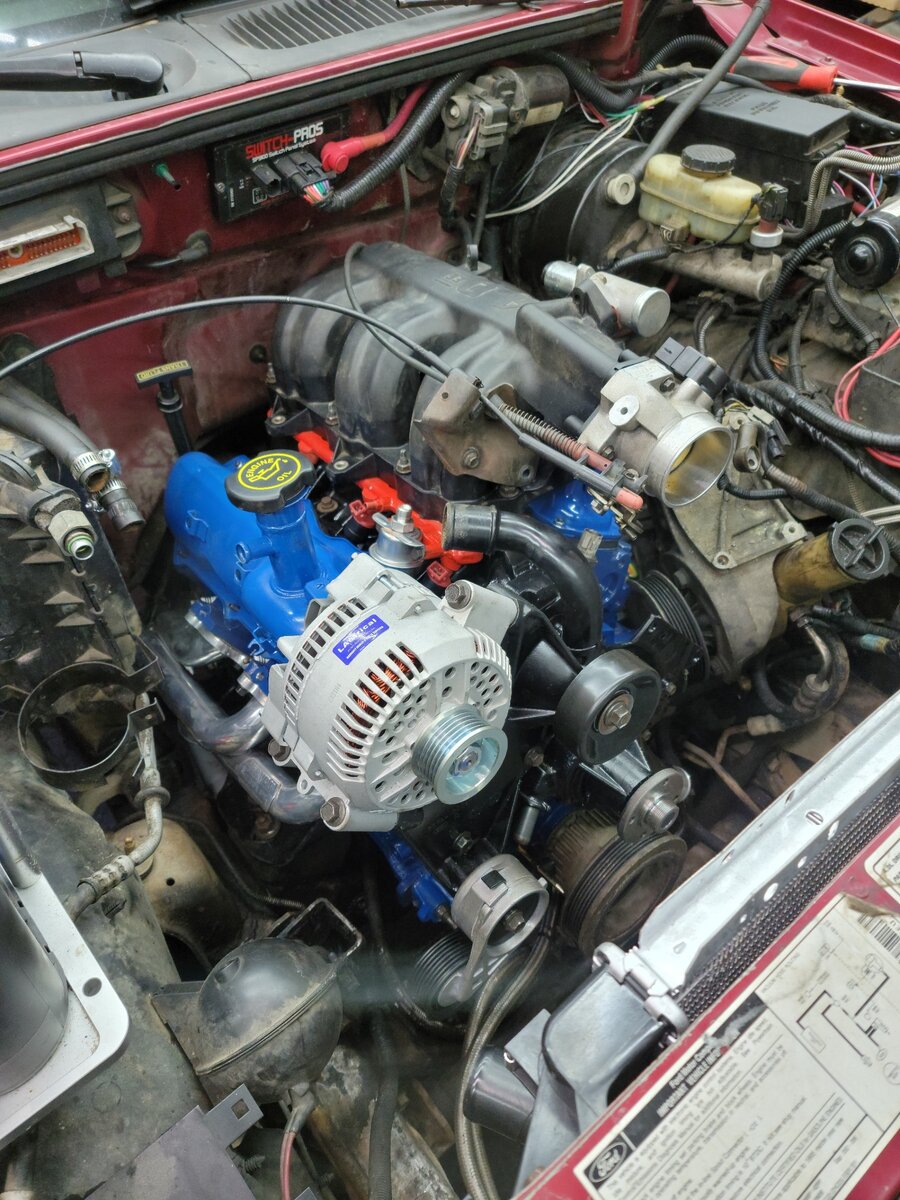

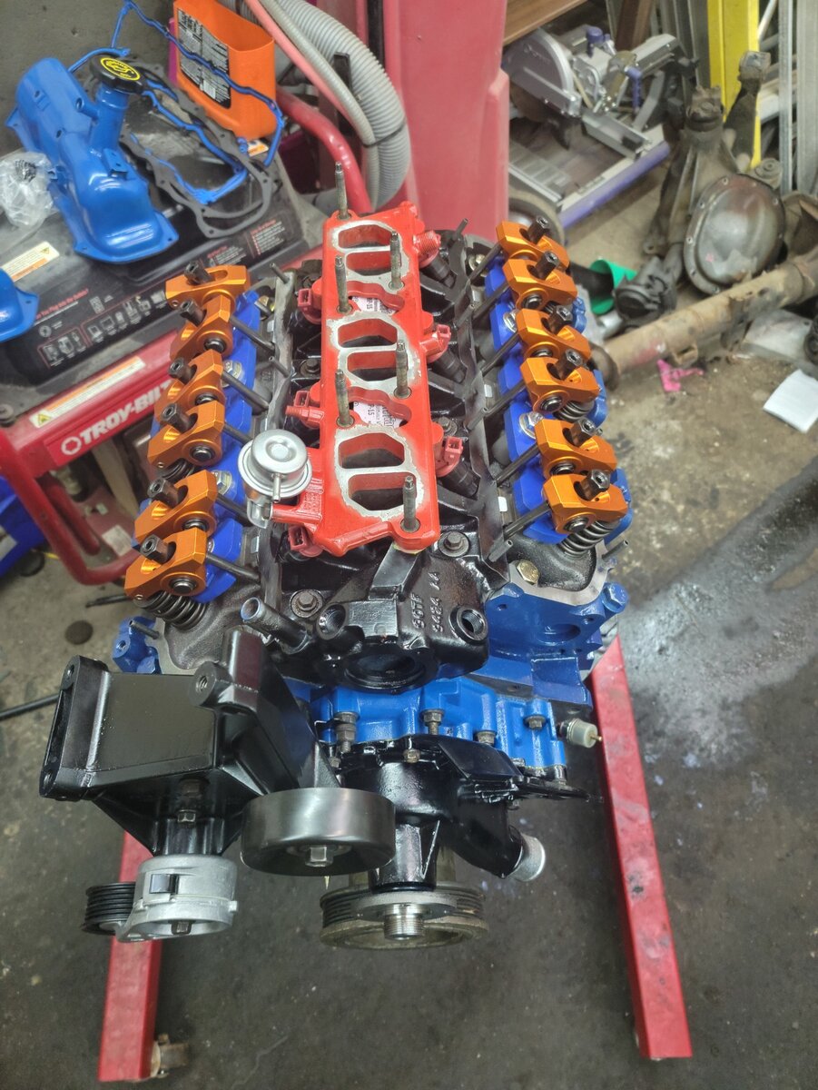

This was the engine going back in, and an older pic before the winch.

I currently run a 95 on 33's, 4:56's with ARB Lockers front & rear. Goes everywhere. Gets about 14 MPG regardless of how it's driven.
Here's some engine ****, and an old pic before the winch bumper.
View attachment 427498View attachment 427497

Yea, the OHV is from the crank up. If I had to do it over it would be the 302, especially since I have a complete running, slightly wrecked doner 96 sitting here waiting for a new lease on life. I only did the 4.0 because EVERYBODY does a 5.0 swap. Kinda-like why I off-road with an Explorer and not a Jeep or Taco :)
The 4.0 is pretty capable, but I have poured a butt-load of $ to make it do what a warmed over 302 could do. SuperTrick stage 2 heads, custom Cam, bla, bla, bla.
