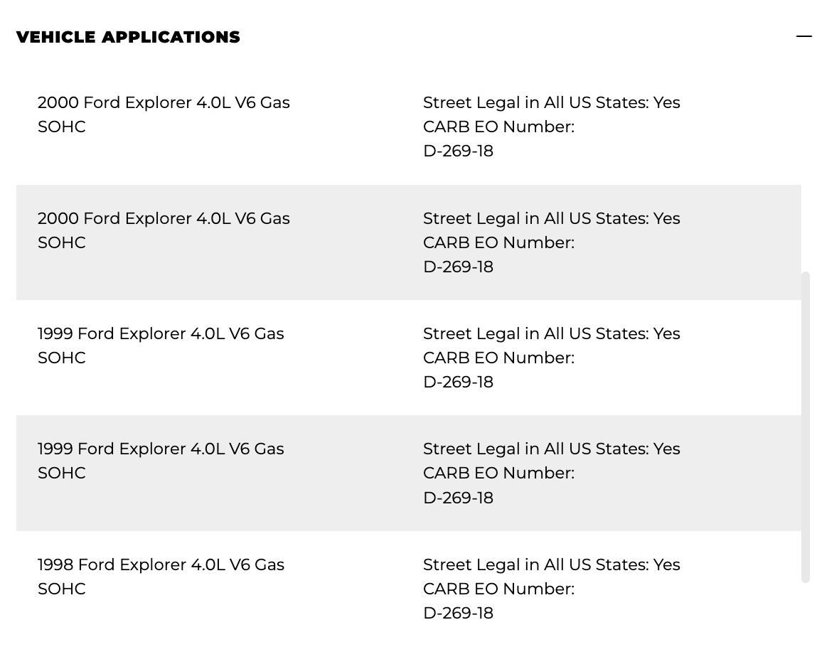

You're positive that one shiuld fit though right? Maybe my signals just bad but I'm not seeing a fitment thing for it
Yeah the 57-2528 should fit. It isn't obvious on the sit but you can scroll the "vehicle applications" and you can see it's in the list. They even send you a sheet with the dyno results in the box, and did it on a 99 explorer. For some reason that graph isn't on the product listing like I remember..
If you do get it, make sure to take note that there are different sized hose clamps. I also had to buy a hose clamp for the hose that connects to the PCV (you might not have to), and that little hose nipple they supply needs to be hand tight with a wrench, not just with your hands like the instructions say.

Well sweet! I appreciate it! Yeah the vehicle applications thing wouldn't even open on my phone when ya first sent it, guess my signal was too low at the time. Have to see how long it's on sale for and maybe I'll nab it.

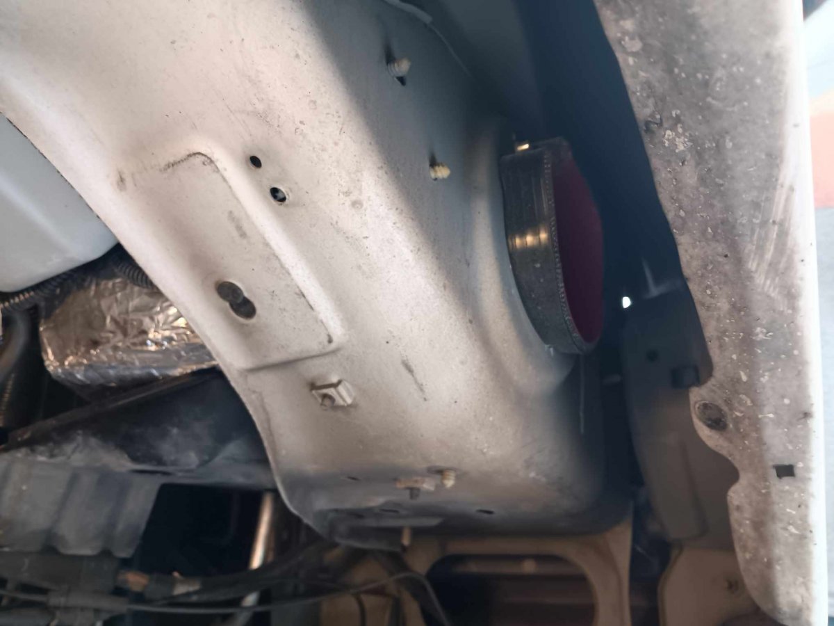

I built mine to seal up on the hood and get its air from inside the fender
This dropped my intake temps and my air filter is lasting longer now
We used 16 gauge sheet metal to make it Used cardboard aided drafting And some heating duct insulation
Held together with rivets
We put RTV on all of the edges before riveting them together

Silicone pc that we used was bought off amazon it's 4" inside diameter
We made the air box out of cardboard then flattened it out cut it from sheet metal bent it up Into an air box
After it was all assembled and riveted together we painted it black inside and out
We used a 5" hole saw to cut the Hole in the inner fender there was already a spot there for a air intake I just wanted a bigger hole to Fit my silicone coupler
Then we covered the airbox with insulation tape neatly
It installs the same location as the original air box The bolts down to the original air box plate
After that we shut the Hood slowly Then trimmed the top of the box a little at a time in different areas till it matched the hood then we installed Weather stripping
After the weather stripping was installed we then put chalk Weather stripping Close the hood And tested to see the seal. A few adjustments and we had a perfect seal
Now we glued the weather stripping down To the airbox

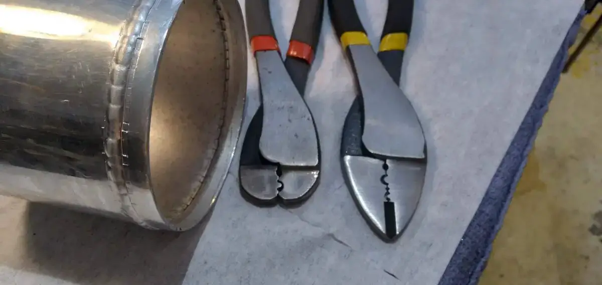

The air intake tube is made from 4"id mandrel bent aluminum pipe
We had to make barbs on the end of the aluminum pipe so we made our own pliers for that

There was no welding involved
The custom tool is a simple pair of wire crimpers from the auto parts store We just grinded it down with a grinder
Both sets of plyers in the picture once looked the same
