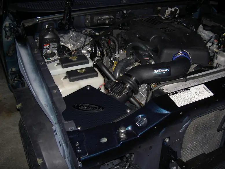

The best in the past that was available was the Volant kit for 2nd gen's, they had two versions. But I doubt these can be found now, I got this one in 2006.

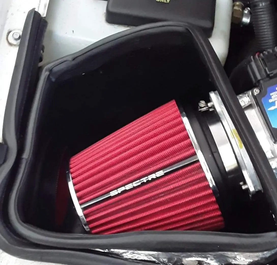

I have the one for 98-01's, on my 99 SOHC Limited. That air cleaner was fairly large, it fit tightly in the corner space. But inside is nothing special, it didn't come with an air filter. So you choose your own, typically a cone style, which there's plenty of room inside.
