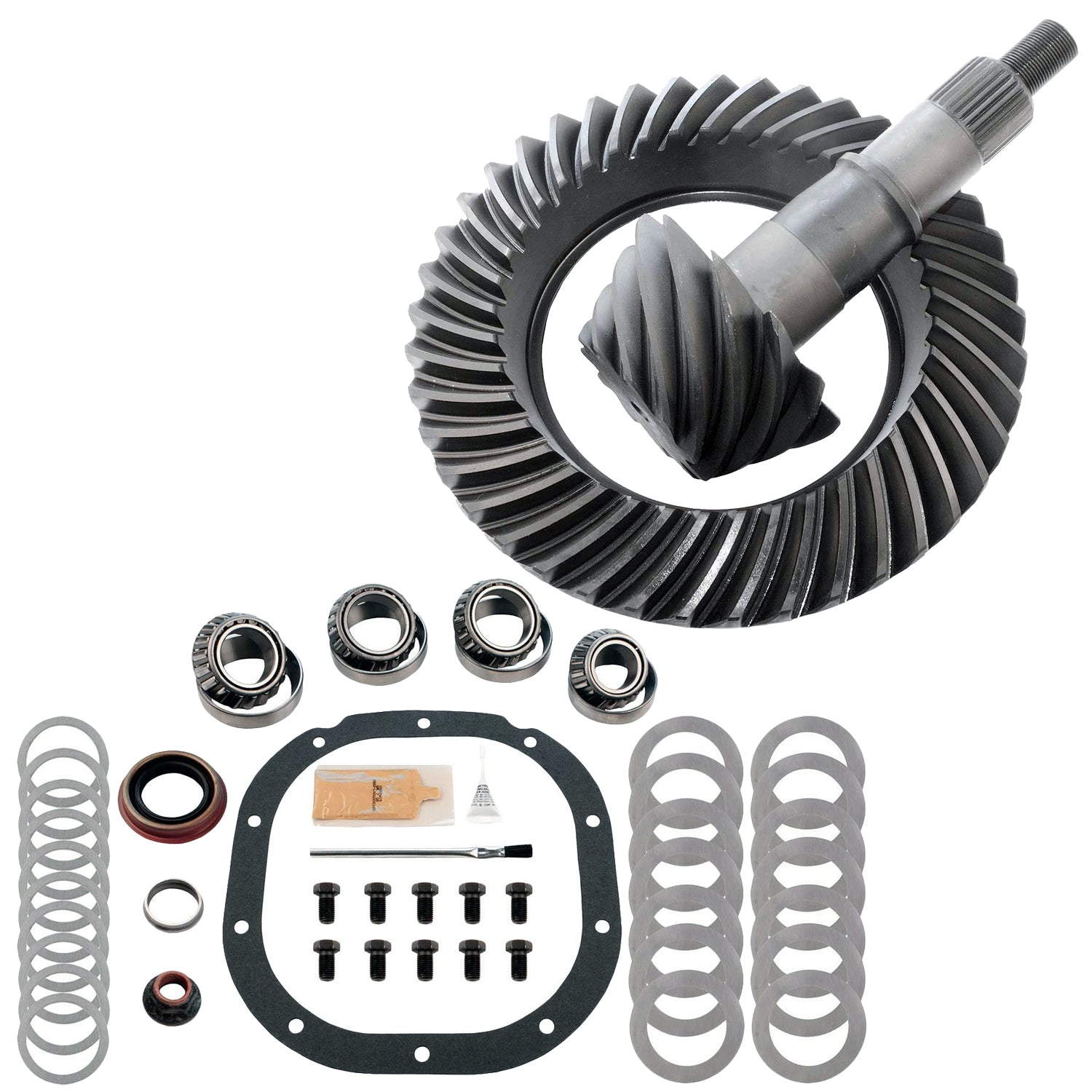

So, I should be able to get these two, take it to a shop, and be done with no issues? Of course I'd buy two of the regearing kit so the front matches and I don't destroy the truck, but it's not missing anyrhing I need? Just take it up with these, ask them to do the regearing and the locker while its apart? Sorry, I don't have the most background knowledge on this stuff, I got a general idea of it all, but not enough to be 100%.
That first link to an Aussie diff, is only for an open diff install. If you have an LS now, the factory clutch diff, then that unit won't go into it.
That 2nd link is to a non Ford 8.8 gear set, I would avoid that. The Ford gears have a much better reputation of having no installation issues, no noises etc, easier to set up the pinion bearings etc.
Here's one link of first page I searched for "8.8 Ford ring gear 4.56", the $165 price is likely typical. Not may big sellers carry the Ford gears, but I found many when I was hunting 3.08:1 gears.
Here's another link for Ford 4.56 gears, note shipping isn't part of pricing I'm sure;
The front gears I discovered choices are more limited, so hunt a better brand. I chose Dana/Spicer, who is right behind Ford for the best gears, there are several lesser brands and a couple others just behind the Spicer too.
Here's a front Spicer ring and pinion, $300 which seems typical for the front gears(better brands);

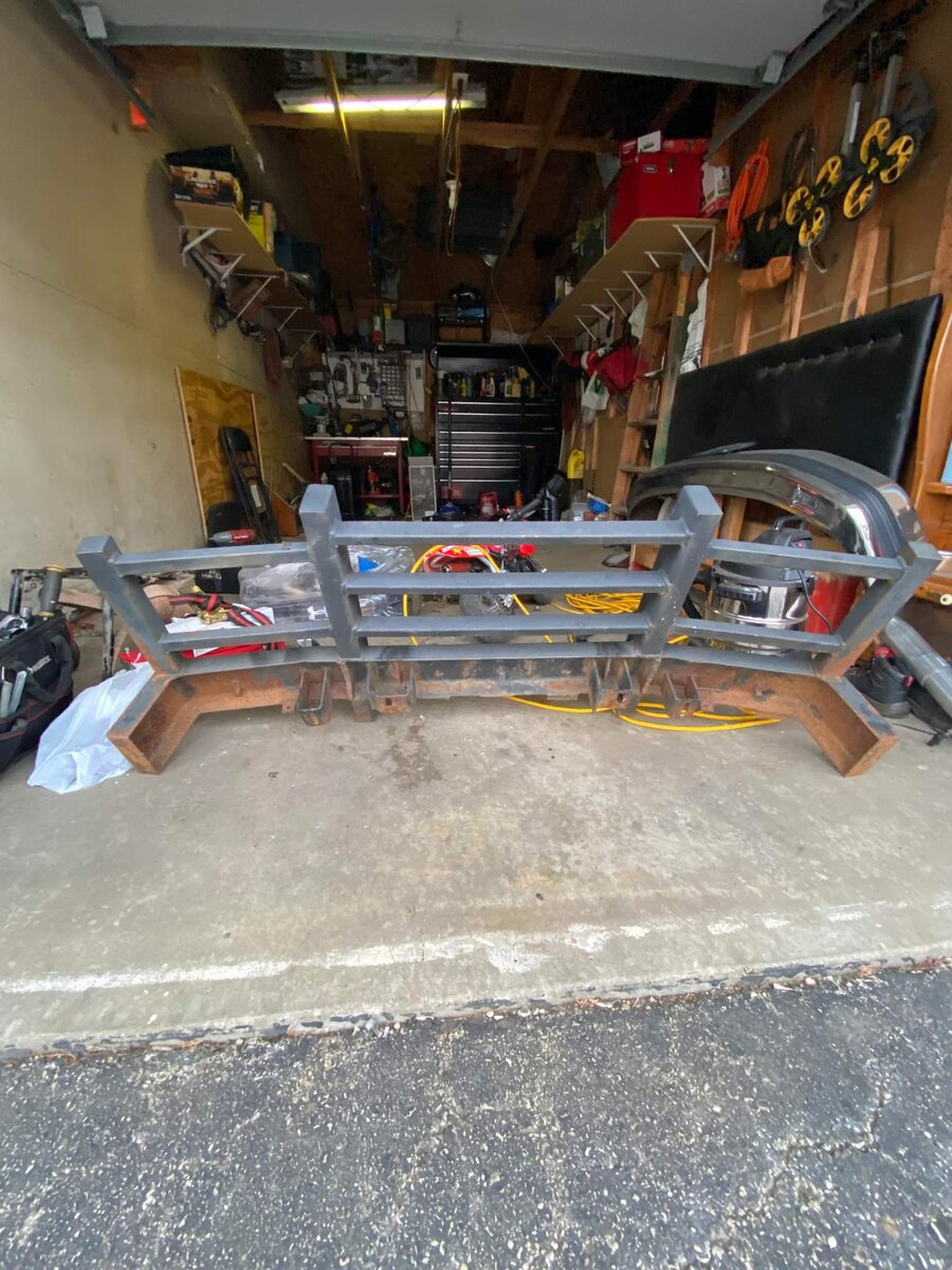

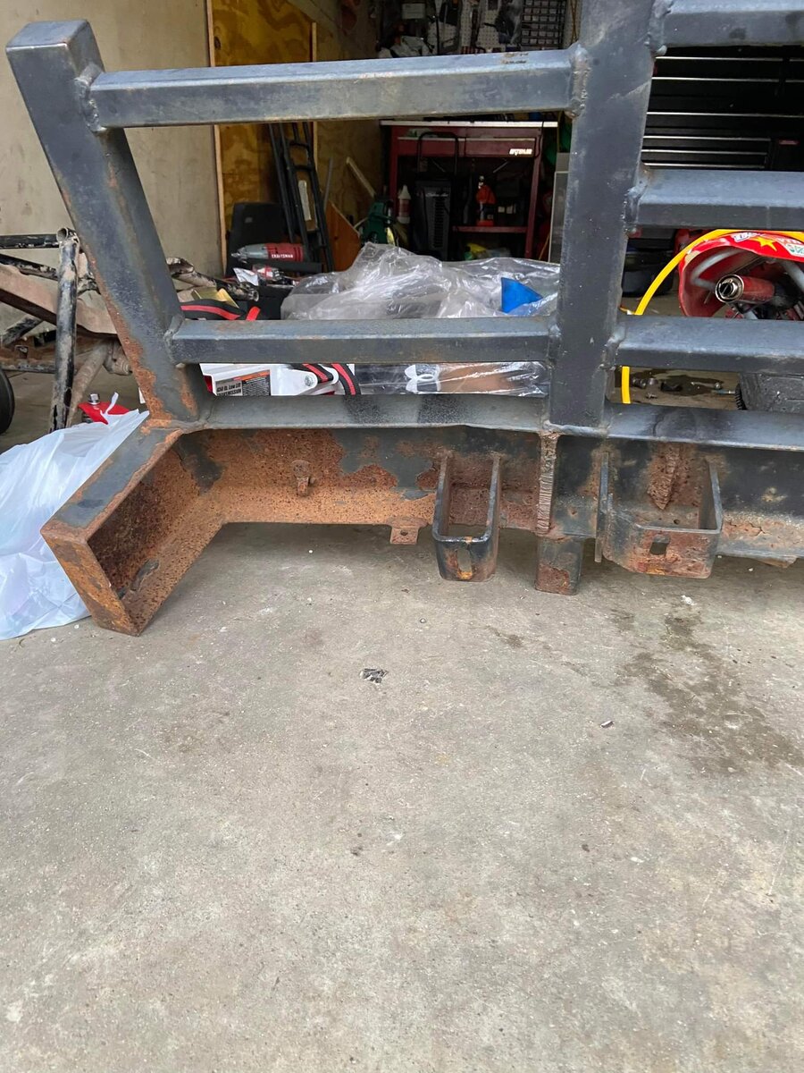

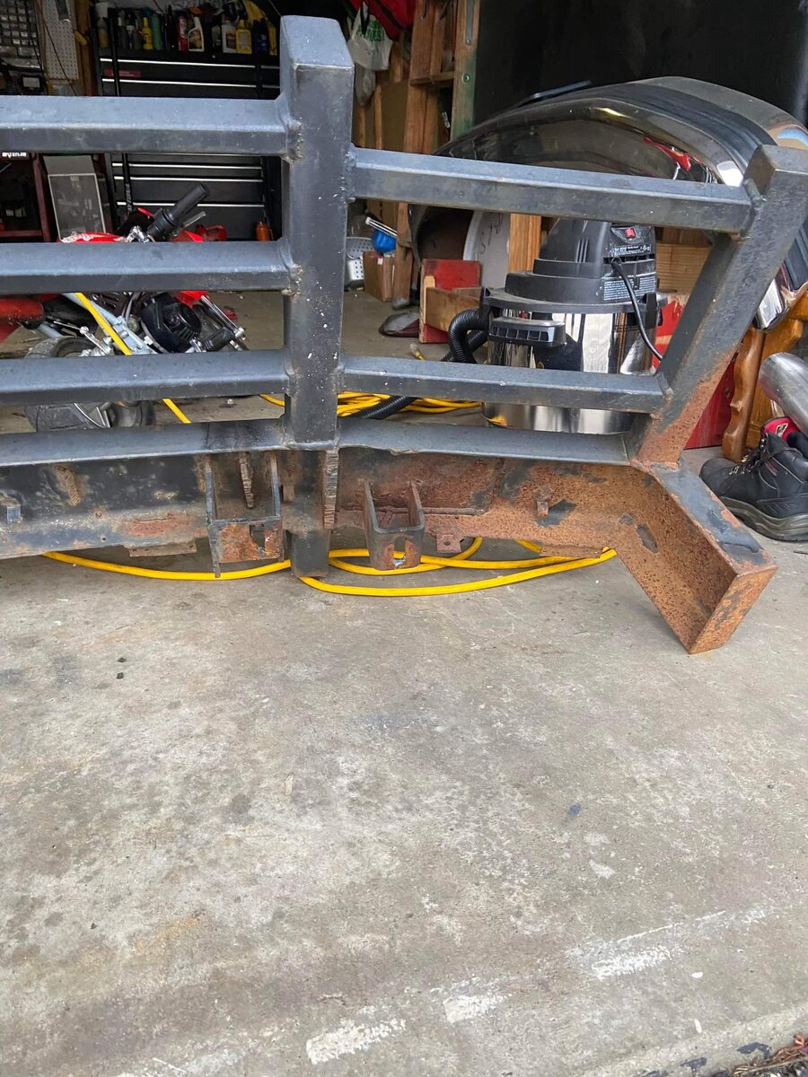

I'll post this up on facebook as well, but I ordered a 98+ steel ranger bumper to throw on. Need ro recoat it, got some surface rust, but overall not bad. Its 3/8 and 1/4 thick, even has two other outer mounts that even the seller isn't sure what were for, says maybe for installing it on a larger truck? So if all goes well and this goes on, I'll be getting rid of the current brush guard and bumper if someones interested. I'll go to the sales section of the forum and post it there when I do.
received_7160648747342176.jpeg received_1155196548549588.jpeg received_1771177889939962.jpeg

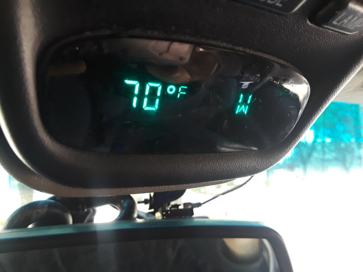

Just a small update: swapped out the green lens for a blue one from a '97.

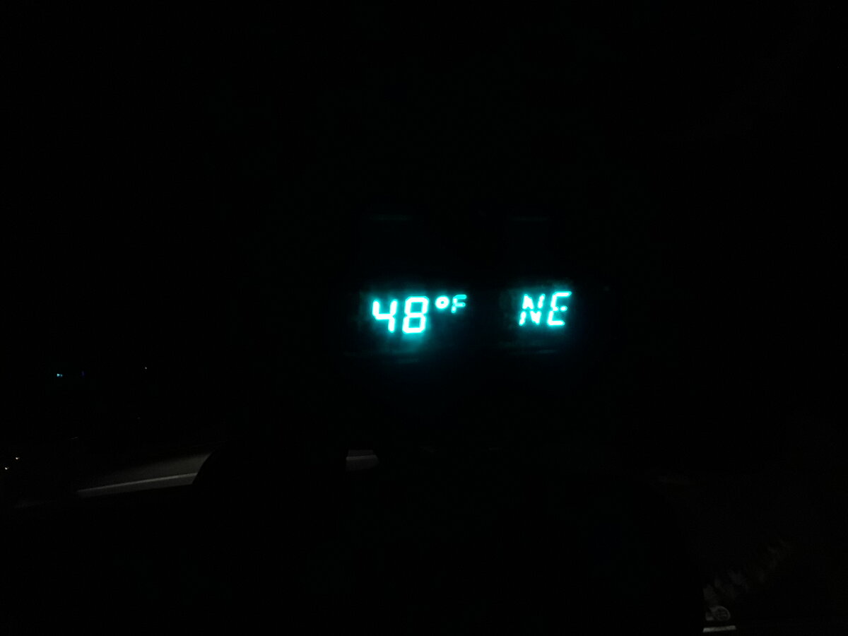

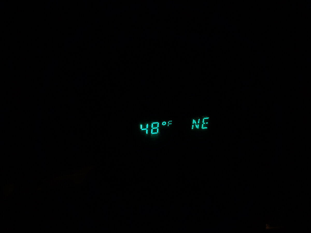

Edit: some picture at night
