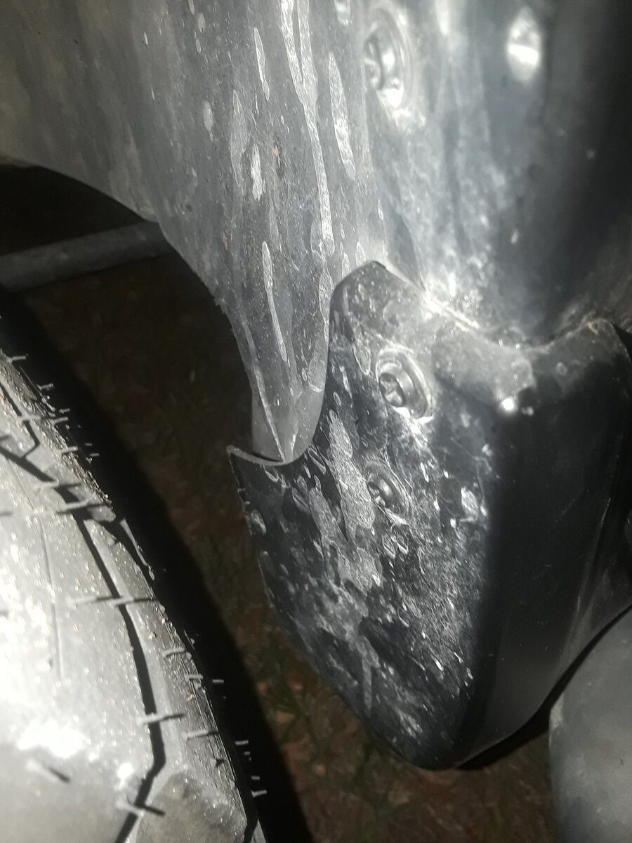

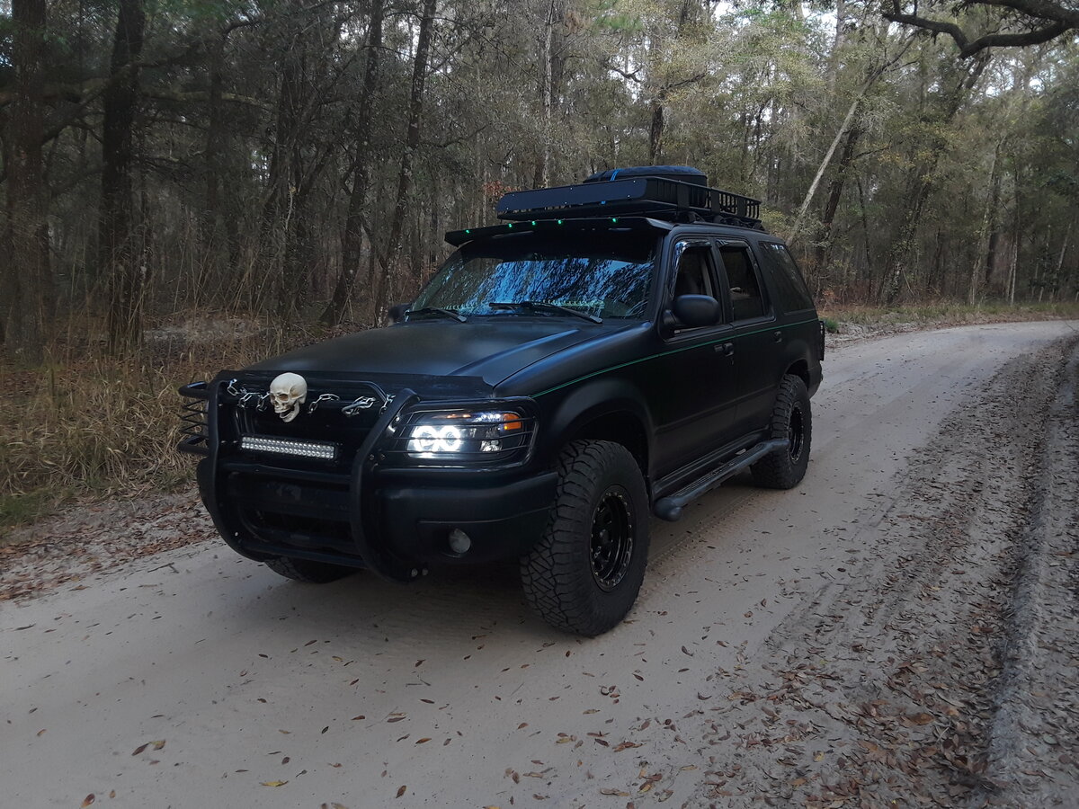

Well, its finally done. The lift keys didn't fit so I just kept the stock ones and maxed them out, but she looks great! The Trakmotive CV axles seem to be working pretty well, taken through a ditch, up a curb, down backroads and highways, so far so good! Had to trim some of the plastic of the front bumper, fog light cover, and the skirt end on the front, but other than like 20 minutes of testing to find the perfect amount of trim, she works! Take her out on some actual trails in the next few days, after I get an alignment done. Next up, the dang f150 leafs at some point, and figuring out how to get this new heavy freaking tire onto the roof basket so I can latch it down.

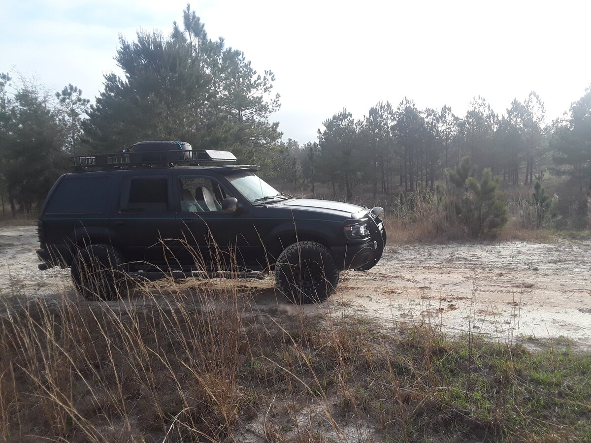

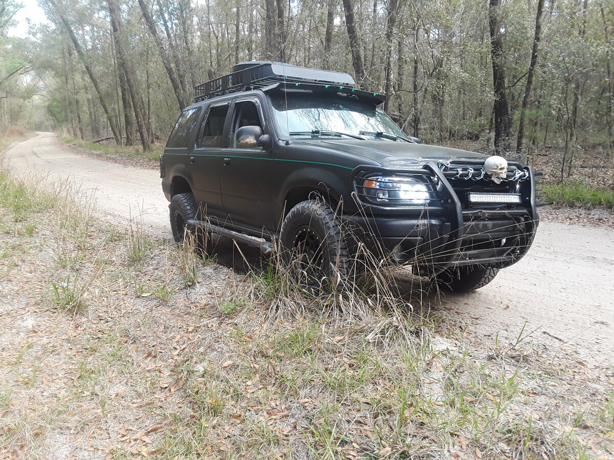

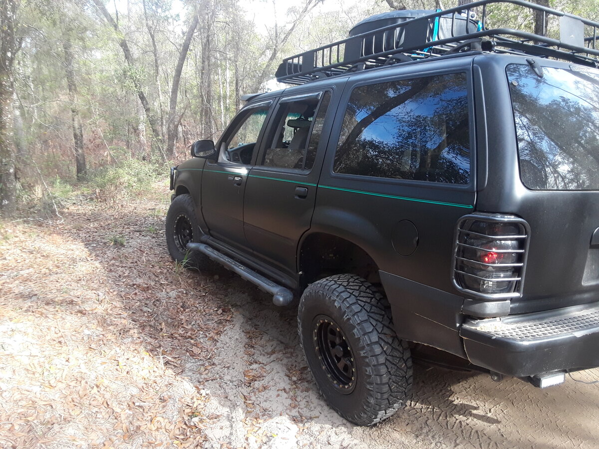

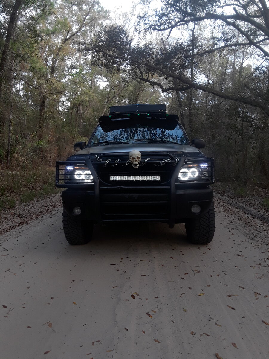

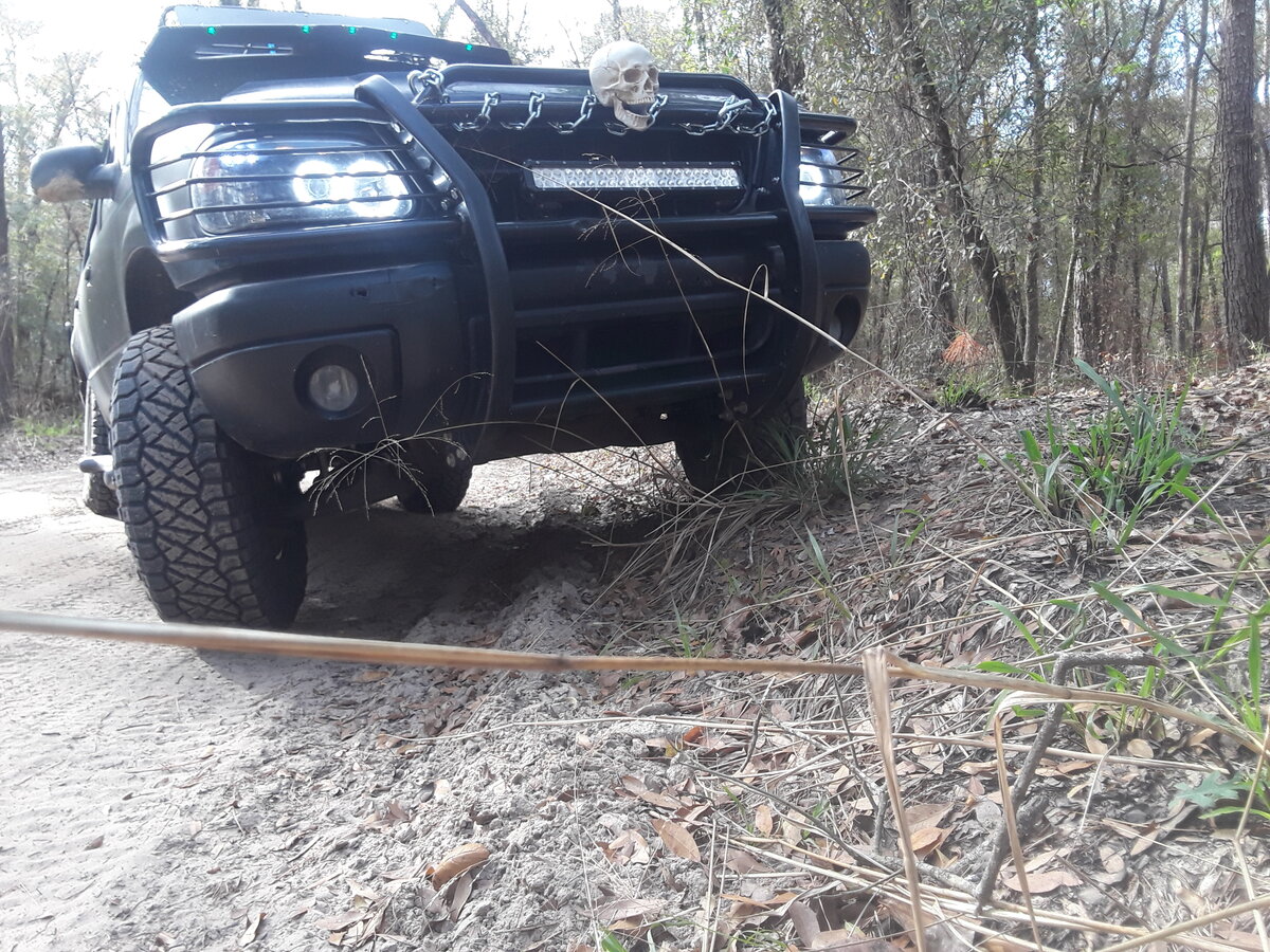

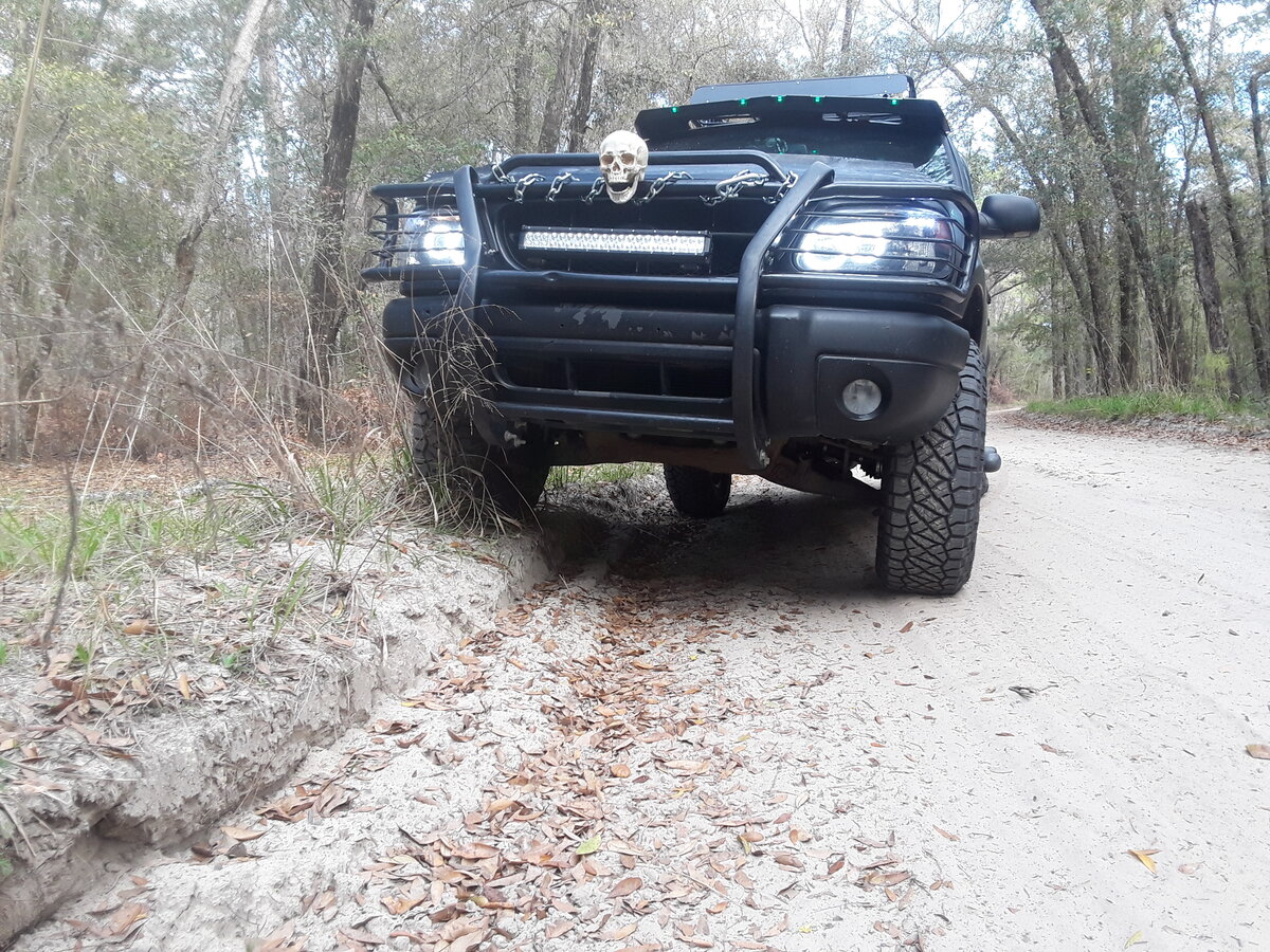

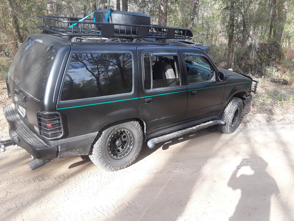

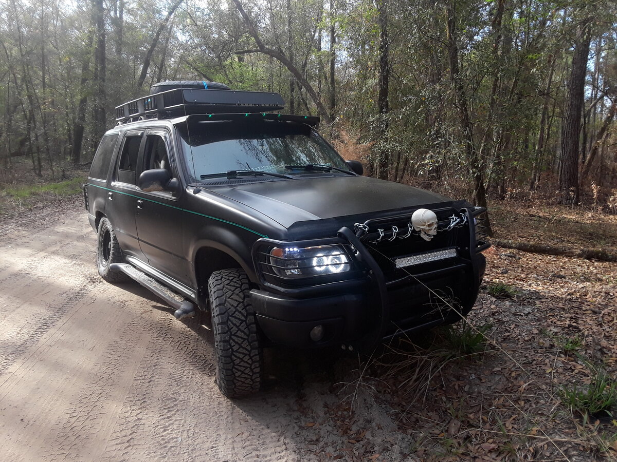

Well she did good on the trls I took, only issue I had was that the 3.73s decided the 32s are too much and had some trouble pushing power. But otherwise it turned out well, the new CV axles handled everything just fine, I'd recommend the Trakmotive ones for others going the TT route. Too bad there wasn't any mud out there. About how much worse would the gas mileage be if I swapped to at least 4.10s?

I can not wait to get mine. I like going up in the rocky trails.
