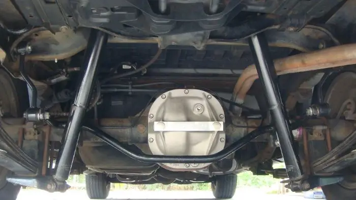

Is that cast iron or aluminum?I didn't want to hijack this thread and hadn't gotten my cover done back in October, but I want to chime in with the "ballin on a budget" option of using an IRS 8.8 cover from a 3rd or 4th gen. It's certainly been covered before and on other forums: basically pull the cover at a JY, lop of the mounting ears for the IRS, and blend what's left however you like.
$20 for the cover, a couple hours with a port-a-band and die grinder, Rust-Oleum semigloss, and another 30 min with a cartridge roll nets you this:
I'm mostly excited just to have a drain hole, but a thicker cast cover with cooling fins can't hurt either.
I like the location of fill, and, drain is so large it should allow visual inspection to a degree.
