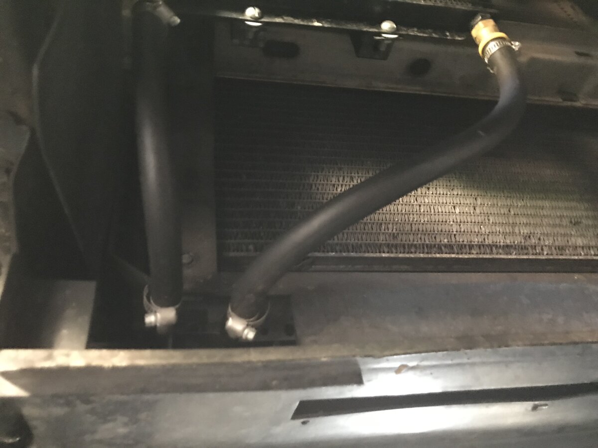

Thats your power steering cooler there should be a smaller one in the grill it has 2 rubber lines that go to 2 steel lines
Alright, give me a bit to hunt for this thing, the dude I bought the car from did a lot of work on the cooling.

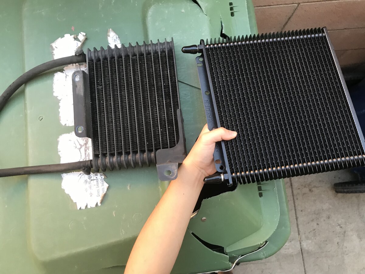

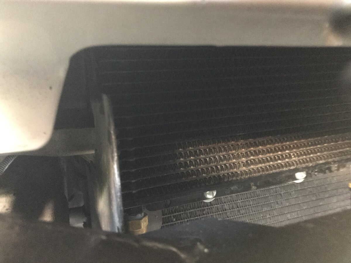

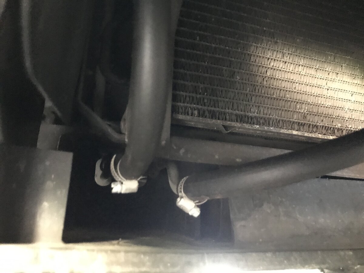

heres where it is on my sohc. sorry for bad pictures. the last one is a pic of what youre lookin for (its the smaller one) this is if youve got the external cooler
