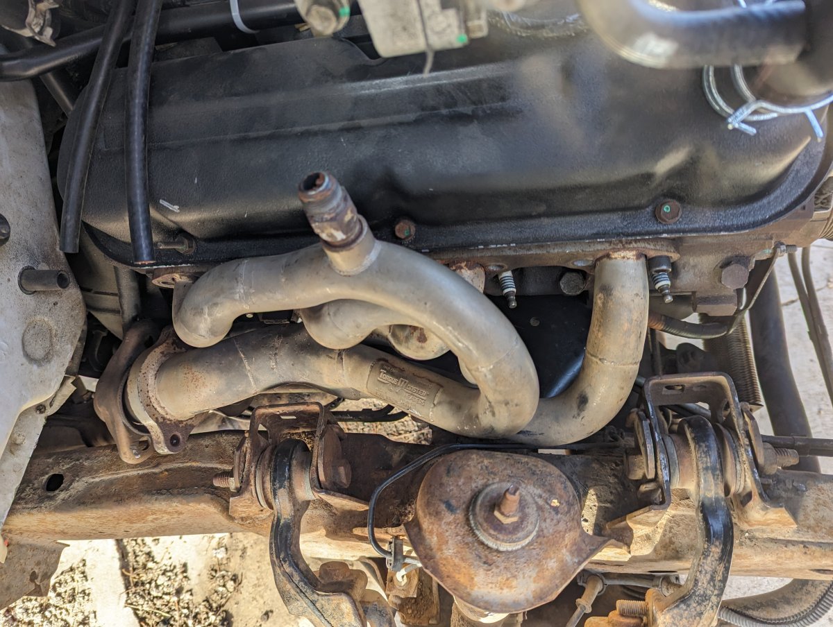

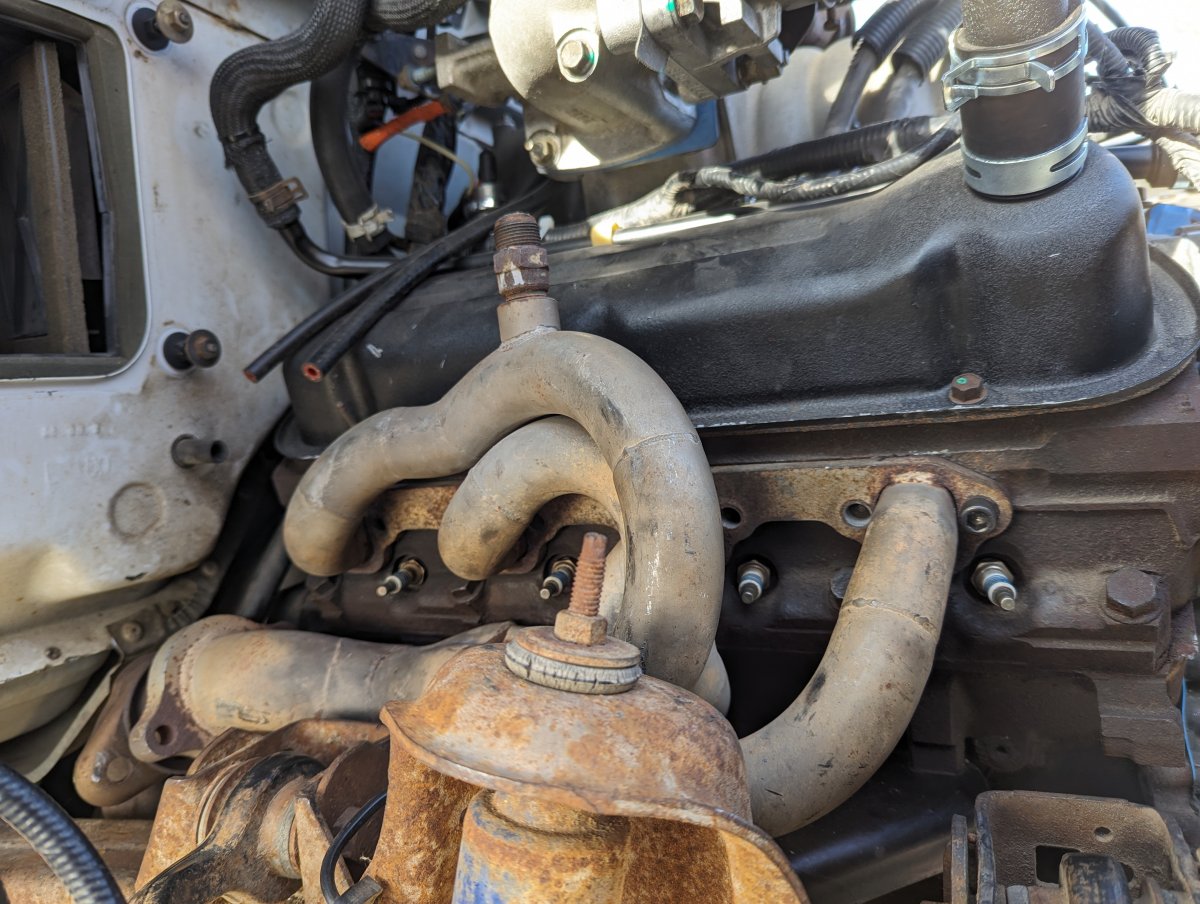

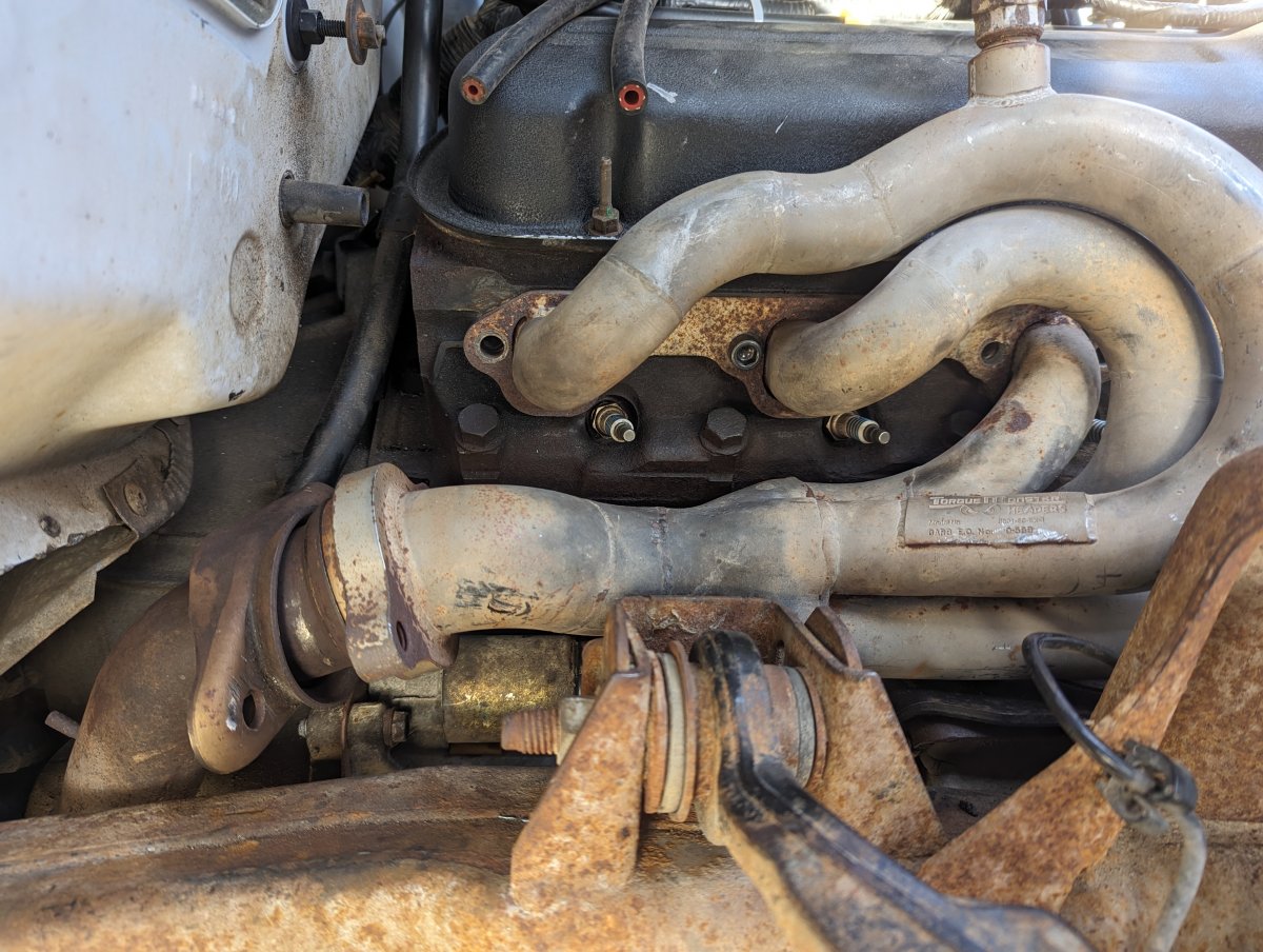

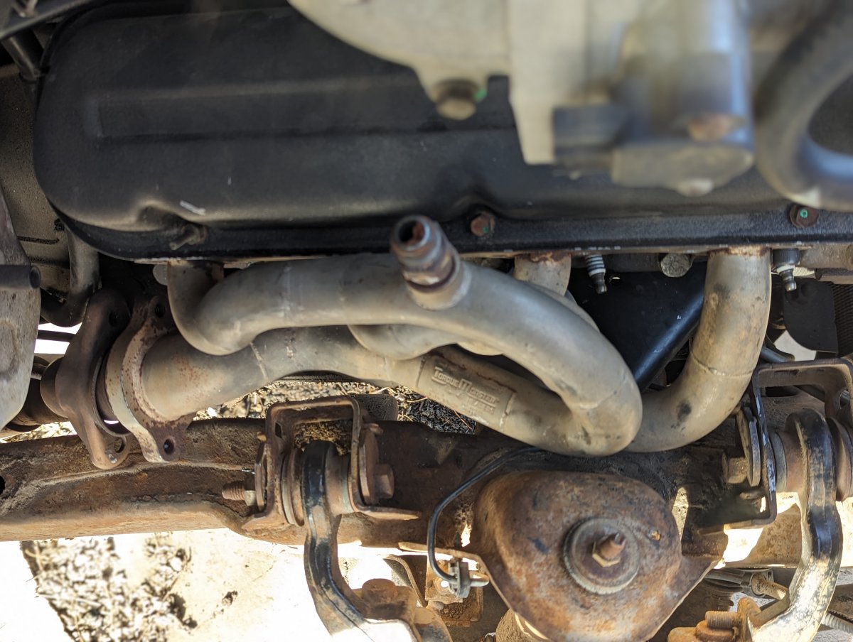

The moment you've all been waiting for without realizing you were waiting for: direct comparison to TMH!
I sourced a set of used, damaged headers from a fellow forum member for the sake of furthering my DIY header deep dive. I'll try to get more pics in the engine bay if it stops snowing anytime soon.
TMH driver's side is tall! I'm sure this makes for better steering shaft clearance, but at the expense of the #7 primary running closer to the fuel line. TMH is probably better for valve cover pulling, but the header itself will be harder to snake in place.
Passenger side we have two fairly different ways to accomplish the same thing. My #4 runs under the heater box, TMH runs alongside it. That's of course why TMH needs custom EGR tube and I don't.
General impressions:
  • TMH are very well made. TIG welds in primary sections look great (unlike my bulky MIG stitches), primaries are made from custom bends that fit together nicely, and all the flanges look like great quality.
  • The same challenges created by using stock downpipes are evident in both my headers and TMH. This seems obvious when I say it, but hits home when you consider the challenges I faced getting the collector locations and orientations just right. You'll note in the pictures they're almost exactly the same between TMH and mine, I believe this happened because it is a necessity.
  • Both sets neck down to about 2-1/8" ID at the ball flanges -- this is of course the same ID as 1/16" wall 2-1/4" OD tubing like the downpipes, so you're not really losing anything. However, since my collectors go into 2-1/2" tubing, I can cut off the ball flanges and run 2-1/2" V bands in the future with custom downpipes. TMH can't do that, their collectors neck down to 2-1/4".
  • Everything looks better with the smaller 1-1/2" primary tubing: tighter bends, more space for hardware, and I'm sure better clearance in the vehicle. Clearly sacrifices have to be made to run larger tubing, but I'm going to keep pushing and prove it can be done (even if it won't be worth it until I redo the rest of the exhaust).
Stay tuned!

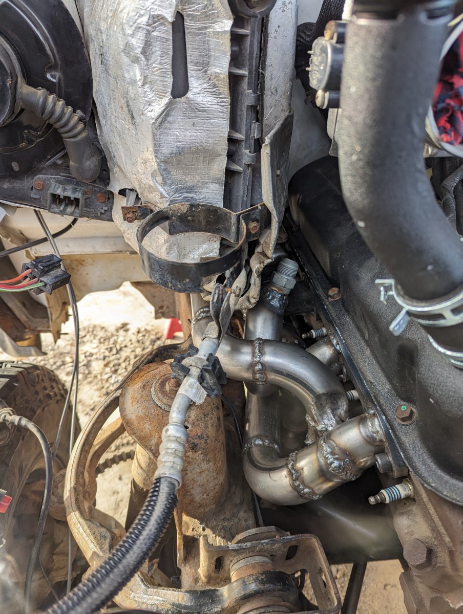

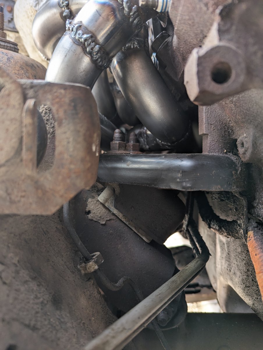

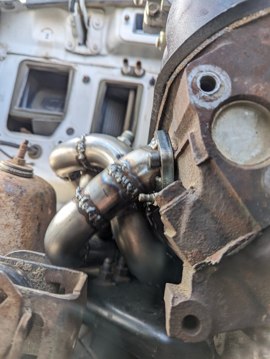

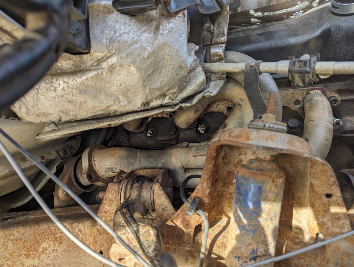

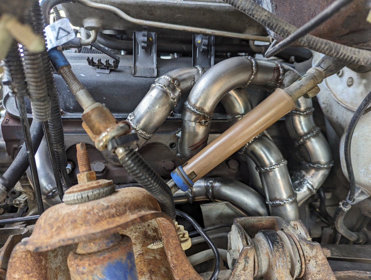

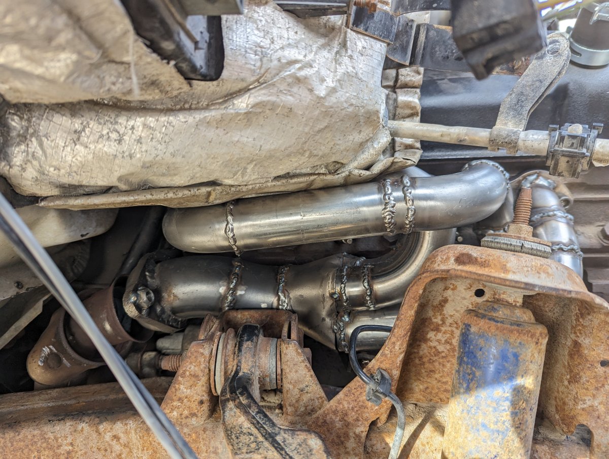

Finally had an opportunity to get out in daylight and play around with the headers and do more comparisons.
With the heater box out, passenger side TMH installs with minimal issues.
Clearance is pretty good all around and spark plug access is fine. With the heater box in, the #4 primary is right along the side of the heat shield.
With my passenger header, it's generally a similar story, just tighter everywhere due to the larger tubing.

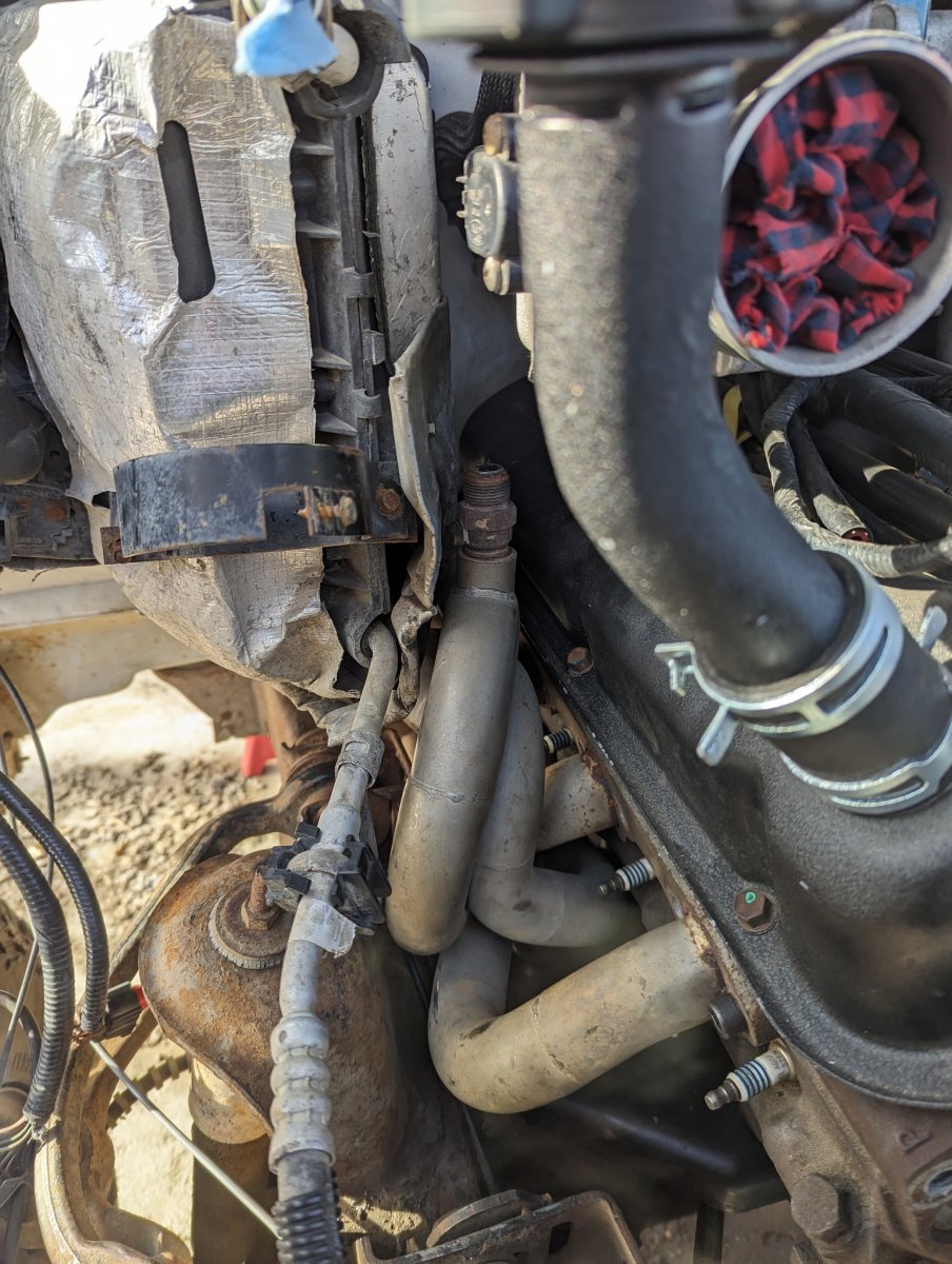

My cylinder #4 primary touches the underside of the heater box heat shield. This was the plan.
One thing I decided after this trial fit is that I want to cut off the locking nuts I welded on the exit flange and replace them with normal nuts. It seemed like a good idea, but it's hard enough to get access to the inner bolt, I don't want them to be harder to turn than they need to be.

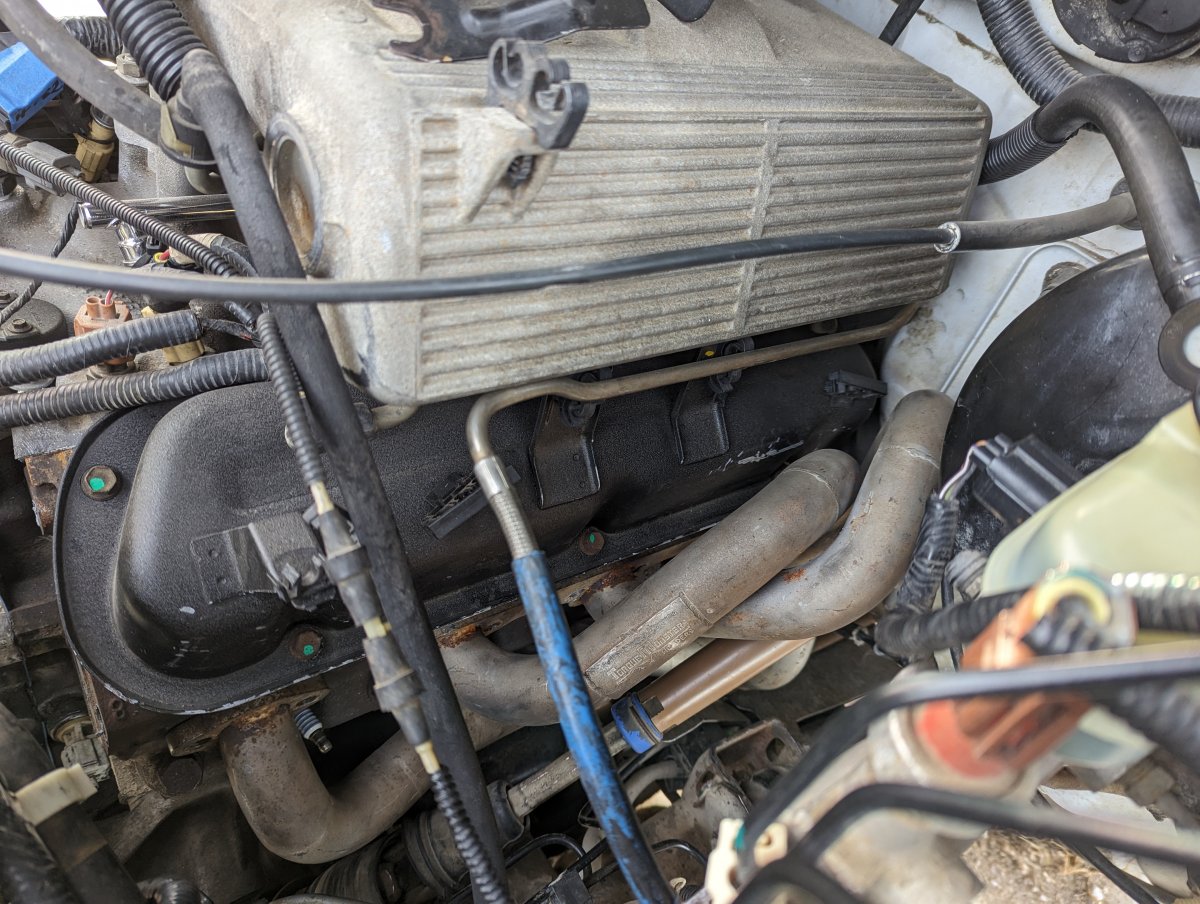

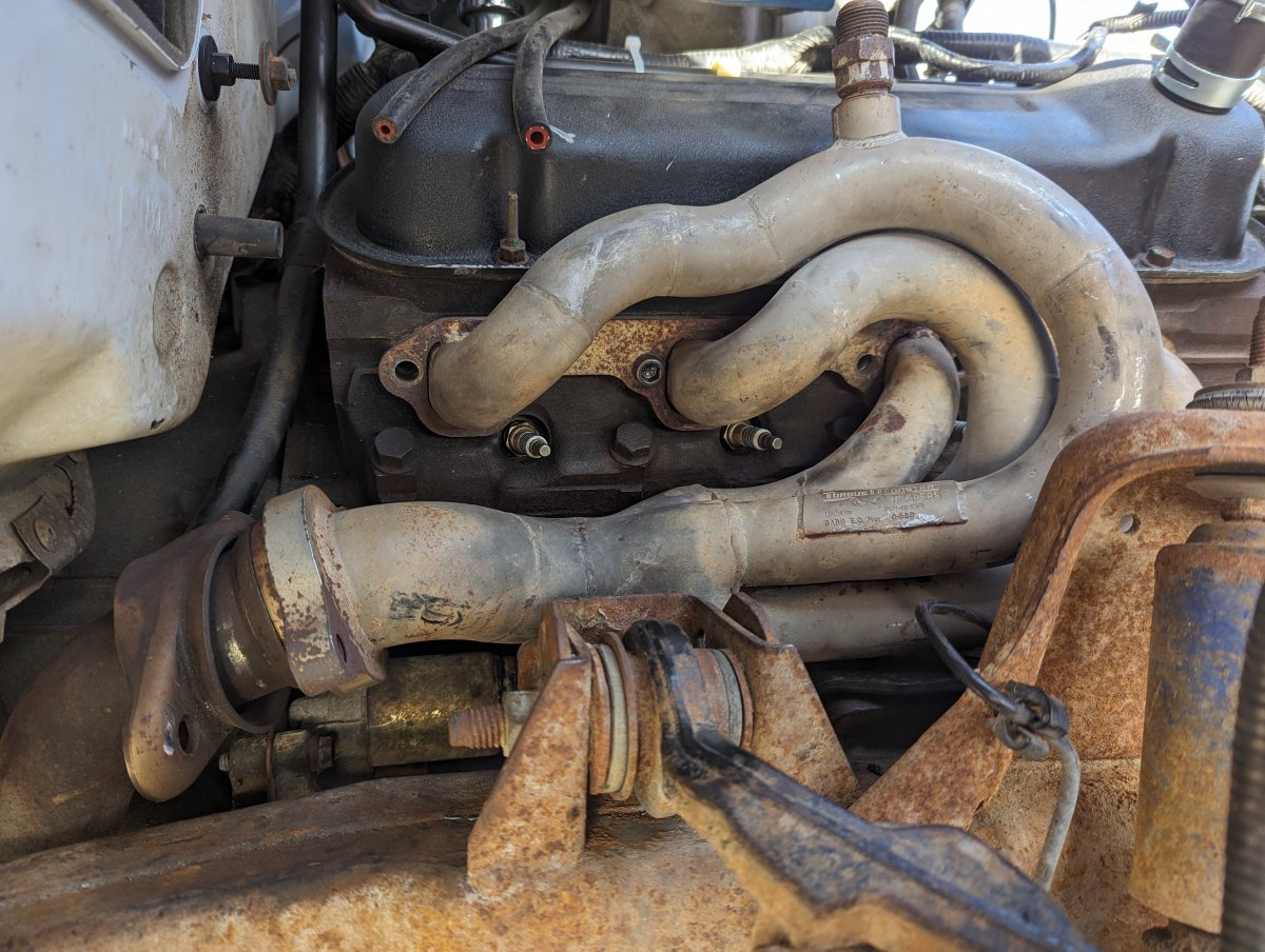

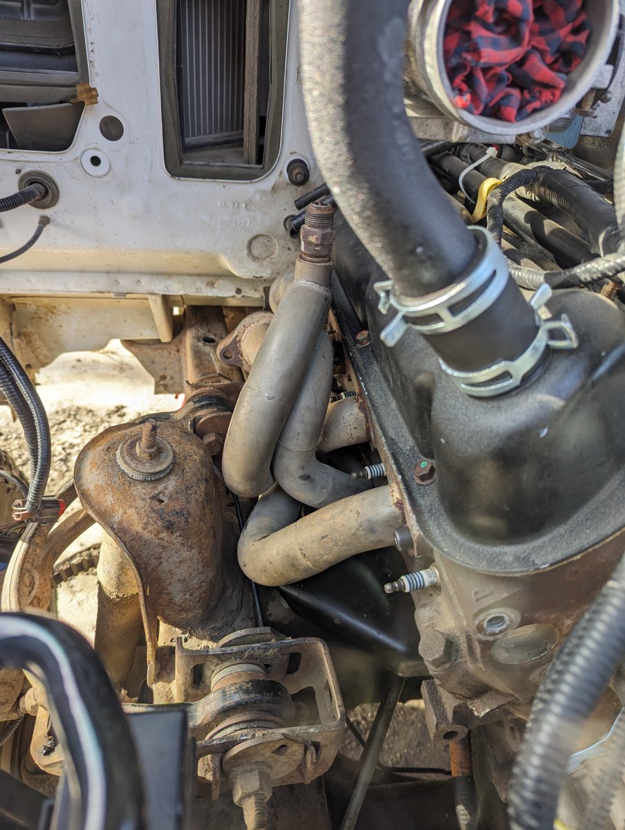

Driver's side it gets more interesting.
As I showed before, TMH driver's header is really tall, that makes it very tough to sneak into place. I mean really tough. And that stupid flange for the two-piece #5 primary gets caught on everything.
I do really like how the #6 and #7 primaries are spaced so the steering shaft bolt passes between them, it's a clever way to avoid a clearance issue.
Valve cover clearance is good.
My header is a lot easier to sneak in, but comes much closer to the valve cover. I also elected to do some denting to clear the steering shaft bolt better.
I'm going to have to get creative with the dip stick, but I'm not too worried about a little bending and a custom bracket. This seems like a better route than trying to follow the stock path.
All in all, I see pros and cons to both designs and I'm sure there's a more optimized design somewhere in between. I'm going to go ahead and finish what I've started, but I definitely think a Rev 2 driver's header will be warranted in the future. Hopefully I can TIG by then.
Great job! you jumped-in acknowledging a lack of experience and did it! I wouldn't have tried. I may now after your example but probably wont realizing how much time and effort you have put in. I think I will work on better downpipes.
View attachment 447747View attachment 447748
thats exactly how i took that one out. never done it that way, and figured i would try it. couldnt believe how easy it was. also, does your header that you have made come close to the plastics splash shield? you might also want to get as much room as you can between the heater box, and the header. i melted 2 boxes a few years back while tuning the truck (had the timing waaaaaaay out and the heat the headers pumped out was unreal.)
With the heater box lid off you can simply heat it with a heat gun and re shape it to clear your header
Or hack that part of the box out and replace it with tin/rivets/ fiberglass
You will want some serious heat shielding there either way so your cold air stays cool in summer. Maybe even wrap the header tube where it comes close? A simple tin heat guard with some air gaps can also work wonders.
I have v8 stuffed into bronco ii with a small body drop… I know all about how much heat headers can put off, enough to melt your shoes on the passenger side before I did a bunch of heat shielding inside and out
Thanks! It's definitely a lot of time and effort, but if you want headers and don't want to wait for TMH, it's what must be done. I know I've said it already, but when you consider the labor that goes into these, TMH look like an absolute bargain.
It will come somewhat close but not touch the splash shield. Thankfully the primary sits lower than the plastic part, and the fiber part of the shield bows out in that area for the shock tower.
I didn't want to take the #4 primary any lower because it would start getting close to the shock tower unless I put another jog in it, which would make plug access worse. This job is all about balancing tradeoffs. I do plan to wrap the section of tubing running under the heater box (and a few sections on the driver's side too).

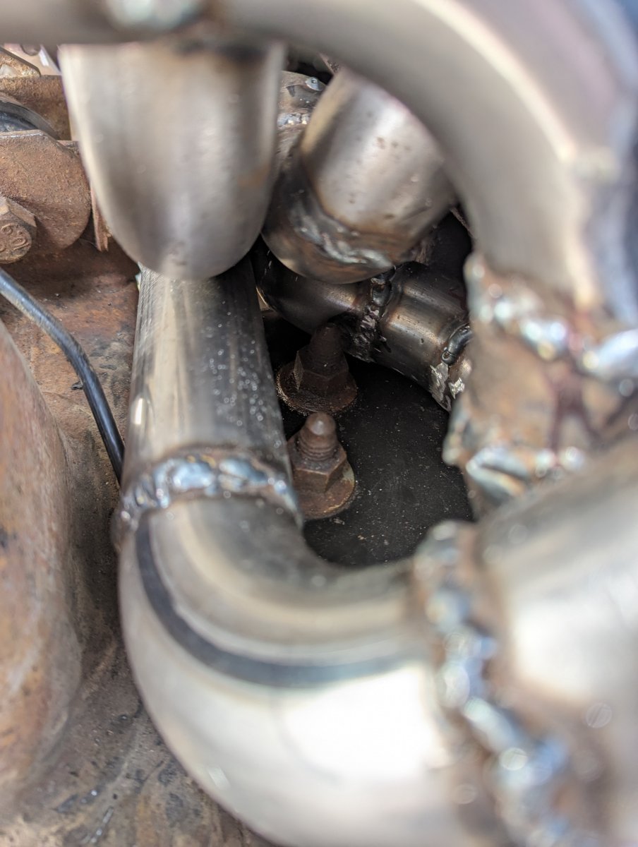

Started my merge spikes, it's all coming together as planned:
I will weld, hammer, repeat until I work my way to the end of the spike. Then I'm sure I'll do some cleanup grinding. It's going to be tricky stitching along the edge without melting the spikes.
