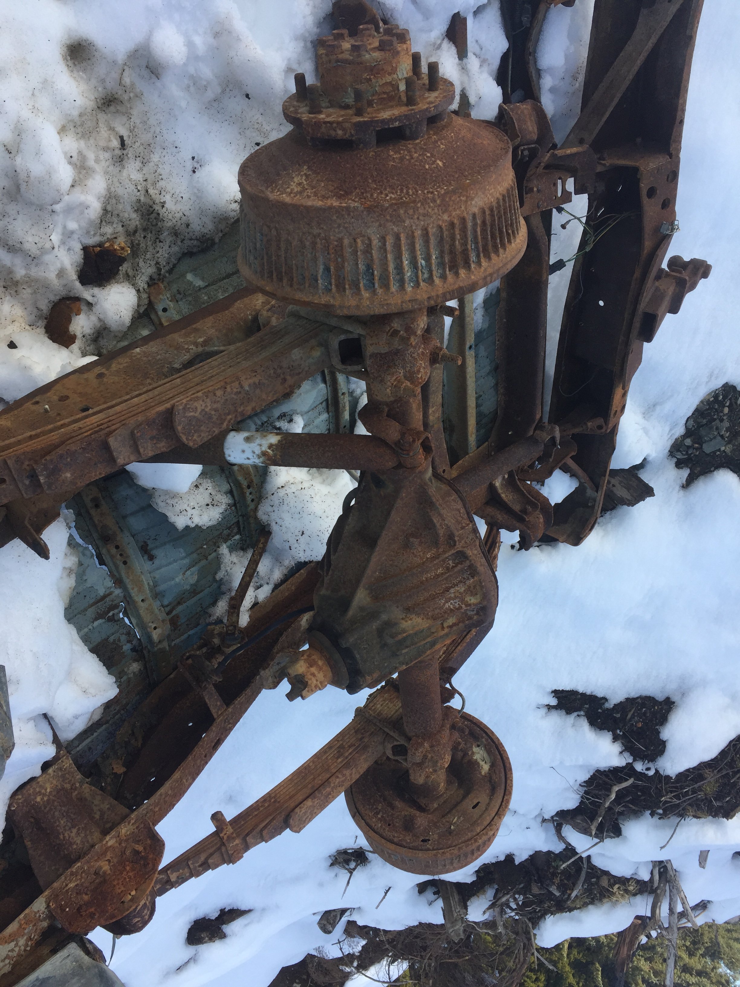

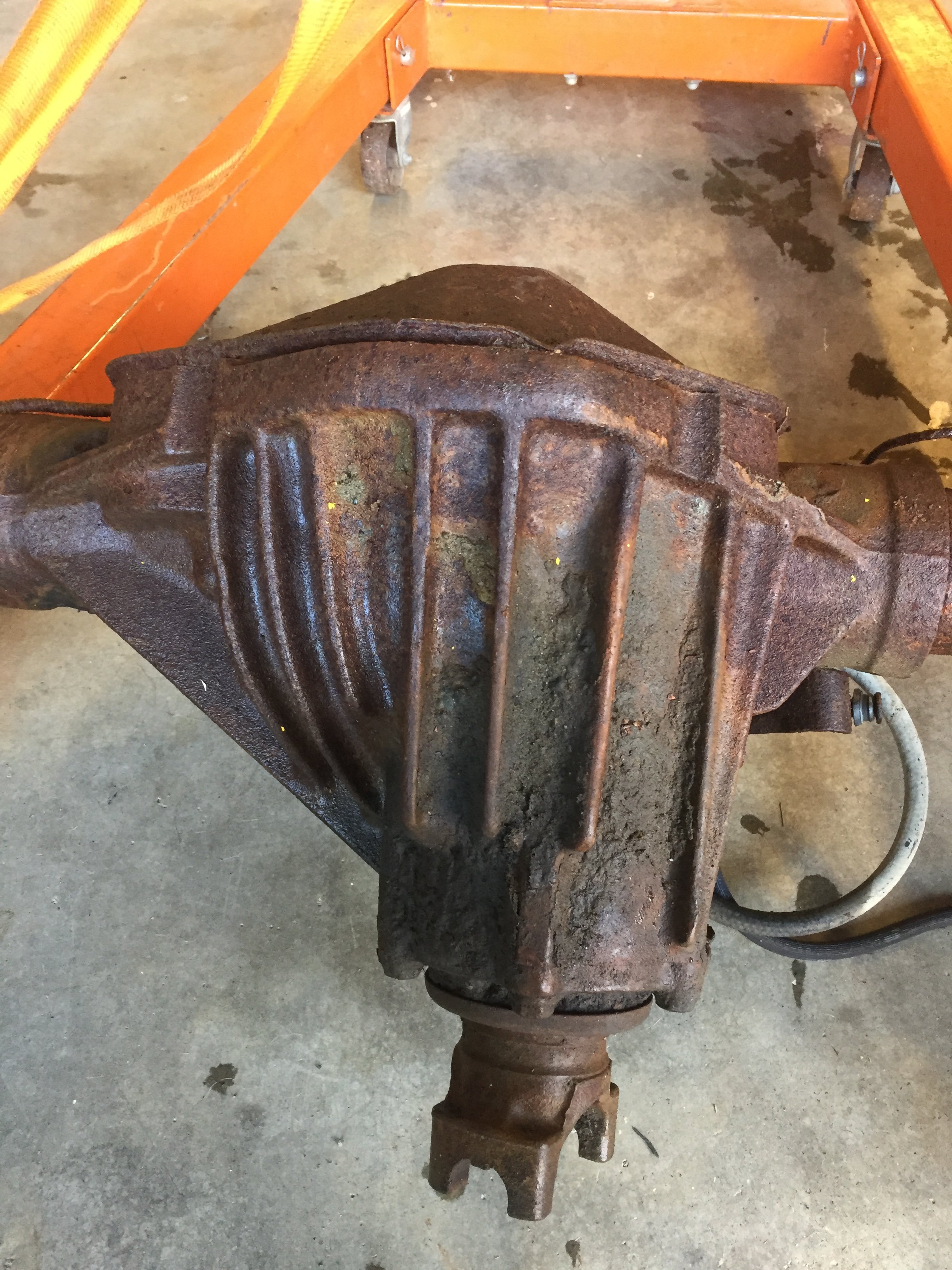

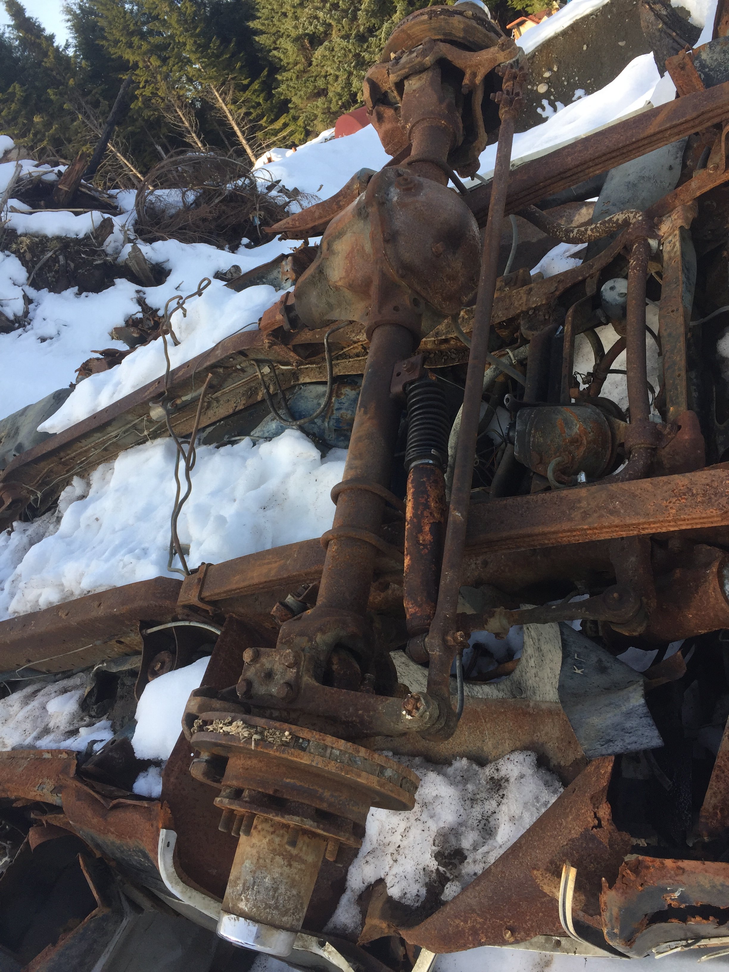

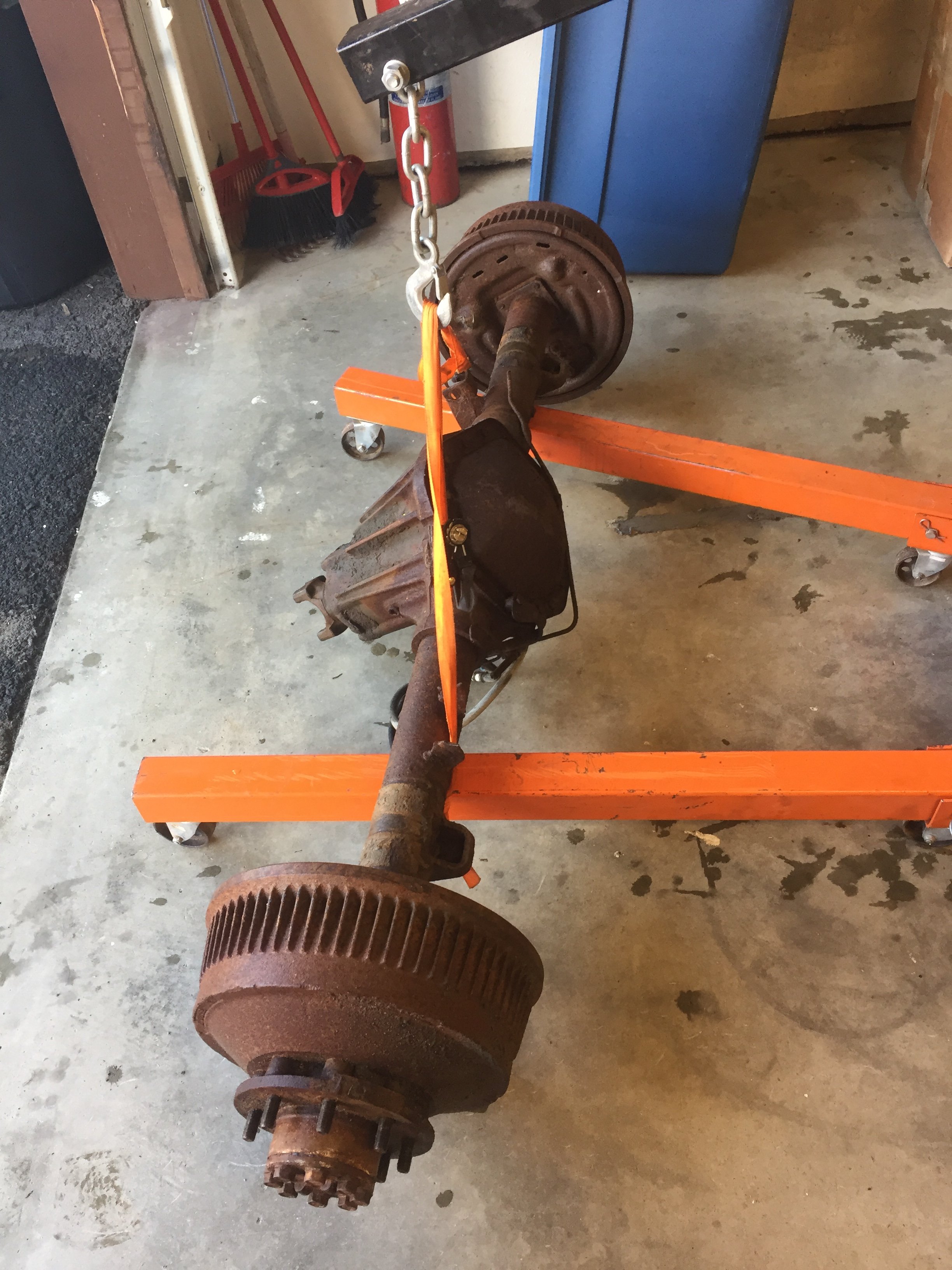

I picked up a 14 Bolt and a King Pin 60 from a K3500 truck. I know the Chevy King Pin will not work on the Exploder but it was a good deal.
Northwest fab or tmr both in Canada. One of them make a 5 bolt ranger to 6 bolt tcase conversion adapter. You could then run a passenger drop tcase and use that front 60.
Thanks for the info, I am not sure yet what route I will go with the explorer. I may have a line on a 87-91 Ford 60 I can use.
Nice find...either way, you got something that can be turned into cash for what you need.

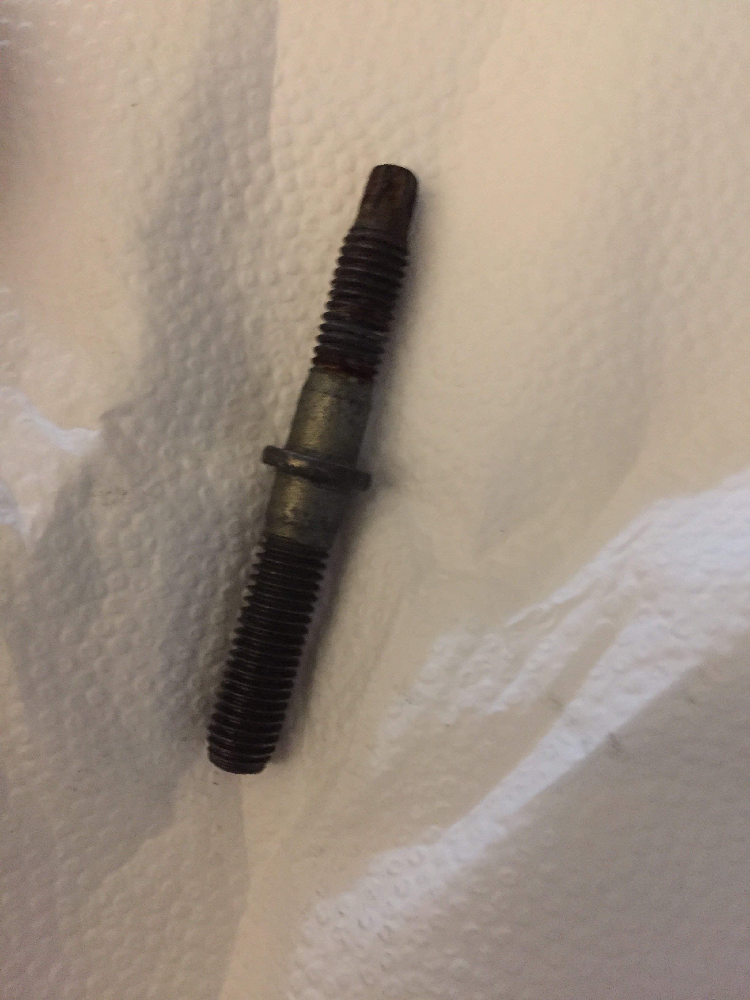

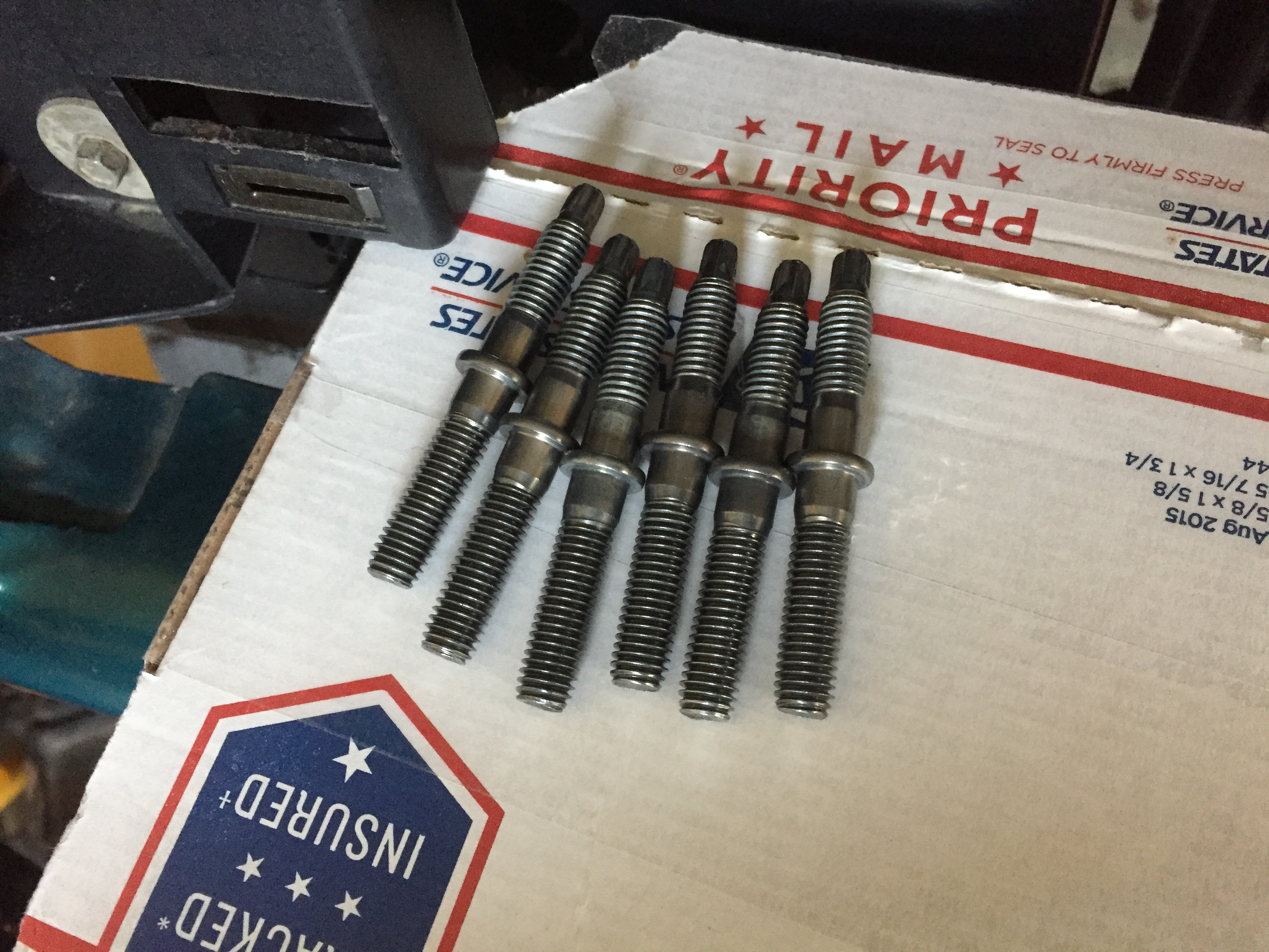

Does anyone have extra of these bolts. They are the bolts that hold the fuel rail down to the lower intake manifold. Let me know if you have any and how much please. Thank you.

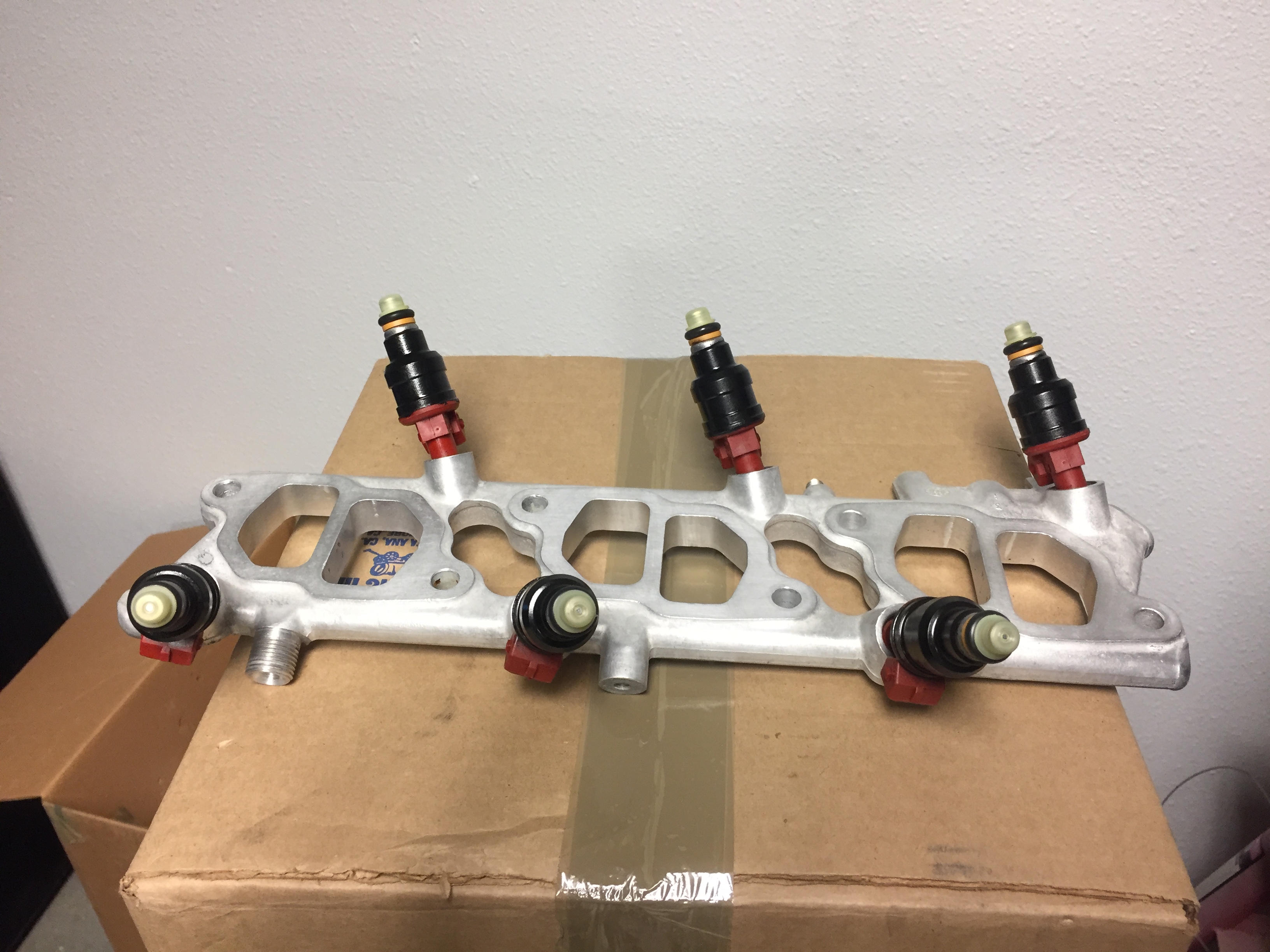

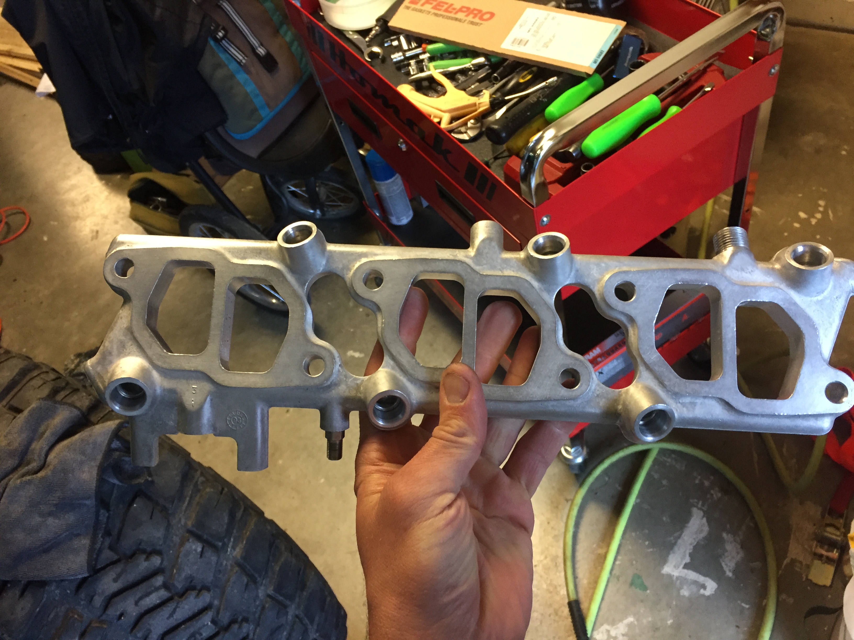

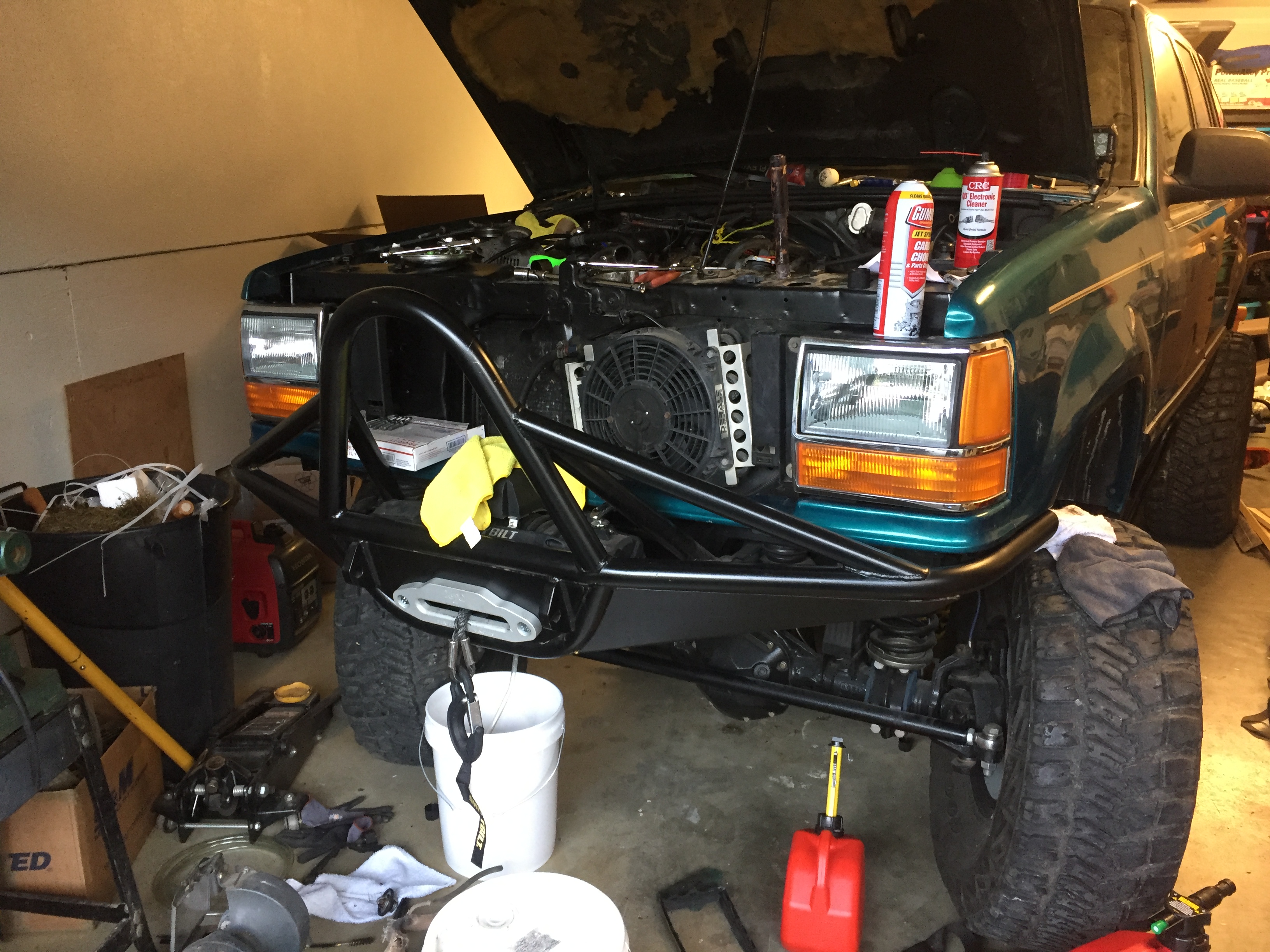

Installed some new to me rubber strips sound the heads lights and trimmed the grill a little to fit over the trans cooler better. I also decided to spruce up the engine a bit. I installed new injectors and have new plugs wires etc to install to help with the weird idle.

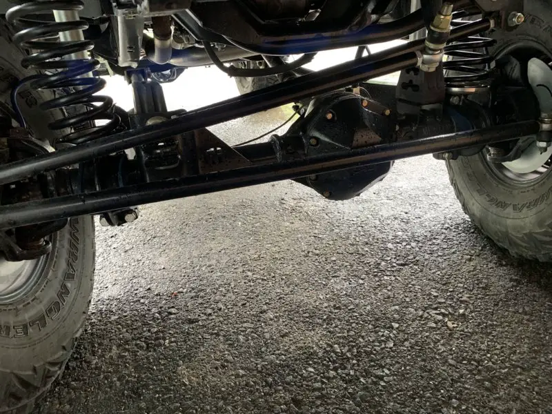

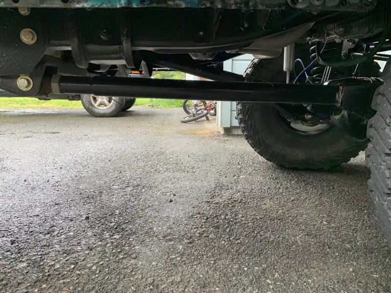

The steering was upgraded to a 7/8 heim Ruffstuff kit. I used the 7/8 to 3/4 misalignments. The 3/4 heims wore out fairly quick so I will try the 7/8 kit.
The rear spring pitches were switched out for the Ruffstuff ones to help correct my opinion angle.

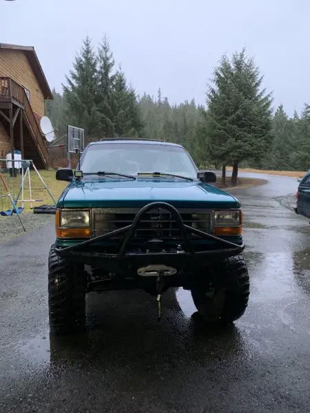

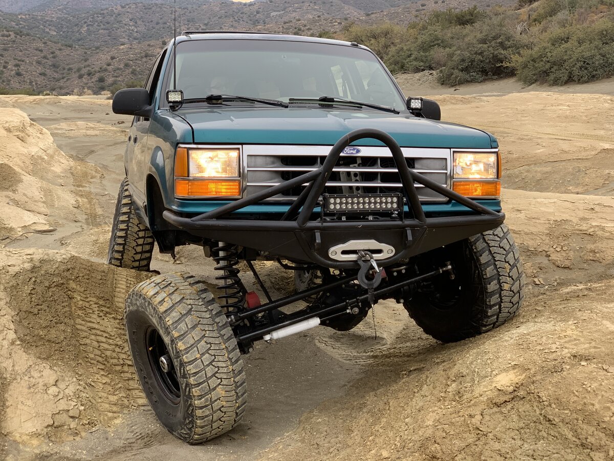

The truck eats coolant and my engine light comes on from time to time due to an EGR issue but she is a blast to drive. I will post more pictures when I get them, but here is one I recently took out at some old mine tailings. Be safe all.
