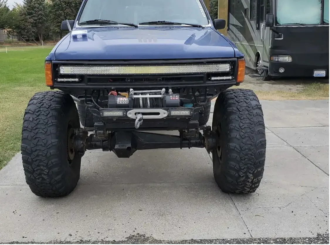

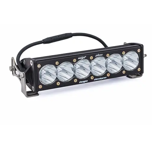

I mean, I was looking at double stacking these in the Navajo light housing....🤷
You might experience overheating issues when you block all the airflow through the radiator. I had a LED light bar on the bumper that partially blocked the grille and noticed the engine temps were higher.
Looks cool though.
You might be onto something with this. I did not think about double stacking the head lights. The lights I have now make a big difference but of course more lighting would be helpful. Thanks for the great idea.

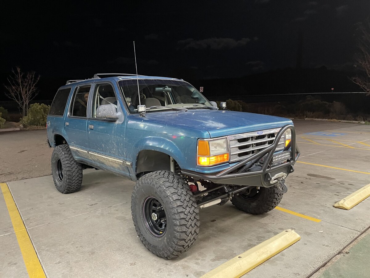

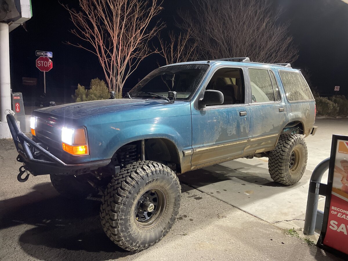

Got the new tires on the old girl today. I didn’t realize how old and out of balance my tires were until I drove her to the local circle k with the fam to get snacks. Of course we had to take the back roads home. I want to thank big brand tires for the new shoes. They were super helpful and did not care that they were going on an exploder. I will go there again for tires. I actually thought about going with the 36” tsl sx’s like FROADER had in the day but the Falken’s were easier to get. Have a good night all. 🤙
Are the Falken's true to size?
The Goodyear and BFG's were small 35's, more like 34". The Maxxis Razr's I have currently are oversized, more like a 36" and at least 2" wider at the tread than the Goodyear and BFG's. They are wearing fast, softest tire I have ever run. They do have great traction in the dirt, but at this rate I'll end up replacing then twice as fast as any other brand I have run.
So before Goodyear stopped making the MTR’s in 35x12.5r15, I believe they were the closest to a true 35” at 34.8”. The Yokohama Geolander MT G003 that I wanted are 34.6, but are on back order. The Falken Wildpeak MT’s are 34.49 with a tread depth of 21/32 which is almost the same as my old Goodyears which new were at 22/32 I believe. I did not go with the KO3’s due to the size as I think they run small as well. They are supposed to be 34.5 but only have 18/32 of tread.
The new Falkens I purchased today seem to be larger but I was used to my worn out MTR’s. One thing is that I run my tires at 18psi pretty much everywhere and these tires are very smooth riding with little noise. Time will tell but my first impression of this tire is good. Hope that helps. I will take a measurement and post it here when I get a chance. Thank you sir.

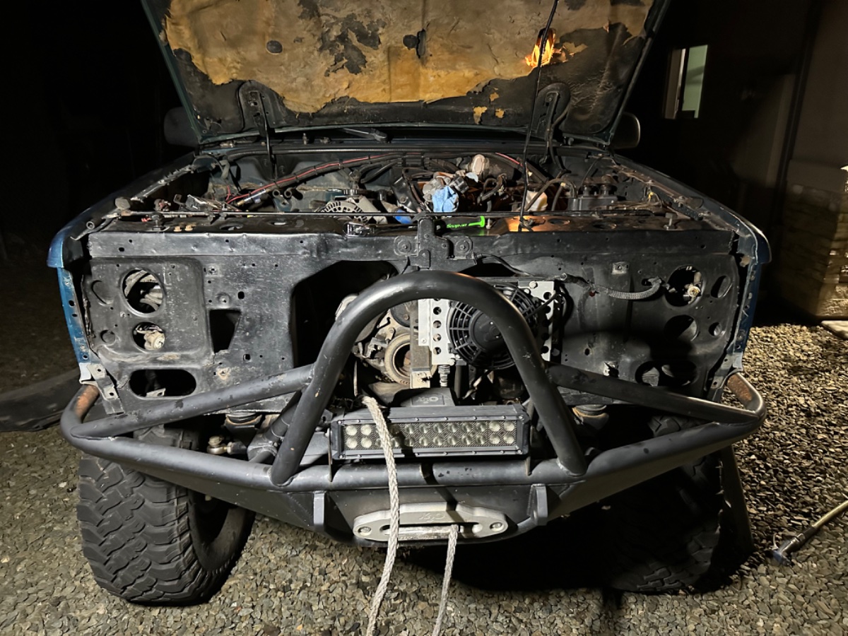

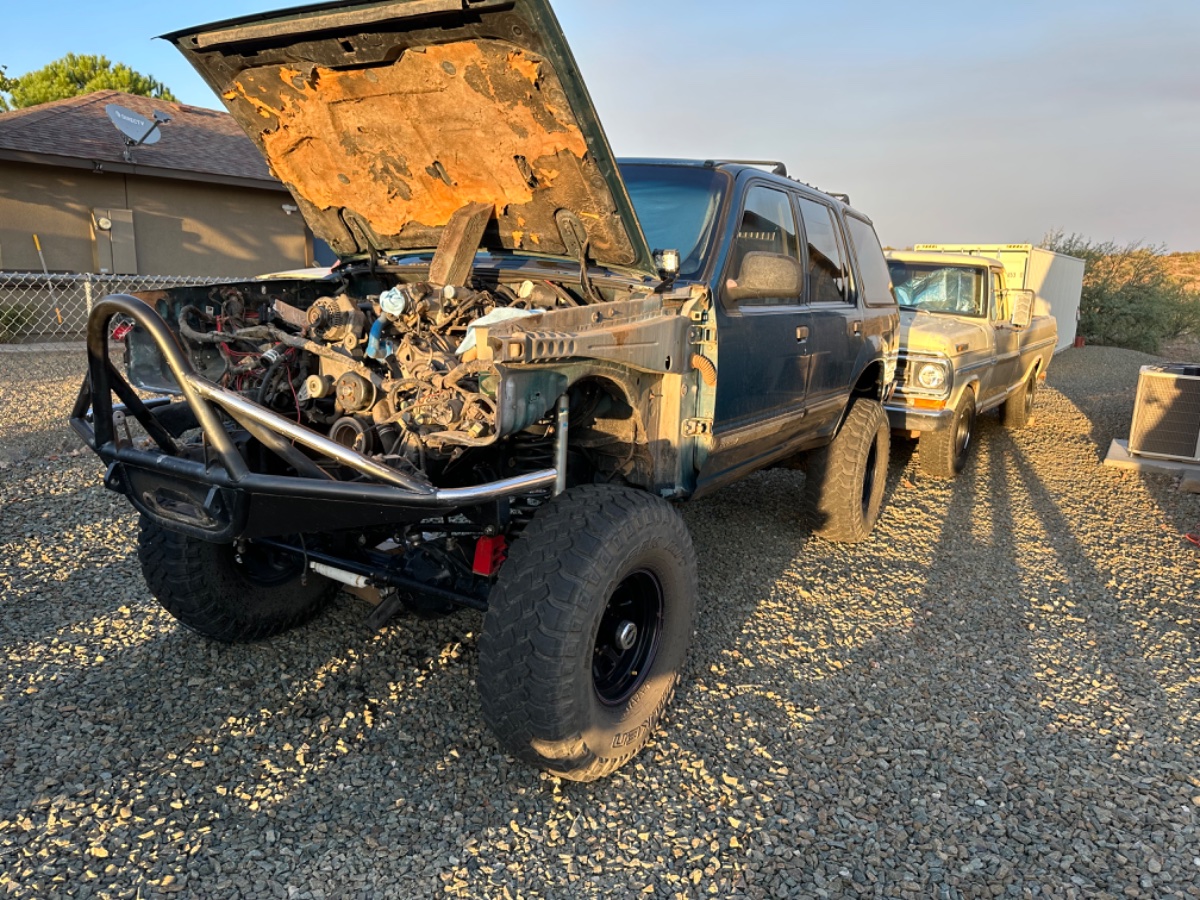

Evening, the trucks radiator went out a couple of weeks ago. When I took the radiator out I decided to make the explorer have ac again. It’s never worked the ten or so years we’ve owned her but AZ has decided that summer is 9 + months long anymore and I want to drive this thing more.

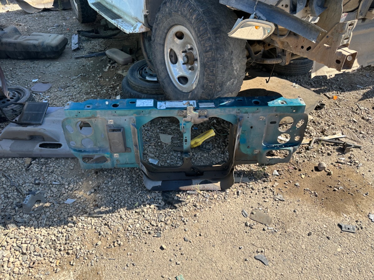

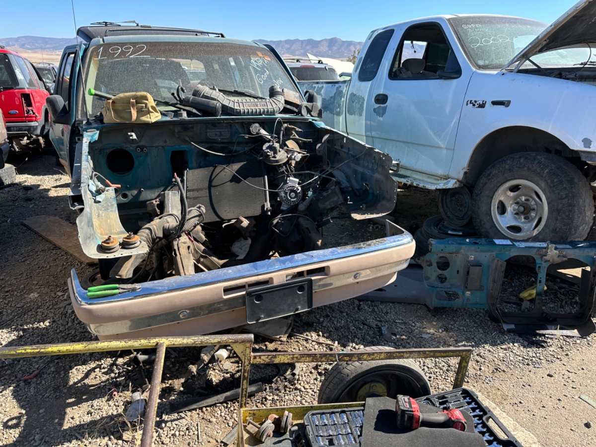

When i purchased this truck the PO told me that he had some work done to the core support and I did not realize how bad it was until last week. I decided to replace the core support from a same color ex that is in my local yard. I was able to get quite a bit of parts from the yard and it will be nice when I finish it. I’m just excited to have ac in this thing again.
