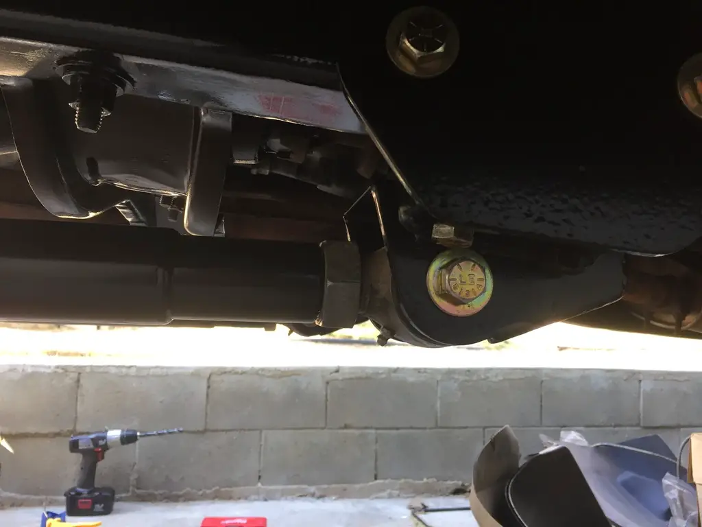

Question-
How close are your radius arm mounts to the trans crossmember? Is your front axle pushed forward any or is it mostly in the stock location?
Im seriously considering ditching my home-made arms and getting those to get my turning radius back... but my front is 3" forward and i want to keep it that way.
Question-
Good morning sir,
I am not sure if my axle is pushed forward or not because the work was done prior to us getting the explorer. It looks like the axle may be pushed forward a bit. The attached picture shows the trans crossmember and my radius arm mount. You can see that there is still room to move forward a bit. I will get better photos when I get a chance. Thanks for looking.

Question-
I have the same arms and my axle is forward 1.5", but I have a different transmission/transfer case and cross member. I measured and added another 1.5". If the radius arms were 3" forward, the front edge of the Duff RA bracket would be 16" back from the center of the first body mount bolt on the driver side. I think that would still clear the stock cross member going by the old rivet holes. 3" is a lot; my 35" tires clear the firewall, but contact the front and inside of the metal inner fenders. I also had to trim the front fender well edge to clear the tires at full stuff.

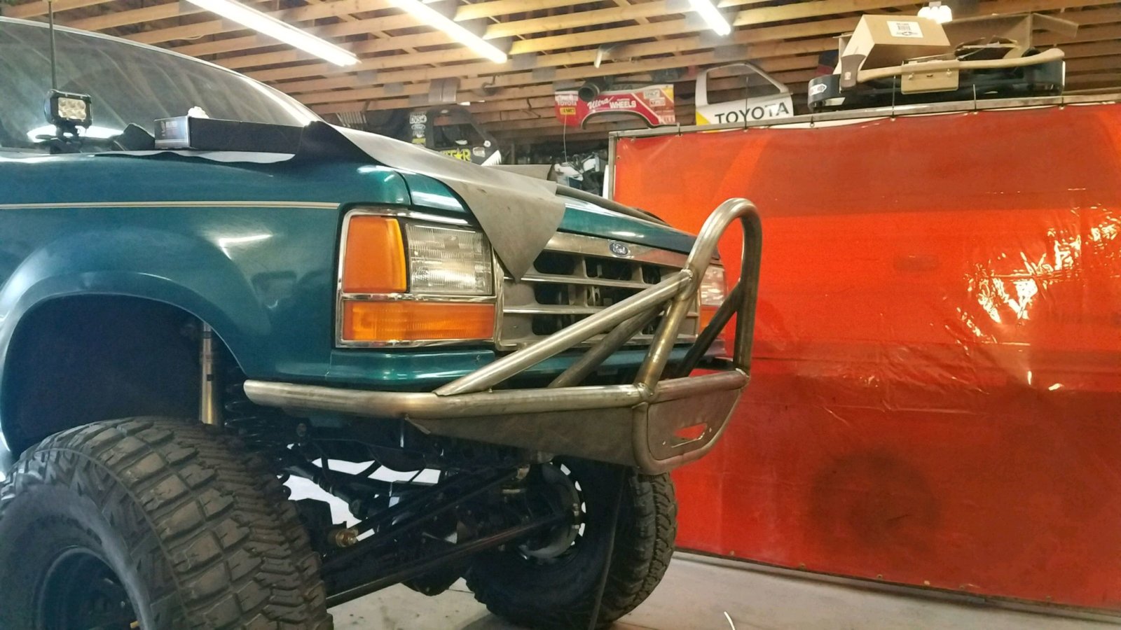

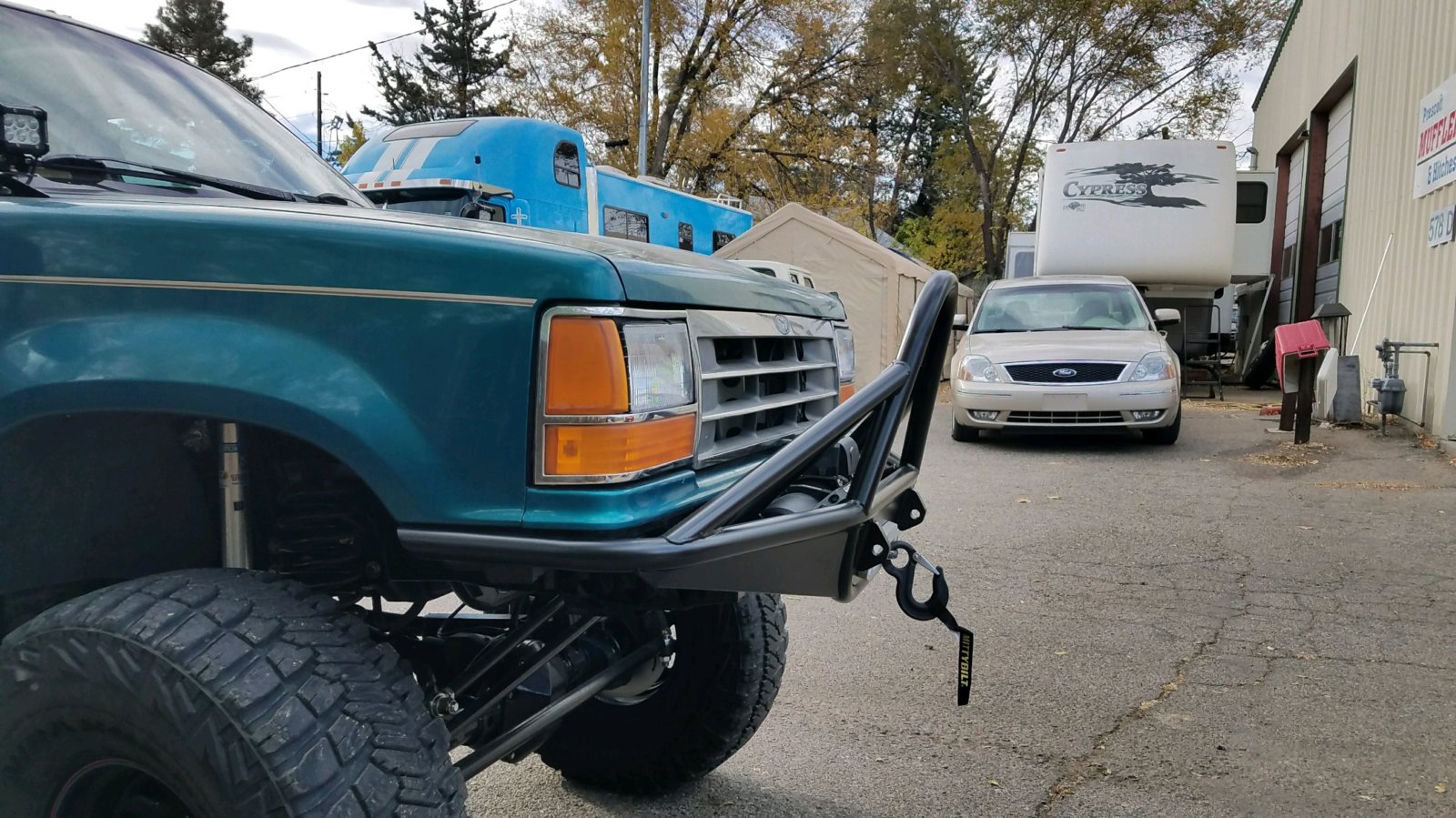

The ex was dropped off at Vigilante Motor Sports to get a front bumper built and the winch installed. I bought a smittybilt 12k X20 with the synthetic rope. will also be putting on sliders. I am having them cut the rockers out right below the door due to some rust in the rocker. I gave them an idea of what I wanted and they said the will build something cool for me. Here are some before pictures. I will post after pictures when I get a chance.
Here is the latest on the front bumper. I was not sure on what I wanted so the shop surprised me. I think it looks pretty good. They pulled the winch before I could get pictures but you get the idea. They still have to install a couple attachment points and paint it. They are also doing sliders for me.

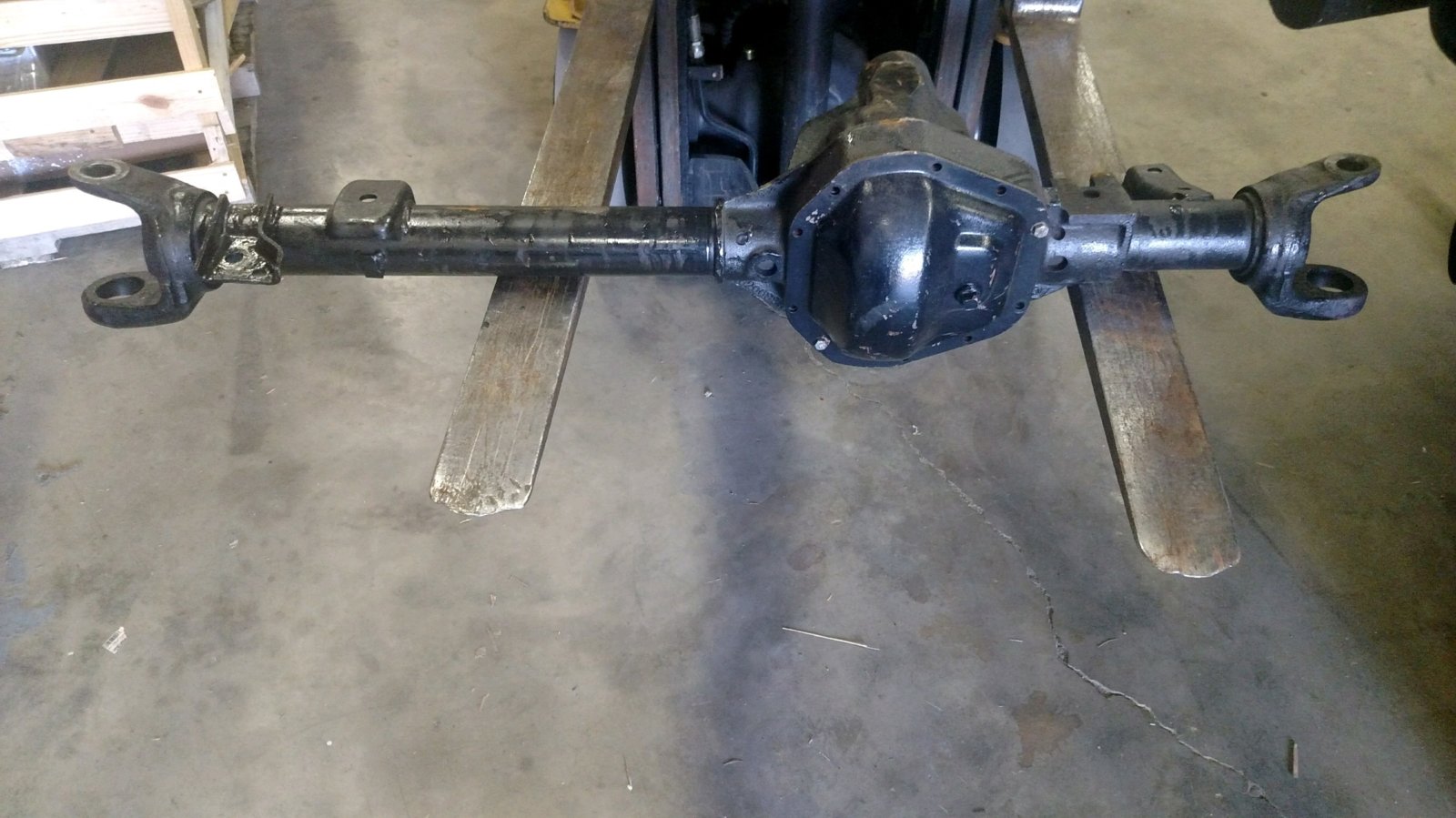

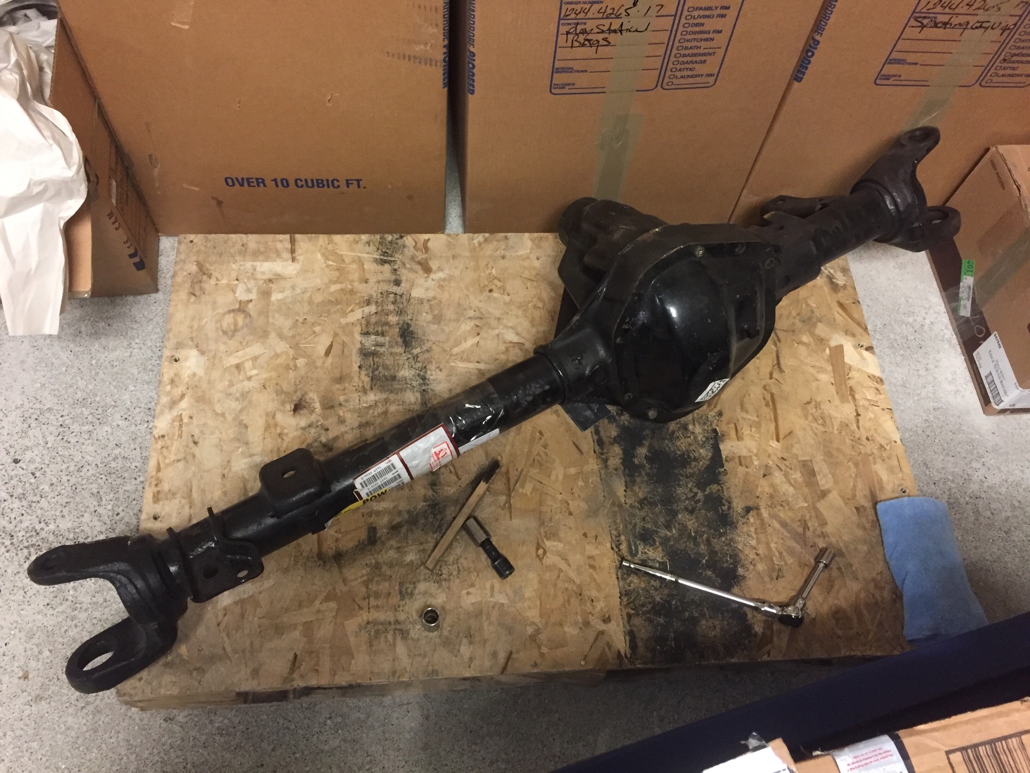

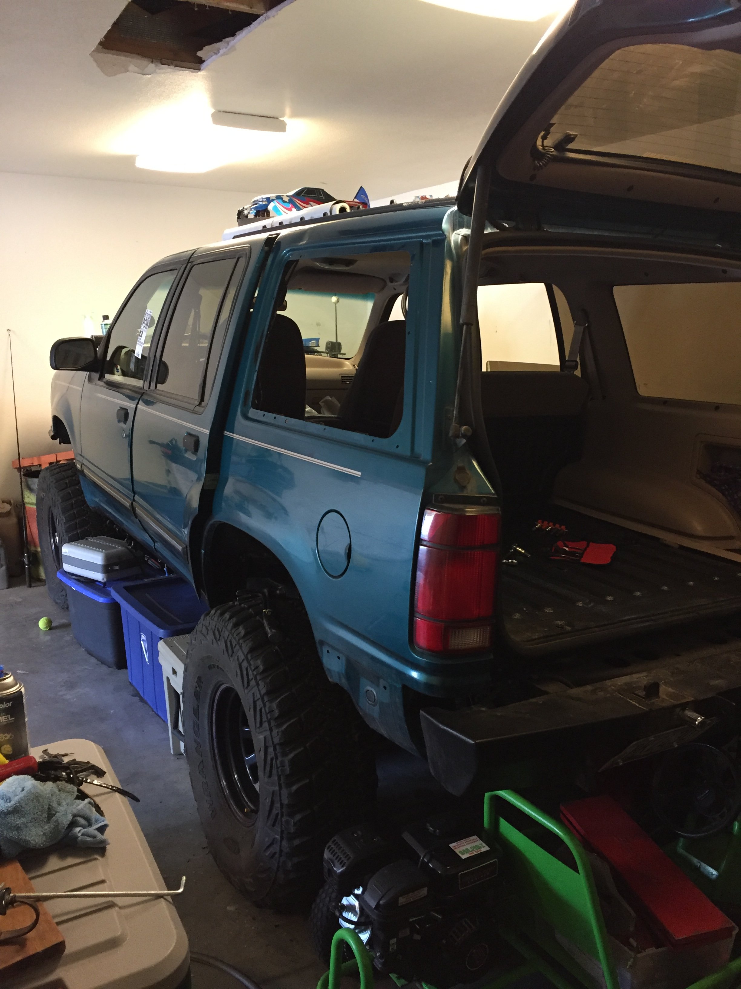

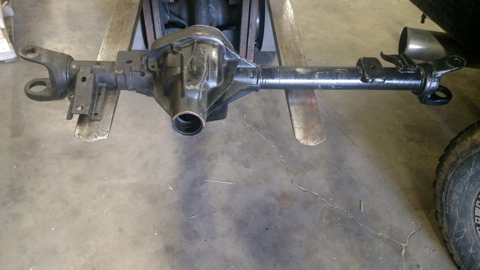

So for some updates, after over seven months of training and moving to Alaska I can finally work on the Exploder again. I found a small leak on the driver side rear window I sealed with some skylight sealant. My 78/79 Dana 60 housing showed up a little while back. I am not sure what I am going to do up front yet. I want going coil overs and radius arms or links. I found a 14 bolt at the local scrap yard so I will probably pick that up next week. I will start collecting parts for the tons and post as I go. I will go 5.38’s and Detroit lockers for sure. The last picture is from my local docks we took a stroll down this evening. Have a good evening all.
