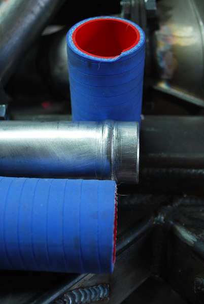

Definitely need to think of something for that lower radiator hose. With the angle its at the hose clamps aren't cutting it. I may have to do something weird here. Just went for a test drive and made it all of 10 minutes before it blew out where the metal flexi-hose attatches to the rubber adapter thingy at the radiator. Hmmm....
i would say that is a cap problem, too much pressure, , have the cap tested,, see if it is a 13 lb cap or not,,
no idea what the pressure is for the cap. Its the free Griffin one that came with the radiator.

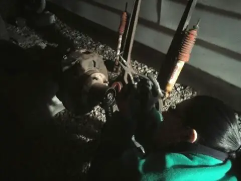

Jason let me help him work on the truck last night. Let me help with explaining why I was excited about this. There are two definitions of 'helping' between Jason and I:
~Jason - stand by and run back and forth from the truck to the garage and hand him tools.
~Tiffany - really wanting to FIX the truck but instead hearing Jason cuss and see him getting frustrating taking everything personally because I brought the wrong size of tool or the wrong tool.
Well, we both learned a lot last night because once I got my hands on Jason's tools (pun intended) I wasn't giving them back. He realized that just sitting there watching was NO FUN... and I realized that it's not me doing something wrong... it's the damn nut not loosening up!!!! :frustrate
Here are two pictures as proof!!

I can't deal with this--are you knocking off the spindles?
Yes, going to town with a hammer and cold chisel. (would have taken 3 seconds flat with and air chisel)
