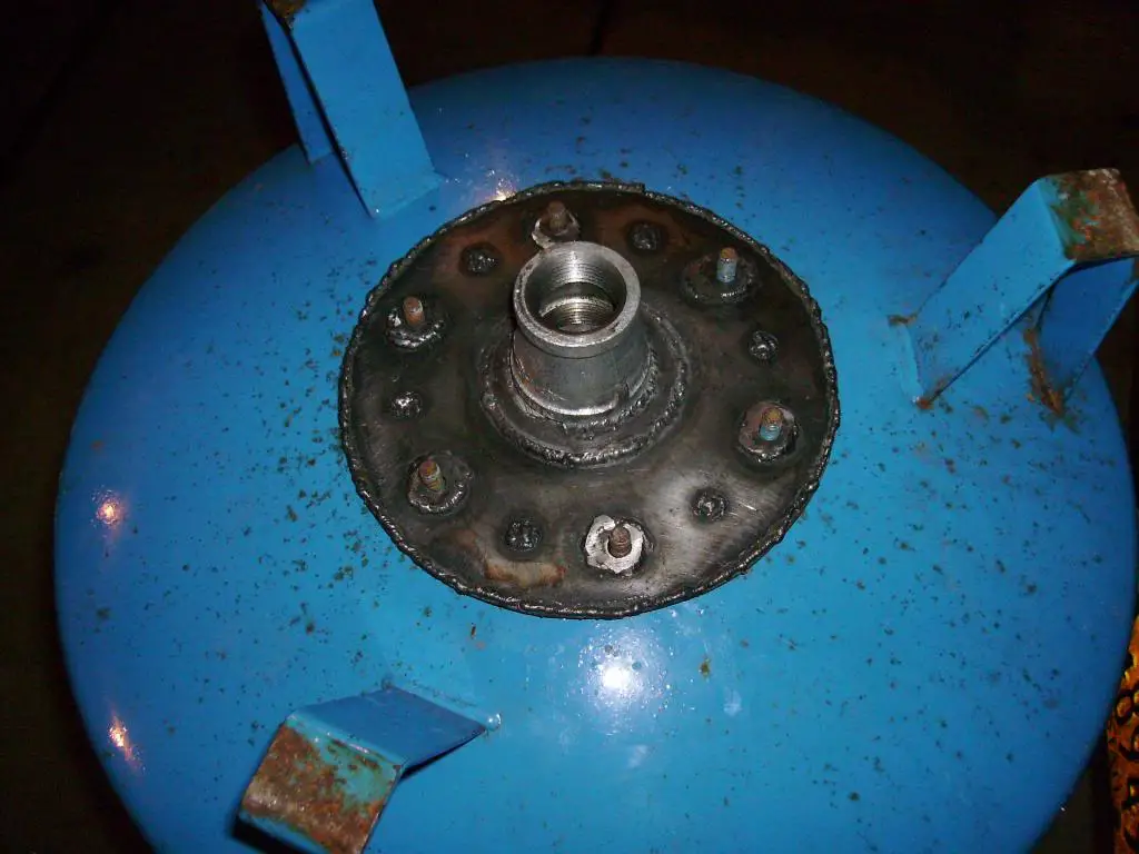

This time it’s a sand blaster… ok I was making this for another project… I got a vintage Yamaha restoration in process to… well either case it’s going to be a great tool to add to my garage. So here is that…
The Idea
The start
One of my friends grandfather donated this to my restoration project(s). Guess what it was and what it will be...

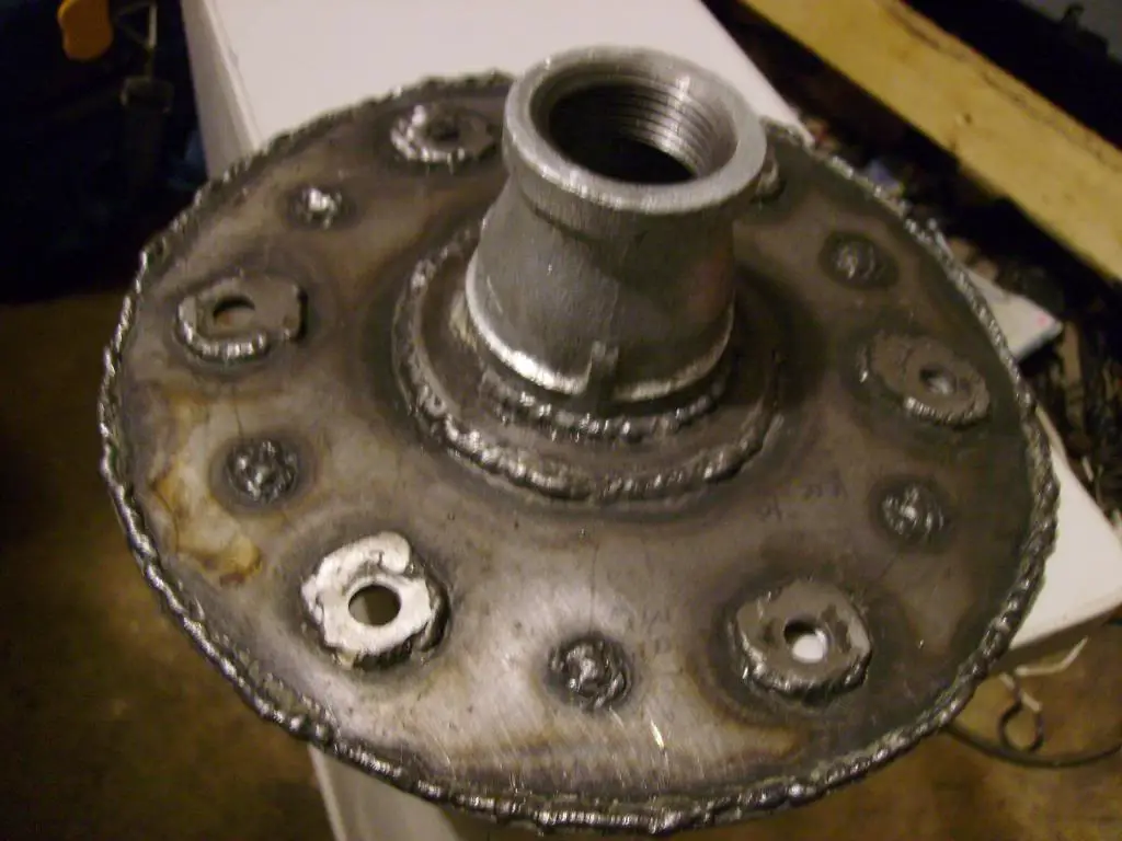

Trying to learn how to weld. This past year was the first time I have ever really welded… go figure
The bottom plate that’s has to cover a hole
The hole

Actually Giant Spud Gun, lol. Going to need the sand blaster finished tho... thing has the ford cancer pretty bad... It’s sad to say, but living in Buffalo, this vehicle is in pretty good shape... My father keeps telling to go west to pick one up to restore. I figure when I have the time and money I will, but probably something way better... belair, roadrunner, mustang or etc

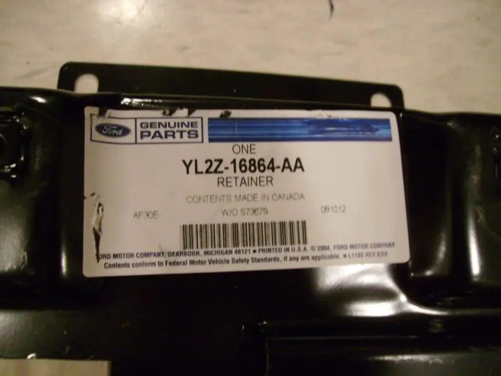

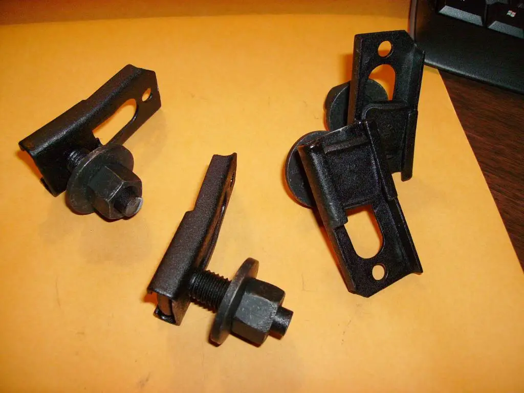

Don’t look like much, but it’s a win in my book. Bumper brackets with bolt and nut is $56.63 each from fordparts.com... the replacement nuts where $3 each from varsityfordparts. I did find them cheaper, but not by much and I actually talked to someone from varsityfordparts who helped me find what I really needed. Other sites, not even a phone number listed to call for service support. Great job on varsity's part for having such good customer service. I don’t usually support companies or advertise for them, but it’s nice to share with people when you find companies who are actually still about their customers and not bottom dollar. On another note I have hit my radiator support with the same stuff I used on the bolts… Tar like stuff, hoping it acts like really strong adhesive oil. I promise that this whole thing is going to be like this, I am going to skip over a lot of small stuff and only try to post note worthy stuff.

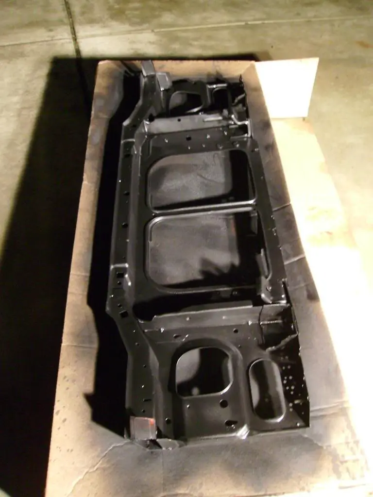

So when I woke up this morning I went out and it was pouring outside... the radiator support was soaked... I wasn't too worried, water appeared to be pooling and not sticking to the finish, but when rubbed some of the water off it instantly soaked in :eek: maybe this stuff isn’t the best water proofing undercoat I could use... Should I have used POR? But this is new and POR most likely would peel, right? Should I just use enamel with hardener in it over the top of this stuff now? Or should I try removing it with some break cleaner (lucky I didn’t do the whole thing)... decisions...
If you scuff up the factory applied finish and then do a proper grease and sediment removal prep the POR-15 should adhere to it without peeling. POR-15 is actually pretty flexible stuff, but like all paint it needs something to bite onto.

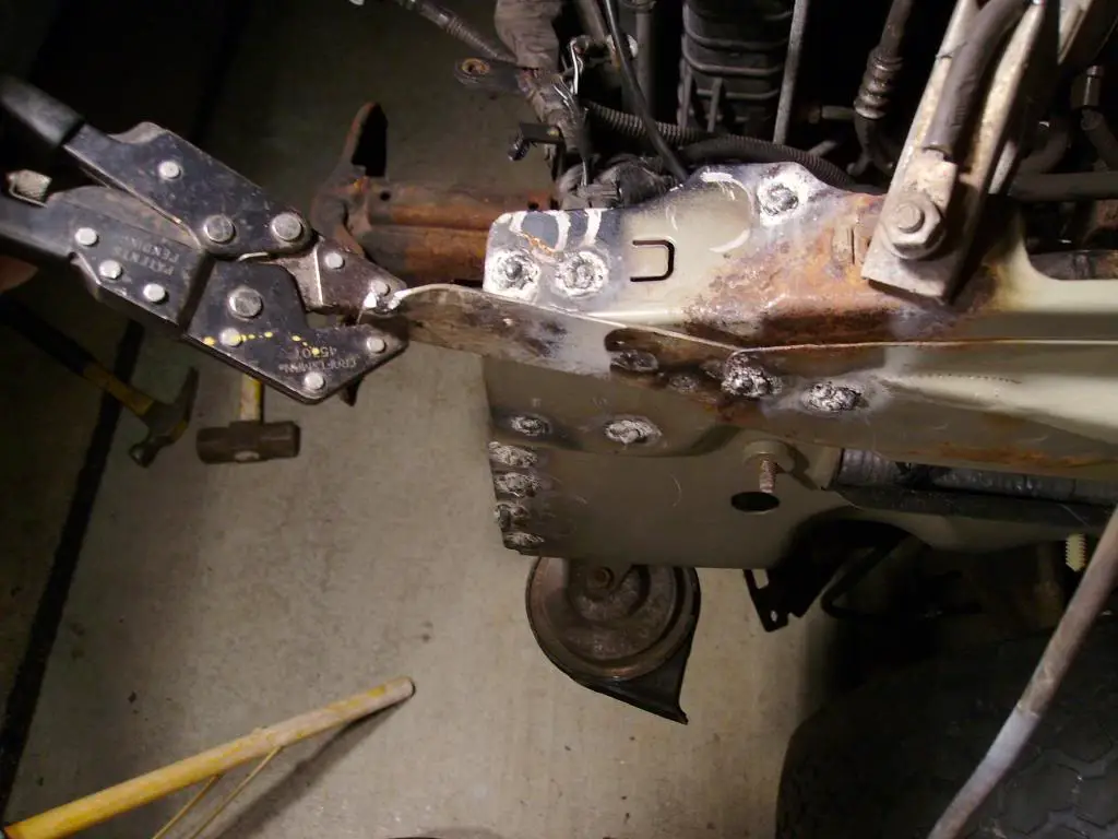

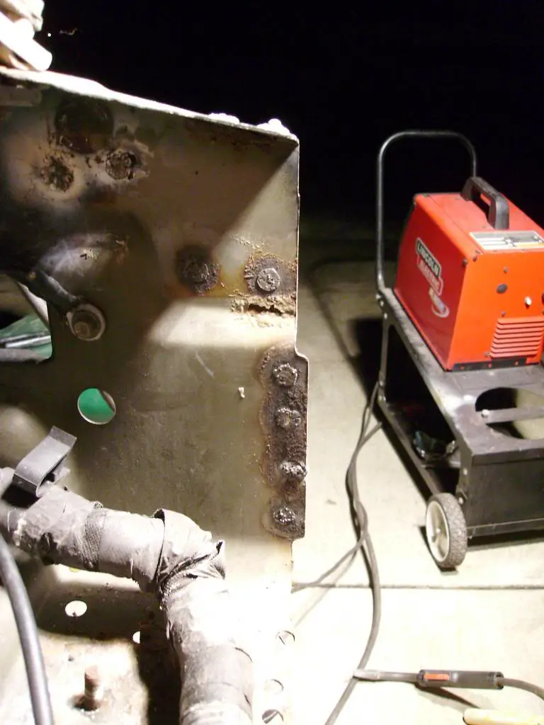

So I actually got stuff done today :)
I started filling in the holes from where I cut out the spot welds
The other side does not look so nice
I should just be able to hit those with the grinder and they should be good
And if you wondering why one side looks so nice, its cause I had it backed by a piece of non ferrous metal. You can see I was able to weld in both side here without actually weld the two pieces together
Also I worked on the sand blaster
Sorry for the blurry pictures
Oh and I decided against better judgment and continue to use the coating i was using before since one side (the damage) was already done.
Why did you fill the spot-weld holes? when i replaced the radiator support on my old ranger i welded it in place using the factory spot weld holes. How do you plan on attatching the new one now?
Foresight, for what ever reason should I ever have to come back through again? Plus this one here is for practice to something along the lines of a muscle car. Filling them verses welding with them as is, is something I considered. If I welded the support on using the holes it would be much faster and a lot less work, yes. But I like the idea of something close to orginal (in this case the size of the weld, that damn little tool is just to easy to use. If there was a bigger weld, it wouldn't be able to cut the weld and I would have to drill yet a even bigger hole). I looked around today and was going to buy a spot welder... Then I got to thinking... Thats such an expensive one task tool when it really doesn't need to be. Would take up more room in an already packed garage etc... So I am going to drill pilot hole where I want the welds to be and use my mig to spot weld it. It does spot welding (I have tried it on some practice pieces) on high enough of a setting, even without a pilot hole
