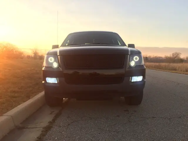

A member did a nice little write up in the 4th gen modified section with the Morimoto Mini projectors, and I decided to bite the bullet and finally build mine. Looking good so far, alot less intimidating now that ive started finally.
Painting the shrouds red, and the reflector bowl in the headlight flat black. In the future I plan on running flat black wheels, or maybe a combo like my Edge had, which was a flat black, and gloss black wheel, and then I plan on painting my calipers red, so itll be a nice contrast. Also running white halos on the front of the shrouds.
Cant wait to see it done! TONS of pics when im done!

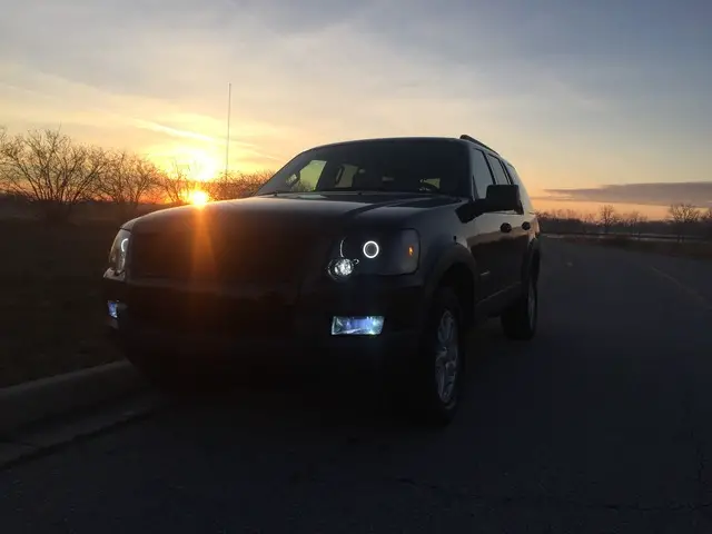

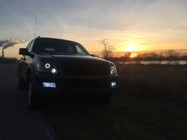

Finished the headlights, and finally got to the carwash for the first time in quite a while. (I wouldnt count the time over Christmas when it caused my X to keep stalling, wasnt even a half-assed wash lol)
God, she looks good! Ran across the street to Sterling State Park to snap a few pictures with the nice sunset we had. Nice change of weather today over all the cloudy gloom we've had for the past month.

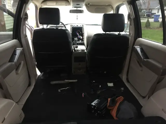

I decided it was best to ditch the third row. I will NEVER use it, plus it was just extra weight. Those seats were heavy as hell, about the same weight as my box and amp, so its kind of a nice trade-off. Also was able to remove the 3rd row seat belts so they wouldnt rattle around or be in the way. Gonna build a plywood false floor and carpet it with black carpet like speaker boxes have. Batter(y/ies) will be mounted on the left side, I would like the amps on the same side, but im not sure yet.
During this process, I also decided why not swap interiors since I hate tan and cloth. Ordered new black carpet from Stock interiors, without the mass backing because I will be applying Fatmat all over as I go. (Used Fatmat in my 2000, and it was night and day. Dynamat is a rip off, paying for the name).
I found two front power black leather seats from a junkyard by work, already pulled. They want $125 each, but one has a small small rip and the employee said he knows the guy would take less. Gotta figure out how to wire the passenger seat, since my passenger seat is manual.
Also will be ordering the 07 style door panels with the pull handle in the arm rest. I will get black as well, because I eventually will replace all the panels, but have some tan accents so my dashboard and console wont look odd.

Carpet came yesterday, boy thats gonna be a project just trimming it to fit, lol. (Its molded for my Explorer, but has excess on the ends, and no holes cut)

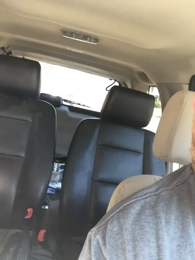

Picked up a set of black leather front seats too, super excited about that! My Explorer currently has a power driver seat, manual recline and passenger is completely manual. These seats are power, heat AND memory. Drivers seat is full power (reclining).
Passenger seat is very easy to wire up, same harness but needs a power and ground. Drivers has me stumped at the moment, but ill figure it out eventually.
After a LONG weekend of struggling with wiring diagrams and frustration, the seats are in!
New carpet as well from stockinteriors.com.
Black carpet, with black power seats, drivers is a 10 way now, passenger is now power, both are heated but thats not wired up yet. Such a HUGE upgrade. These seats aren't in the best condition, but I got one hell of a deal vs what I priced out on eBay, and its so much better than dirty cloth!

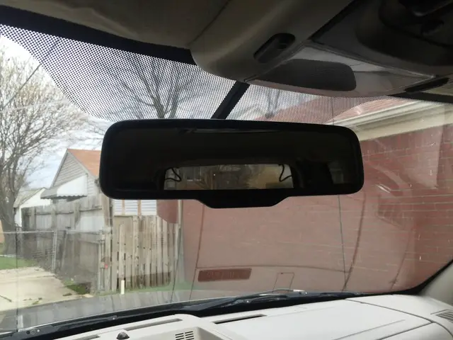

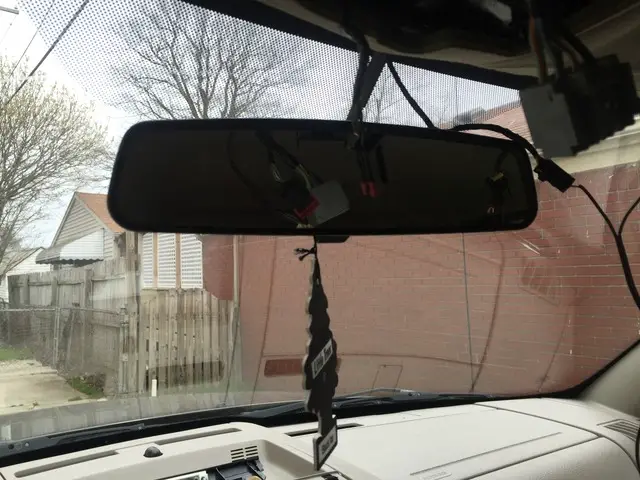

So I was sick of my ugly, bad stock rear view mirror and decided it was time to figure out the wiring and order an OEM auto-dimming rear view.
Had a third gen mirror in my cart on eBay for like $35, with part of the pigtail, and ended up coming across a 4th gen mirror for under $30. Seller told me it did NOT have any of the harness which was a bummer, but I found one for $16 with about 12" of wiring. Ordered both, mirror got here the next day (Came from my state) and behold, there is wiring with it. I was mad. Hopefully the seller will let me return the harness I bought.
Oh well, but I got it installed easily, tapped into the compass modules wiring, but did it over in the A-Pillar. Tied the wiring into the loom that already ran down, and it looks OEM as can be! I opted to not wire the reverse circuit (12v when in reverse) which just disables the dimming feature while your car is in reverse. I rarely use that mirror when backing up anyways.
So much better! And it looks better as well.
Cheap, crappy, wimpy looking stock mirror: (Wiring was hanging down as I already started the project)

Wouldn't ever know it wasnt stock:

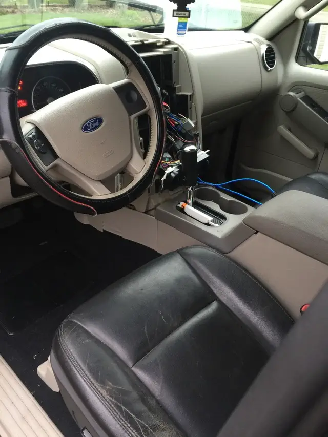

So a little backstory before my next story: I noticed some aftermarket wiring under my drivers footwell area which looked identical to maybe a lower end remote start or alarm. I assumed it was just removed, or something because I didnt see any modules down there, never really looked into it.
So I was ordering LEDs for my gauges, climate controls, and rear climate controls. Was going to check the bulbs in my vanitys, but I NEVER use them, so that'll come at a later date. While I was out there double checking my bulb count, (I still have my center bezel off, working on fitting the EQ into it), I see these two dim LED lights way back in the center flashing.
Reach behind it from under the steering wheel and grab what I think to be what was flashing (it was) and it was this little box module tied into those wires I mentioned above. The module it probably 2.5" by 2" and maybe an inch tall. Clearly not anything related to remote starting or alarms.
I unplugged it and brought it inside to do some googling, its a GPS tracking device with remote ignition disabling available. Only available for sale to companies it seems like. Im going out on a limb and assuming its the dealer I bought it from, in case you don't pay your note. Upon some more digging, I found mine is only wired for power so theres no ignition disabling but what an odd find!
