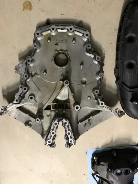

I removed the front cover and am amazed at how well the Bg 109 worked. Here is a picture.
Next weekend, I will replace the phasers and put it back together.

It cleaned the sludge from the front cover. Visual comparison when I had the front cover off prior.
